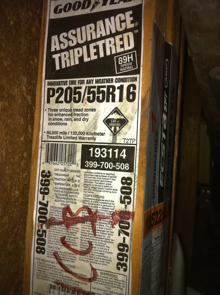

After almost three years and 40K miles of darksiding on a Goodyear Triple Tread I was forced to buy a different brand tire.  I wanted the Dyna Beads out of my tire so I could use Ride-On but with three plugs in the tire no shop would touch it except to mount a new tire.  I made a trip to Discount Tire to get a replacement and the GY TT is no longer stocked by them, BTW, if you’re a die-hard fan of the TT you’d better get one now because the guy at Discount said they don’t sell them anymore except by special order and I was unable to find one anywhere around the Allen area, they may not be around for much longer.  So I inquired, ”what symmetrical tread pattern do you have in a 205.60.16”?  The Falken Ziex ZE-512 was the only one in stock and was very affordable at $85 with tax.
Falken
GY A TT
What a good decision it was to buy this tire.  At 40 PSI it handles and corners much better than the TT.  I noticed immediately, I.E. turning out of the driveway, that this tire leaned with ease.  I headed to the only curvy roads near my house and was grinning at the ease which this tire handled curves and corners.  The biggest differences are the curved profile compared to the flat profile of the TT and the shoulders are rounder compared to the square shoulders of the TT.
I will never go back to a motorcycle tire or a Goodyear Triple Tread again.  I can’t vouch for reliability yet but I’ll look at other brands before I’d settle for another TT.  YMMV
PS.  With no balancing done on the tire it was smooth as silk up to 93 MPH with 16 ounces of Ride-On in it.

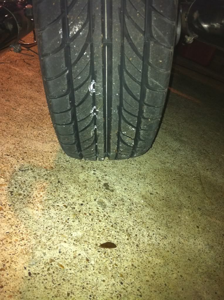

Just got off the phone with Lunsford Honda who is fixing up the IS after the crash.  They said that the GY TT had a gash in-line with the tread and said it looked like it was ready to delaminate.  It has 19,000 miles on it.  I will take them my spare wheel with the MT on it to get the bike home.
BUT, I need to find another CT for the Valk.
I have a Kuhmo 195/55/16 Run Flat on the Wing and it is just like Houdini describes this Falken.  So much like a MT it isn't funny.
EDDIT
Sorry, forgot the pic....
/EDDIT
Hmmm... this Falken I will have to ponder!

I started off with a 205/55 GY TT and it rubbed on the fender bolt.  I reversed the bolt and shaved the head off of it and it still rubbed.  I switched to the 205/60 GY TT and all was good in the world.  Until I was getting ready to pick up the fat girl from the shop and they showed me a split in the tire.  I have about 25k on it I think, so it was probably time.
I came home, read this post from Houdini, and ordered the 205/65.  I will let you know how it fits.

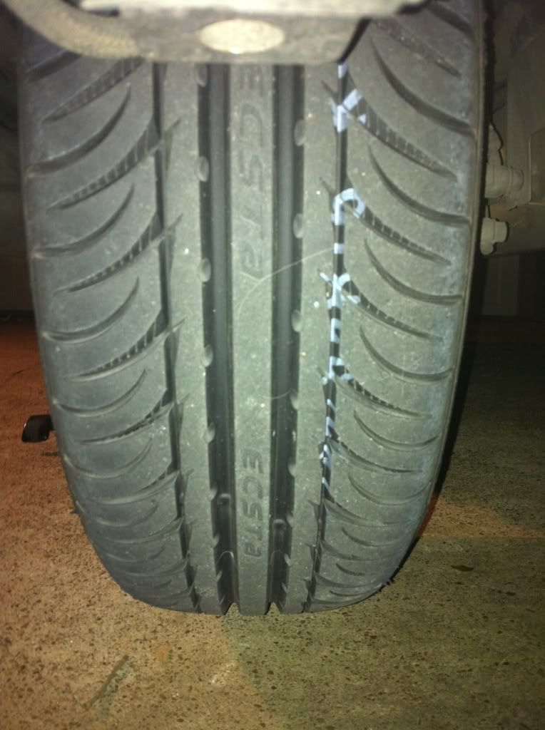

That's a crazy looking flaw!   Shocked   Glad they caught it.   cooldude
I have an idea about what may have caused it, but wonder what others might suggest the explanation is.

Well, one thing could be that it sat on the side stand for almost 3 months.  It IS on the left side.
What is your guess?

An initial puncture or tear spread by hard and fast twisties?  Undecided
What is your guess?
Hay Cool
My Toyo Proxes developed a bulge anomoly along approximately the same line at about 19k miles.
Odd coincidence.
What is your guess?
I guess that these car tires are not engineered to lean the way we make them do and if there is any flaw or weakness in the tire we will expose it.
I can hardly wait to get out and abuse mine some more.  cooldude

http://www.discounttiredirect.com/direct/tires/goodyear/size/viewProductDetail.do?pc=30669
This is the "new" version it seems.  Note the AS at the end.  Pretty sure I got my original TT for $128.

Well, I just got my Falken 105/65/16 mounted and I rode it about 20 miles.  I am going to like it. It seems to have a pretty rounded profile.  I did have to trim the head off of the fender bolt, because it was rubbing the tire sidewall.
With the shocks off I lowered the bike down to check the clearance.
I took it for a test ride with no air in the shocks to see if it would rub with the tire way up in the fender.  It didnt rub.  I out air in the shocks and it rode like a dream.
I'm back in the saddle on the dark side!!
Here's a couple of pics of the profile of this tire.
