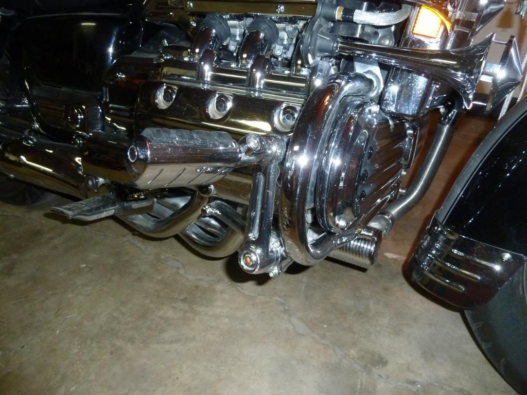

I had done a lot of research trying to figure out what highway pegs would work, so I thought I would share my findings after mounting a set of Kuryakyn 4050 highways pegs. (I have a tourer)
Instead of mounting them on the front of the 1" bar and having them point towards the driver, I mounted them on the 1" bar that angles in and have them pointing towards the front of the bike.
My goals was to have keep the pegs tucked in and not so wide.
The mounting clamp has an angled mount to it and is reversible. Depending on which way you mount it, you can either increase or decrease the angle of the pegs. I mounted mine so that it reduced the angle of the 1" bar and brought the pegs back closer to the bike.
The final angle of the pegs exactly matches the natural angle of my feet.
I have a 29.5" inseam. I used the shorter 4.5" arm extensions that you have to order separately. I mounted the pegs as close to me as possible and they came out about as near perfect as I could get. The right side of the bike is the limiting factor to how far back you can go.
I can easily rest my feet on the pegs without slipping off or I can completely straighten my legs and hang my heel over the top of the pegs.
To make sure both pegs were mounted in the same position, I measured from the tip of driver peg to the tip of the highway peg. The distance came out to 13.5".
I did not use the bracket with the rubber pad that rests against the valve covers.
You do need a large 3/8" allen wrench to mount the pegs. There were many extra pieces in the box that were not need. (perhaps they are required for the Goldwing and/or other footpeg options.)
Also, I used a dremel grinding wheel to smooth out the inside of the mounting brackets, which had some very sharp points left over on the casting. Then I used a small amount of double sided carpet tape inside the mount to help protect the chrome.

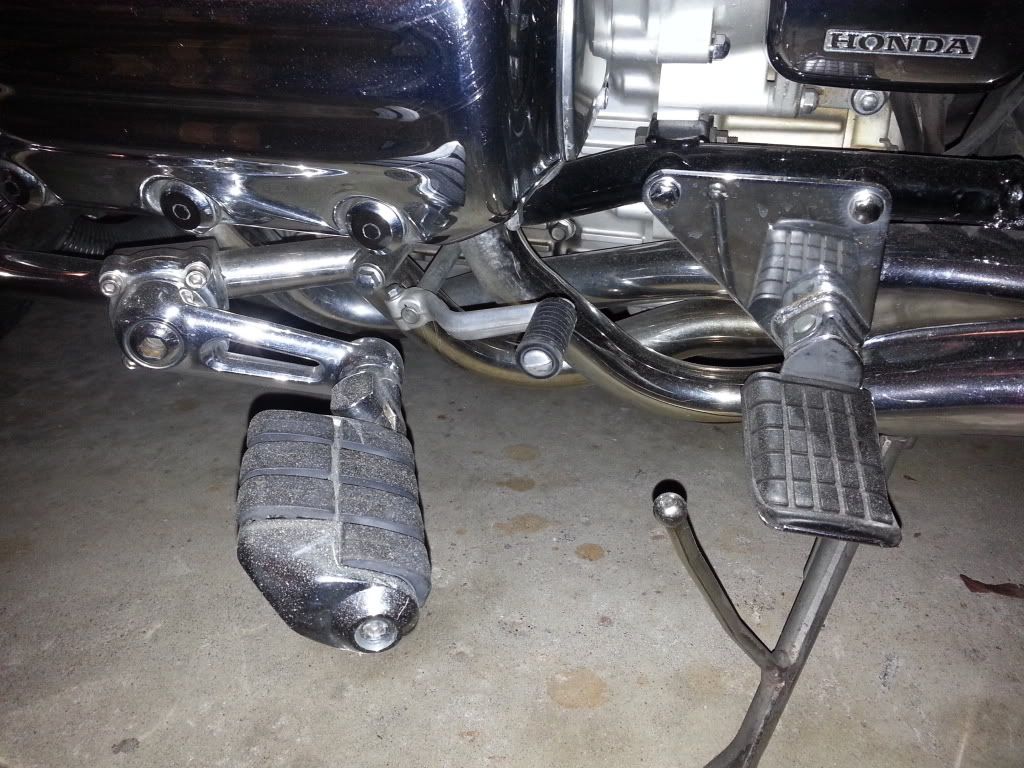

« Reply #5 on: March 21, 2014, 07:24:10 AM »
For my original posting, I think I stayed with that setup for about 6 months.
I then repositioned to this setup: (ignore the saw dust on the pegs)
This setup lets me rest my heels on the normal footpegs and the front of my foot on the highway pegs, which to me is best position overall, I can ride in that position all day.
Or I can put my feet on the highway pegs, which I almost never do.
Or I can rest the back of my boot on the front of the highway peg with my legs stretched out, which is a must every once in a while.
In this position, the highway pegs hit first in the hard corners, but they fold up so no big deal. Sort of an early warning system for going into a corner really hard.
