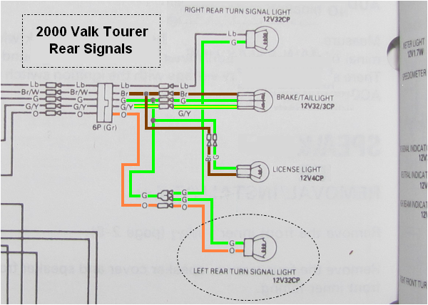

this is an error, a common one even. Strip wires (tracers) are for front running lights instead. Blinkers wires are solids. An easier way to remember this is to reference off the rear turn signals' color code which only have a blinking mode (graphic below).

Yeah, I found that out regarding the solid blue & orange. I tested the wires before I spliced into them. Thanks for the heads up.
