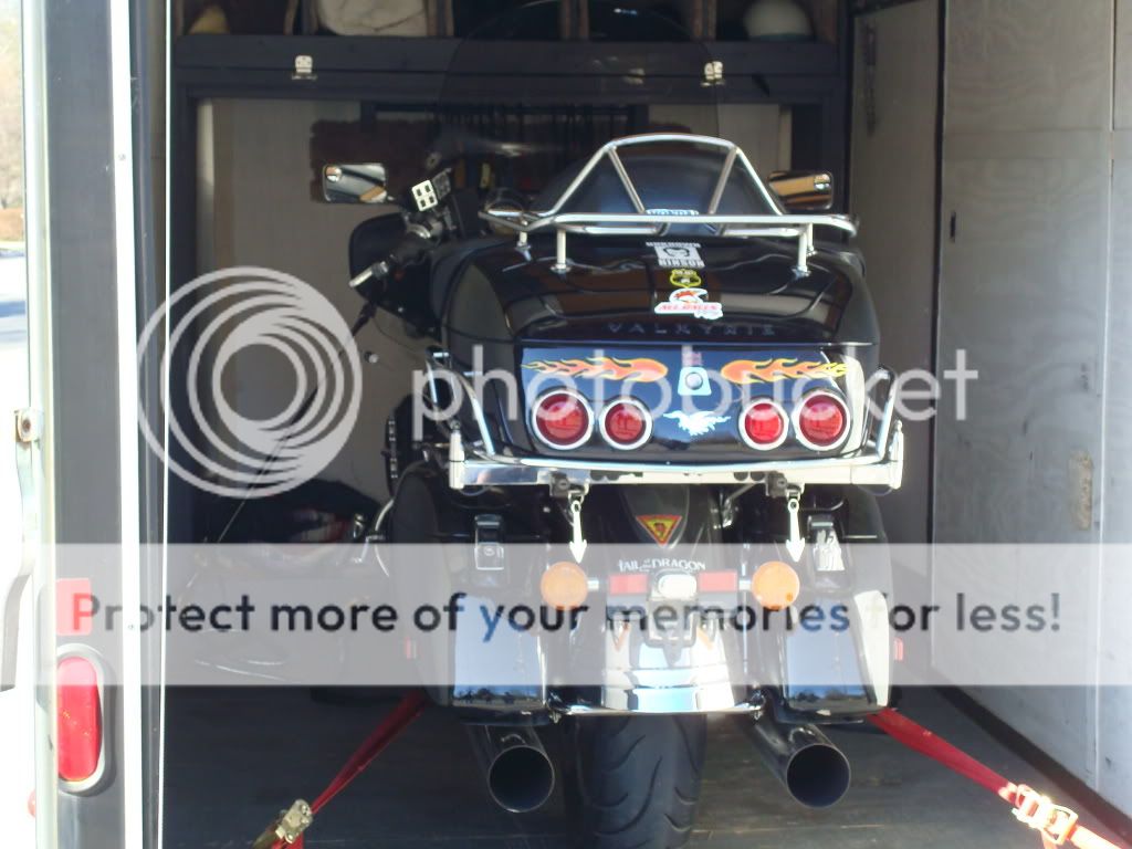

When I brought my valk home from TN I used a canyon dancer bar harness (even though everyone here says it's a bad idea).  Been hauling bikes that way for over 10 years and haven't had a problem yet....other than a twisted grip or two (still not a big deal).  Of course I turned the fuel off before we pulled out the driveway and headed back home after reading about a hydrolock here.
Had the canyon dancer on the bars and 2 straps wrapped around the crash guards up front and in the back straps around the bag guards.  The bike traveled 7 1/2 hours and just about 400 miles and never moved an inch in the wheel chock.
