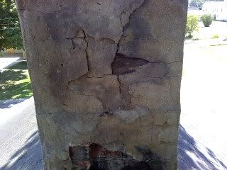

Buda
Posts: 394
Buda IL
« Reply #22 on: July 06, 2012, 08:59:38 PM »
Chimney project starts on monday....wish me luck  Cheesy

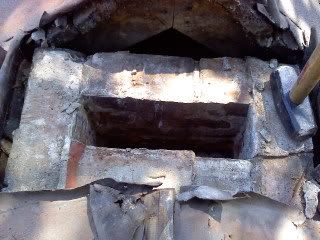

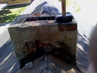

Buda
Posts: 394
Buda IL
« Reply #24 on: July 09, 2012, 10:38:43 AM »
Gone a bit farther but its lunch time now.....back to it
