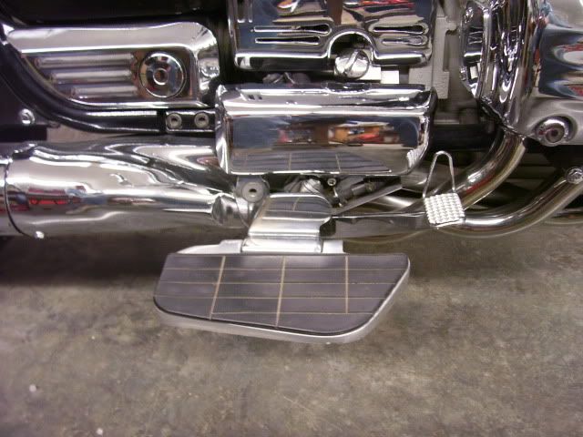

My bike came with the MC floorboards and shifter. I couldn't get the hang of the heel toe shifting, so I took the shifter part off. I like the floorboards, but had a difficult time using the stock shifter because of the length of the floorboards. If I adjusted it high enough to get under it  then there was not enough room above it to the motor.  The floorboards also have a little bit of adjustment up and down or a little tilt, but not enough to make it work. I bought the CBX shifter suggested on here and it helped, but I didn't like how that shifter was back about an inch closer to your foot and had a longer travel because of the added length. So now I bent the stock shifter as some others have done and like it the best so far. I can take a couple pics later today. I think I have a pic or two of the shifter mod........
This is the only one I can find right now. Just a pic of the CBX.  I'll get a couple more later.

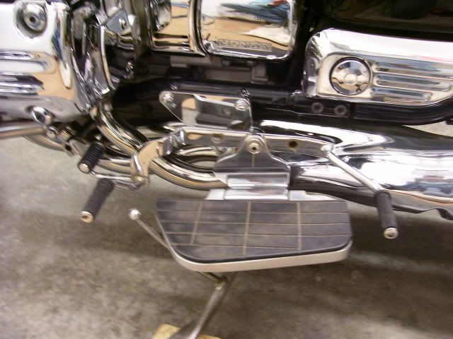

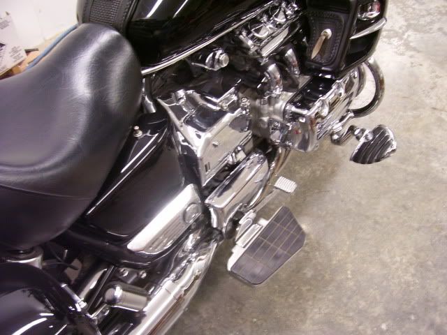

Ok here are a few more.  I stuck the heel toe part back on in a few of these, but it is obviously not hooked up to the shifter since they no longer line up. Another reason I didn't like the heel toe.... You can't move your foot around. It feels like it's trapped in there.

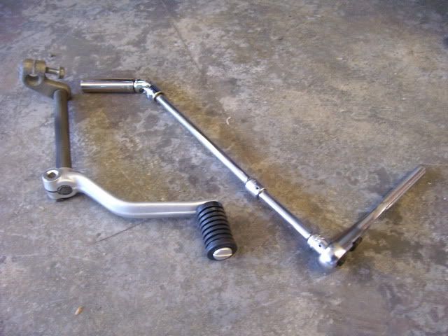

Here is one of the bent stock shifter. The angle of the pic makes it look twisted but it's not.
