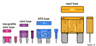

I don't think so... can you tell from this?

They look like the full size fuses not the mini ones used in the Valk fuse panel.

There's a spare fuse jambed into the strap holding on our (my?) battery. I feel like the centech fuses
are the same size as that one... I'll look later...
-Mike "drove the car to work today..."

« Reply #8 on: May 11, 2012, 01:38:40 PM »
That's one of the two spare main fuses and is bigger than the fuses in the fuse panel.

Hmmm... I just got back from checking... the fuse in my battery strap is smaller than
the fuses in my Centech...
Having looked, I'd guess that the Centech fuses are like the ATO ones in the picture, and
the one in my battery strap is like the mini fuse in the picture...
I don't remember ever blowing a fuse, so I guess I'm happy to be fuse ignorant  cooldude
Surely someone knows for sure what size the ones in the Centech picture are... let me know if you
want me to look behind the side panel and compare the fuses in there to the Centech ones...
