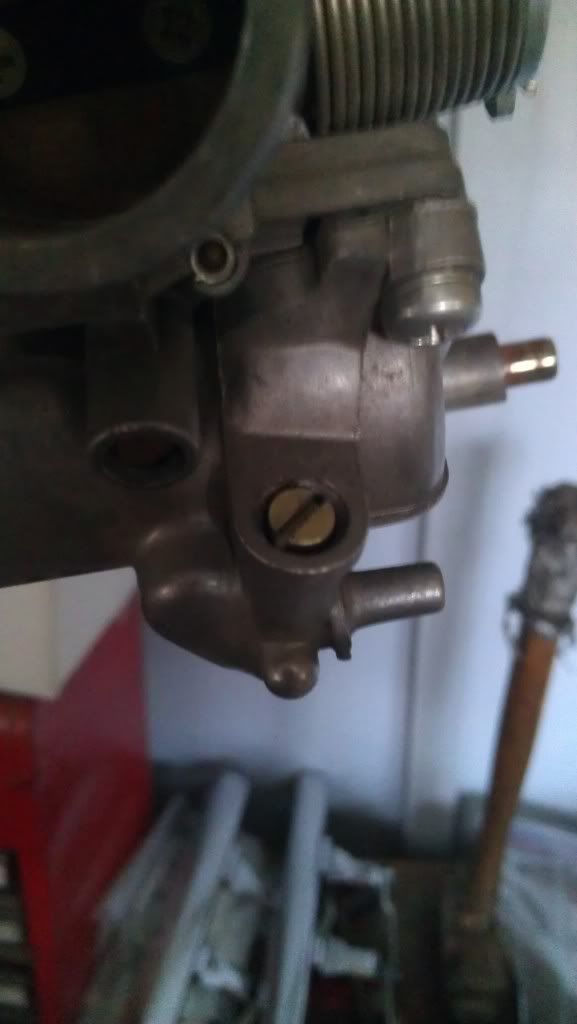

I am not having any issues but read here often about draining the carburetor bowls.  Can someone please post a picture and directions on how to do this.  I am just looking to gain more knowledge here.

Shut your petcock off first. There is a flat head screw on each carb that opens the bowl drain. There are hoses from each drain that are tied together and come out one big hose at the bottom of your bike. I took my hoses off so I can't tell you if that main one is capped or not. Put a coffee can under it or something and drain them all. You can turn your petcock back on now to see if your floats are stuck or not and/or your petcock is leaking by.

So you don't have to remove the screw, just loosen it?  And are this accessible without removing anything, meaning I can get right to them with a screw driver?  Sorry the bike is not with me today.

Yes, just loosen it. No need to remove anything. Should be readily accessible.

Nope, you don't remove the screw. Some are harder to reach than others, do you have a "bendy" screwdriver? I don't but am still able to reach them all with a couple different drivers. A long skinny one is helpful.
