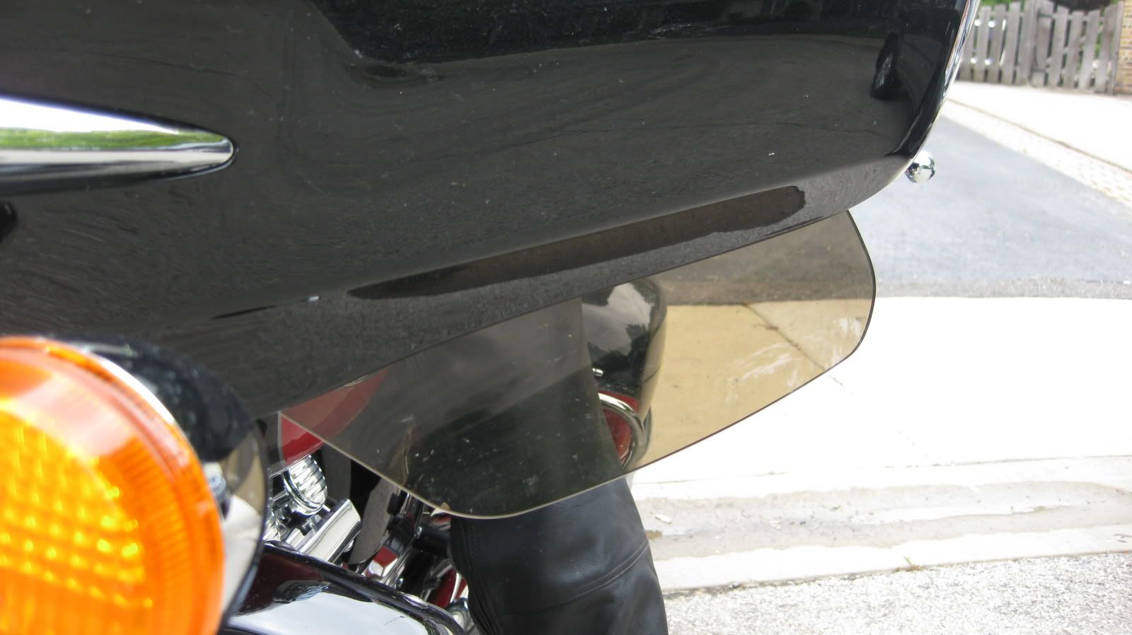

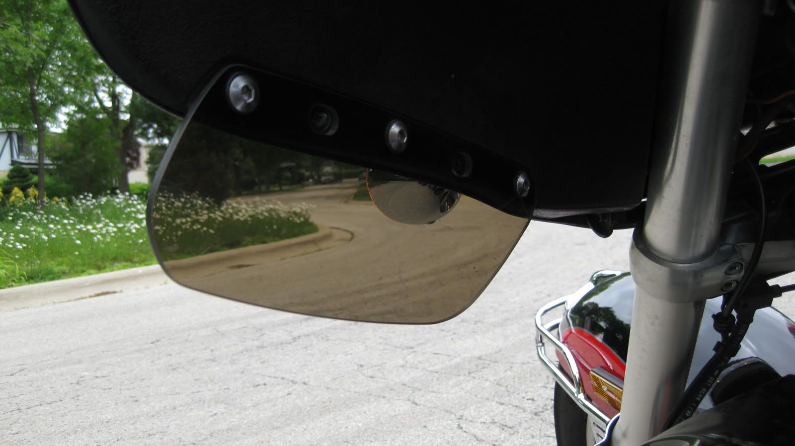

I had a bike in for service today, and it had these aftermarket deflecters on the fairing.  Tinted, thicker & better quality than OEM.  They were on the bike when purchased with 1800 miles on it, 4 years ago, so the owner was no help.
Anyone know of a source for them?

Tulsa Enterprises.
They were discontinued a few years back.
I painted my stockers gloss black, but you could make your own set from smoked Lucite. A judicious touch with a heat gun will have the material soft enough to bend and form the angle you need...
