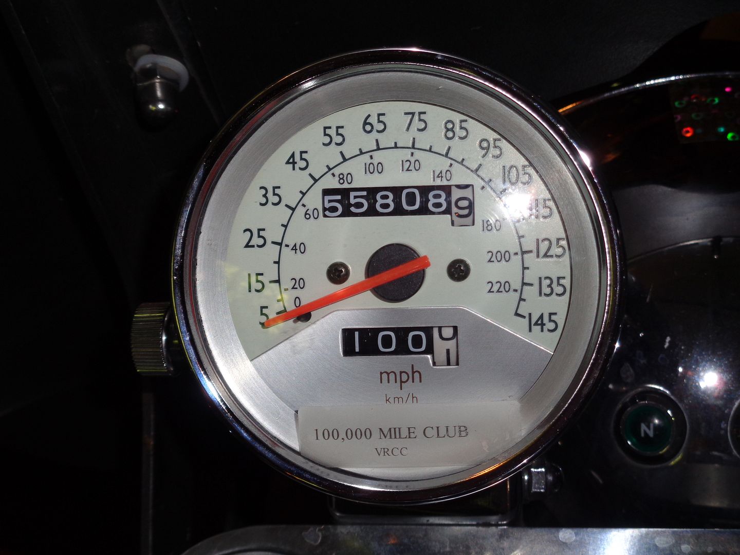

Some of you have expressed some sort of notation for a100,000 mile club so I thought I'd post this on this thread for anyone interested.
I used clear address labels.   I went through Avery but there may be others out there.
 The labels cost about $15 and the Avery site provides templates and different formats.
 VRCC on the label may have to be ok'd before it gets too wide spread.
