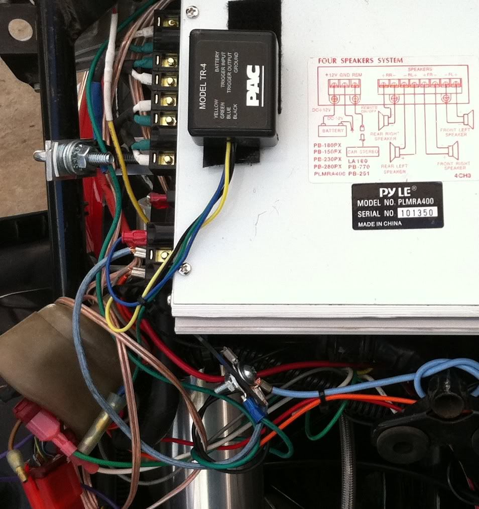

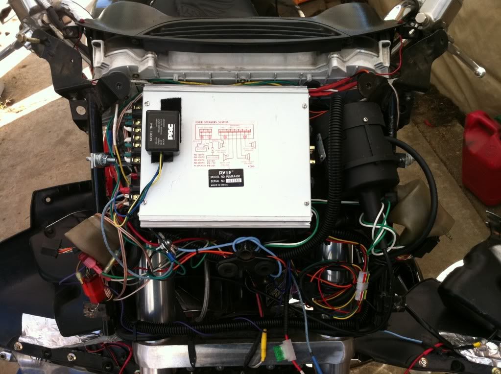

Anyone have pic's of where you mounted your amp and how you wired it...  I have a Pyle PLMRA400
amp...

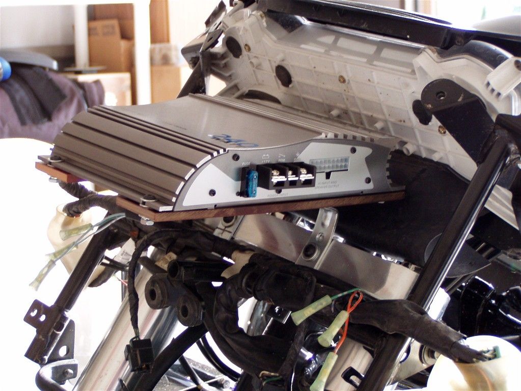

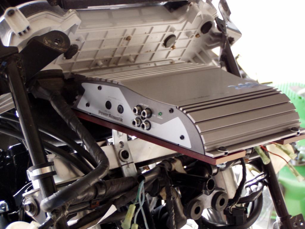

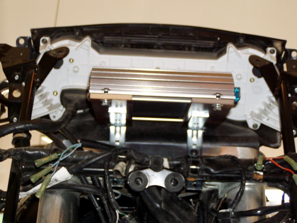

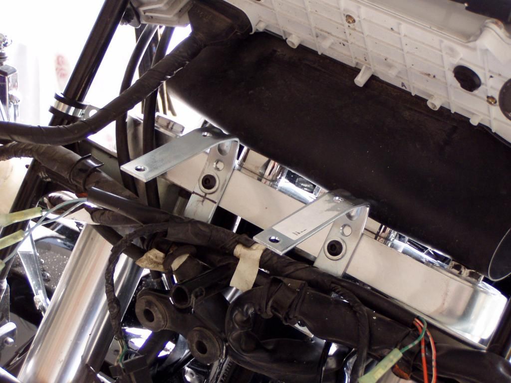

« Reply #6 on: March 24, 2013, 02:26:44 AM »
Just another flavor of how to.
If you need or want more images let me know.... I think I have a few more.

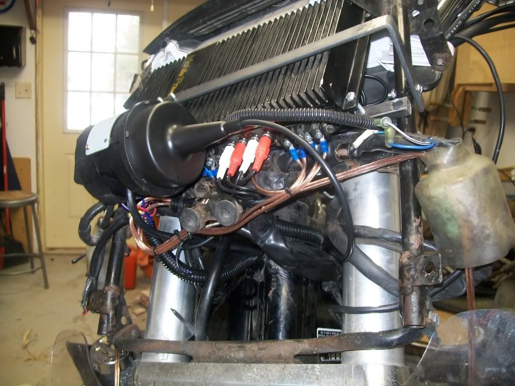

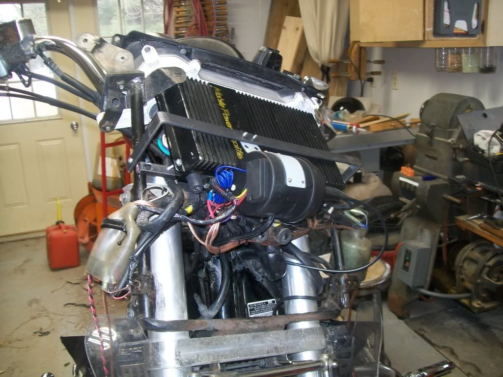

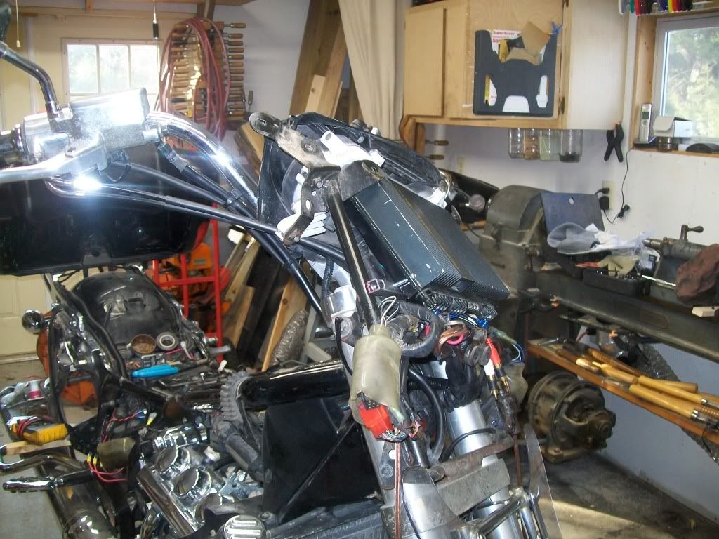

« Reply #10 on: March 27, 2013, 03:47:29 AM »
Nakamichi PA-350 with cruise control.
w/o cruise;

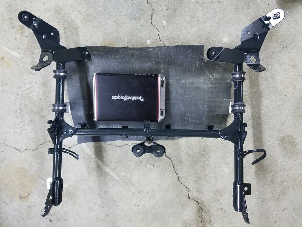

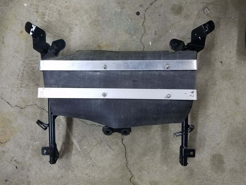

« Reply #14 on: April 26, 2017, 05:29:32 AM »
I made a simple bracket and used a small piece of rubber so when installed it protects the unit from potential moisture.
