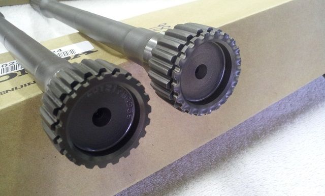

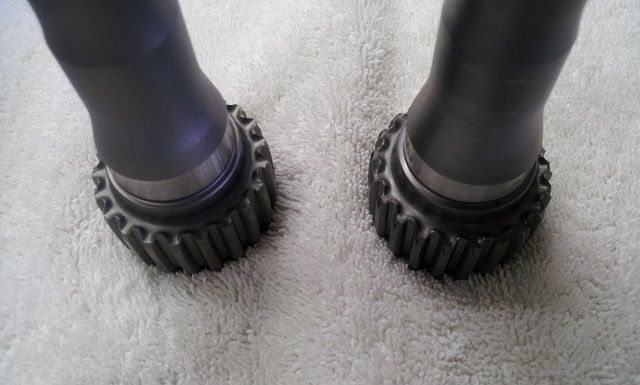

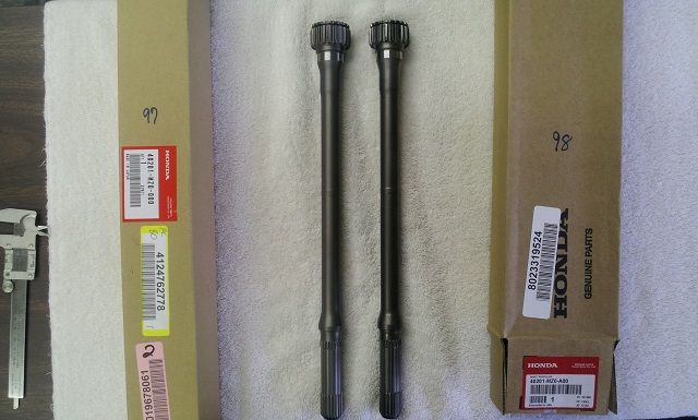

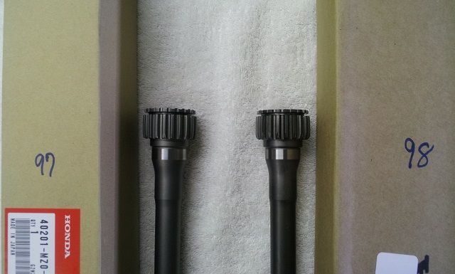

A while back there was a discussion as to the differences between the 97 propeller shaft (40201-MZ0-000) and the 98-03 shafts (40201-MZ0-A00) because the former is $100.11 and the latter costs $48.01 from HDL. From what I can tell all models use the same pinion joint (41410-MN5-000), oil seal (91261-ME9-005) and yoke joint (40200-MZ0-A00).
A picture of the two shafts is shown below.
They appear to be identical except for a few things. The end of the 97 shaft splines that mate with the pinion have undulations of steel while the 98 shaft face has more of a milled finish.  I dont think this difference is anything significant. The center points for attachment to a lathe are larger on the 98 shaft. Both years have the same undulations beyond the splines on the shaft side.  Also, the machined surface that the oil seal rubs on is wider by about 1mm on the 97 shaft over that on the 98 shaft. I cant imagine that the shaft on a 97 Valk would float back an forth enough to need a larger machined surface preventing premature failure of the seal.
From my perspective there would be no consequences of using the less expensive 98-03 shafts in a 97 Valk or visa versa if you want to pay more than double the price.

« Reply #1 on: May 22, 2013, 07:52:42 PM »
One difference you didnt mention is the shaft (especially near the U-joint end) is turned narrower on the 97.  This is the whole stated reason for the two part numbers.  Apparently there is a possibility of the 98 and later drive shaft ribbing on a part of the swing arm if used in the 97.
If I ever buy another drive shaft for my '97 I will be getting the more expemsive one.

« Reply #2 on: May 22, 2013, 09:11:25 PM »
I just happened to have used a flashlight to inspect the inner portion of the swing arm and observe  the end of the ujoint. Thinking about the clearance for the drive shaft, there is no possibility of any portion of the drive shaft contacting the swing arm housing....perhaps the 97 swing arm is different?????

« Reply #4 on: May 22, 2013, 09:50:47 PM »
Chris I have measured the diameter of both shafts as well as the end near the yoke joint. The diameters are essentially the same, if anything the 98 shaft is ever so slightly narrower ( less than 0.5 mm). Even if it was the other way around, I wouldnt think this kind of thickness difference would cause a rubbing problem.

« Reply #5 on: May 23, 2013, 03:35:11 AM »
Hmmm... my new driveshaft is the undulating 97 kind. The rusty one I just pulled out
is not undulating... I didn't give it much thought, just figured the manufacturing
process had changed somehow...
Thanks for posting the explanation of the difference...
