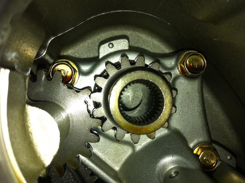

Here is a picture of what I see so far.
Looks like the case ok and I will have to replace the one gear that is missing 2 teeth which also brings me to another question
HOW DO I FISH THE MISSING TEETH SO THEY ARE NOT LEFT IN THERE?

Next questiion is the pin boss in the rear engine cover broken? Both of the hydrolocks I've seen the rear engine cover was also trashed not just the gear.

I spent the afternoon taking the engine off the bike, I did not have another set of hands so I just took my time and used the manual as a guide.
My intentions are to fix the damage and since I have the engine off, I will rebuild the carbs and will change the petcock to a pingel.
I have not ordered any parts yet because I wanted to open it up to make sure I did not miss anything.
I was under the impression that I could just remove the rear case without having to remove the clutch assembly.
DO I NEED TO REMOVE THE CLUTH ASSEMBLY FIRST?

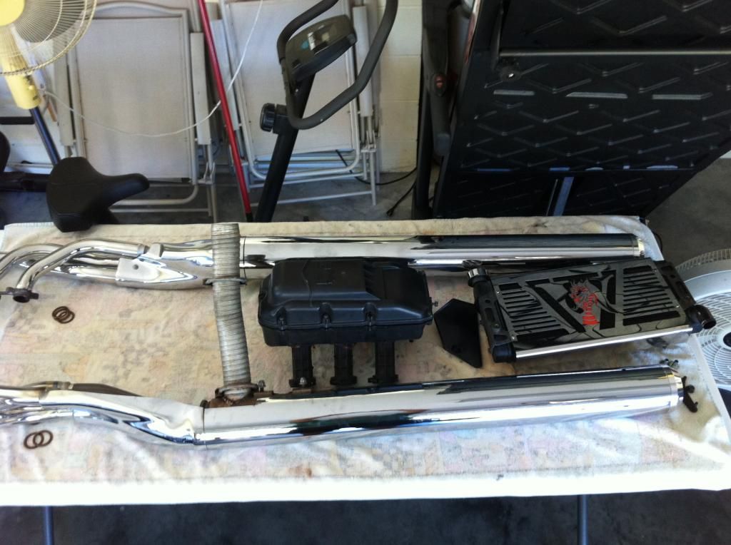

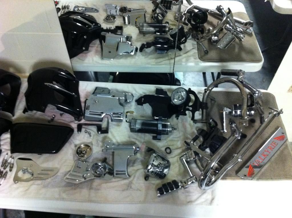

Many, many thanks for all that responded, at some point I had to stop thinking about all the work and time that I was going to have to invest and just GET TO IT AND DO IT.
A couple of pics of my progress.

Looks like you've got a lot done. Good luck and keep the updates coming. Looking forward to resolution of your problem. For what it's worth I would go with the pingel petcock and a danmarc shutoff.

"Many, many thanks for all that responded, at some point I had to stop thinking about all the work and time that I was going to have to invest and just GET TO IT AND DO IT."
There ya go,,,your well on your way now, and just think, this is the perfect opportunity to finish painting the starter motor.
Yes sir, you could not see it unfinished when mounted on the bike  Grin

In your first pic, I was surprised to see 2 starters and other items doubled up.
Then I noticed it was a mirror.  Smiley
