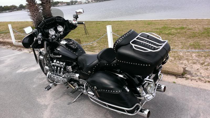

My bike with the large bore 4" drilled tips.....

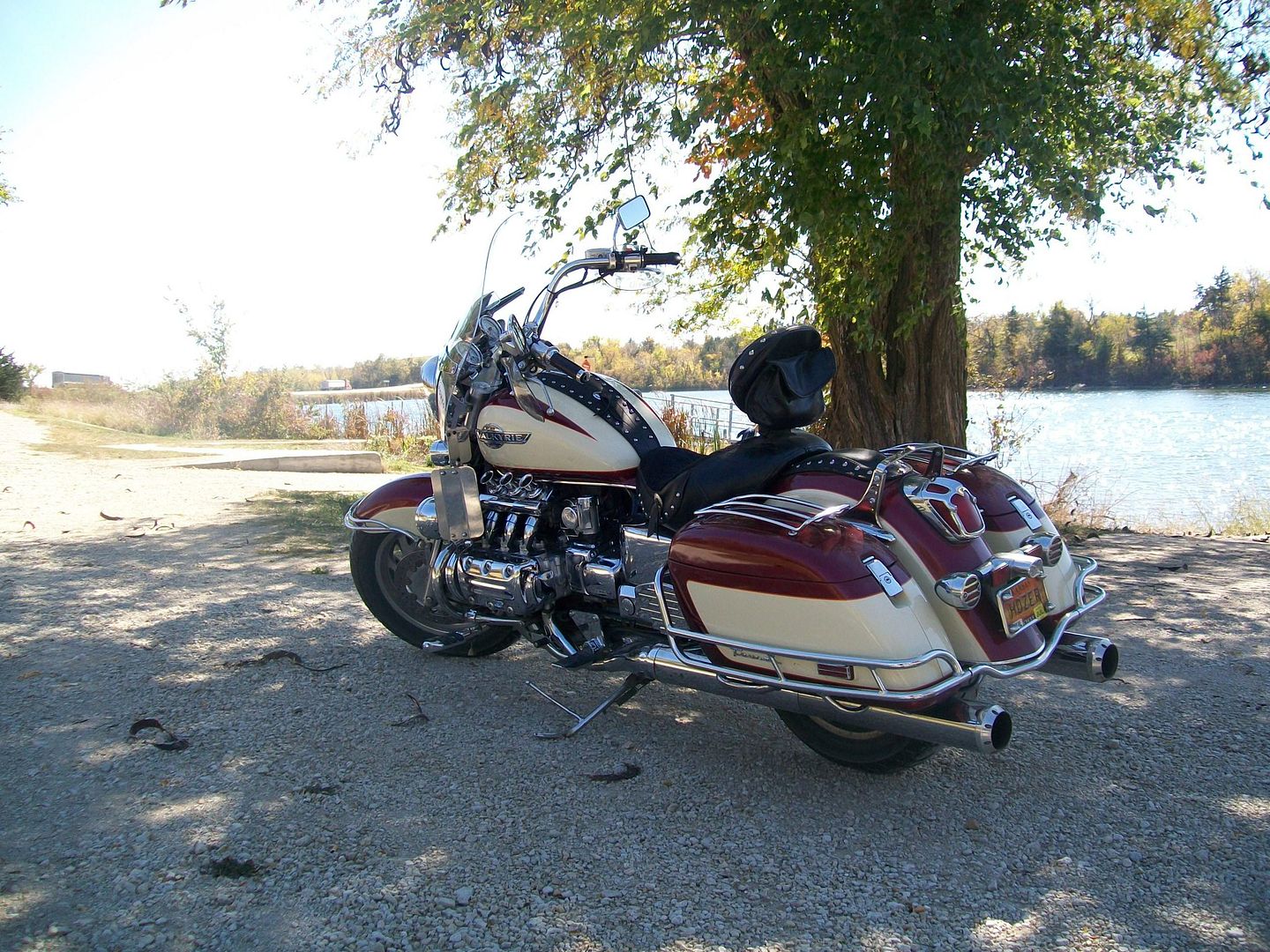

They're the 18" from AirFlow on OEM pipes.
Just know that they DON'T come pre-drilled.  You have to drill your own mounting holes.  Just transfer your holes from your old tips to the new ones.....measure twice, drill once.   Wink

Tapped them over the muffler body with a 2 by 4, drilled the mounting holes out of sight, solid as a rock.  Ran for awhile without the screws, gradually loosens up.  They need the mount screws.  About 4 inches to the end from the bag guards, nother 1/2 inch with the grumpies.  You need to watch for high curbs if you back in to park.   According to a dyno run, my Torque and HP was up a bit after the tips were put on.  99 HP,98 ft lbs torque.  Probly because it raised the back pressure I'd guess. Sort of tuned the exhaust. Also gives a more porche like tone.  I think you will like them.  Hoser  cooldude

Yes. Mine too are full length (seamless) but they are 36". Slide on and hold tight. Here is a side pic.
