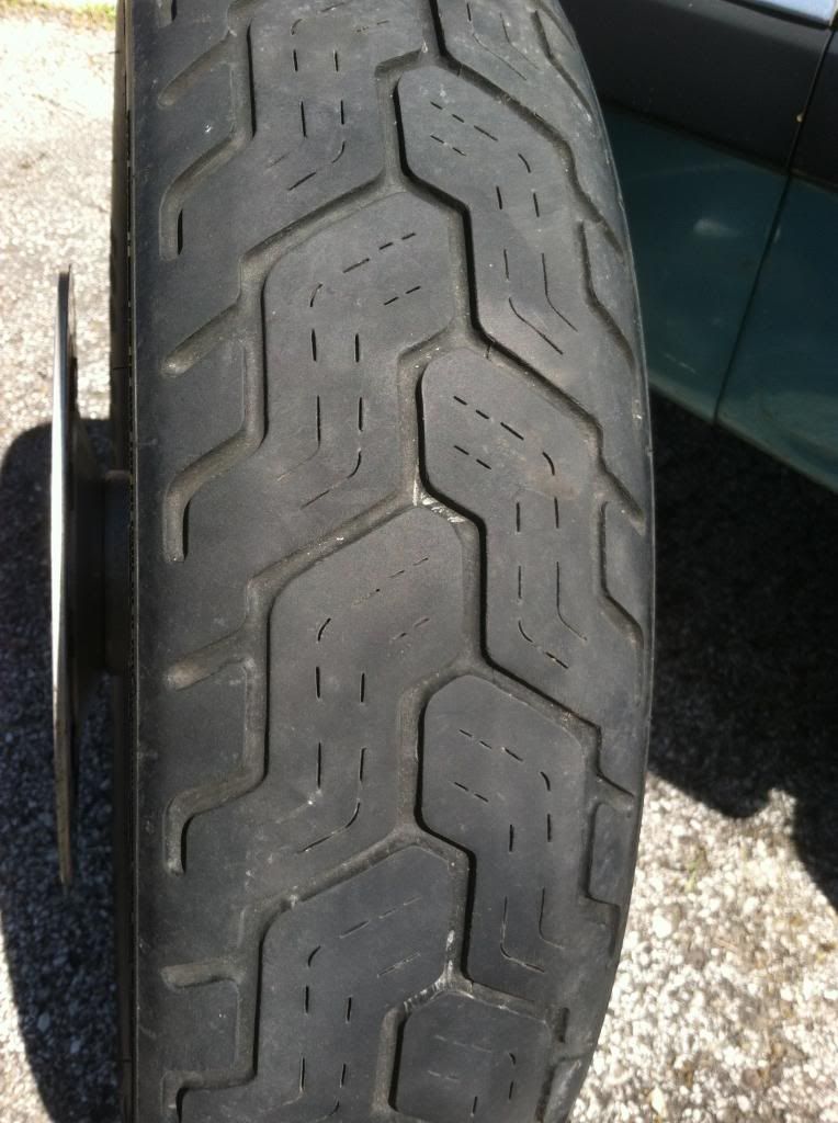

I put a Falken Ziex ZE-512 205/65R-16 on the back 3 years ago, with a D404 130/90-17 bias rear up front, Dyna beads for balance, 40-42 PSI on both ends.
Last year I replaced the front tire with the same D404, the first lasted 22K plus miles.  Quiet, no shimmies, solid in the rain (and it spent a lot of miles in the rain). I may change the rear this spring, but with what I don't know. The Falken doesn't exist any more, but I will stick with the D404 rear up front until they stop making it.
D404 at 17K miles.
The Falken at 17K miles.
Fred.
D404 at 17K miles.
Fred.
