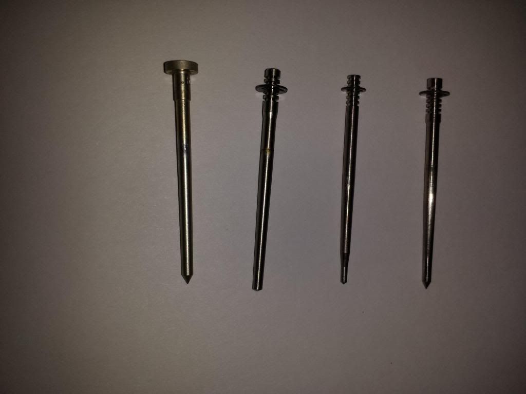

Is there a place that shows an illustration of the needles for a Valkyrie?

I haven't and I'd like to find/see on also. I've also wanted to measure and compare a '97 with a later one.
« Reply #2 on: March 11, 2014, 04:11:22 PM » |
cobra, dyna and viking needles are the same and all three are richer than FactoryPro needles which are richer than the OEM. OEM are not adjustable all others are. per FP dyno testing the front 2 carbs needles should be slightly richer than the others. one extra washer does the trick, there is a noticable difference esp if back to back road testing is done.
I have all of them except the cobras, but they are made by dyna. I use the FPs and oem slide springs with viking pipes. might try the I/S springs I have, didn't like them with the oem pipes with glass packs.

they do have different tapers...I've seen pictures comparing them side by side, but I'll have to look around to see if I can find them again.

The first one on the left appears to be the OEM (no notches and no "e" clip) and the one next to it matches my Factory Pro needles...that's a start.

« Reply #5 on: March 12, 2014, 02:47:47 PM » |
Wow, heck of a difference.

« Reply #8 on: March 13, 2014, 09:01:17 AM » |
not a pic of the valkyrie kit, that is cobra's std marketing pic

« Reply #9 on: March 13, 2014, 01:46:52 PM » |
agreed. the next one is a dyna needle which is exactly like the viking needles I have, in addition the viking needle instruction sheet is exactly like the dyna sheet except for vikings logo at the top and the word viking on certain lines and the contact line at bottom of page. do not know what the last to the right is. somebody posted before that the first run of viking pipes had different needles than the later runs.
