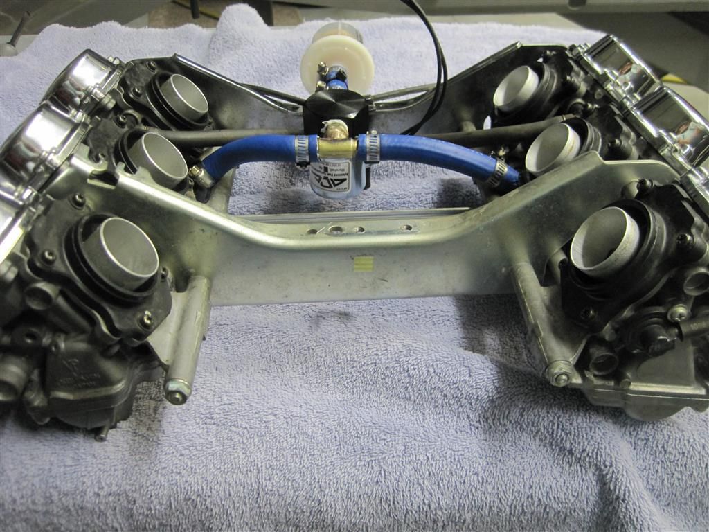

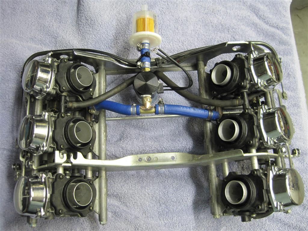

I bought a new to me 99 I/S. 17,000 miles, I was sure it would need some carb work and I was right.

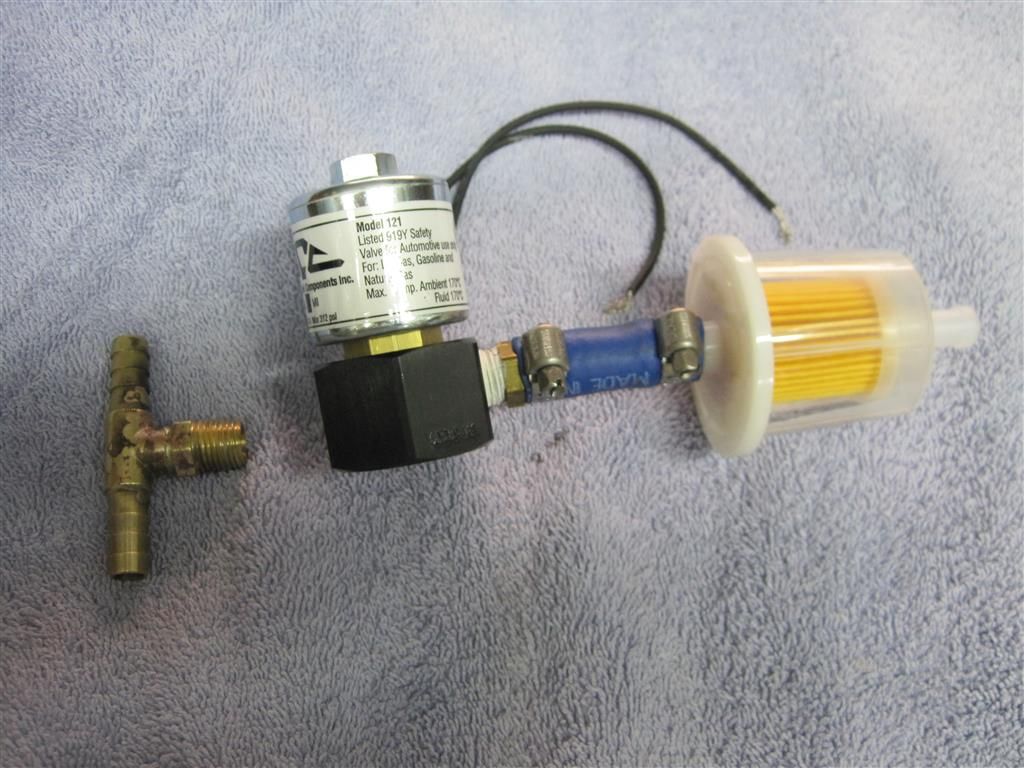

Odd thing was, someone was just in the carbs. They were all marked and fairly clean. But they didn't address the source. The tank has some rust in it, not bad but a problem none the less. So I pulled the carbs, desmogged, cleaned, added a 121 Advanced Fuel Components valve, and a filter.
I made myself a Tee that would thread in to save space.

« Reply #4 on: May 25, 2014, 01:56:39 PM »
I'm not sure if I see a problem.  ???  However I'm confused about the gas flow through the Dan Marc valve.  I haven't seen the one you show.  Undecided  I like what I see.  Smiley

« Reply #5 on: May 25, 2014, 02:22:14 PM »
It's a 121, they didn't have a 111 in stock and I didn't want to wait for one.  It flows more, has 1/4" pipe threads. Seems like it will work fine.
« Reply #6 on: May 25, 2014, 02:45:35 PM »
I like it, filter and all.

« Reply #8 on: May 25, 2014, 07:04:51 PM »
Looks good. I couldn't find the orifice size on the 121. Do you know if it is the .156 or .100 orifice?

« Reply #9 on: May 25, 2014, 07:33:41 PM »
The AFC website says the 121 is available in either a 0.250" or 0.3125" orifice. Both of which are larger than the 111's 0.156" orifice. The valve looks good and your geometry looks even better, Jeff. Your fuel filter sure has lots of surface area and might just work out great. I pulled my (much smaller) fuel filter out after fuel starvation issues at speed while pulling a trailer. The right angle threads and brass tee makes for a slick location for the valve. Tidy and Cool!  cooldude
« Last Edit: May 26, 2014, 06:10:12 AM by BonS » Logged
« Reply #10 on: May 25, 2014, 08:36:18 PM »
The AFC website says the 121 is available in either a 0.250" or 0.3125" orifice. Both of which are larger than the 111's 0.156" orifice. The valve looks good and your geometry looks even better, Jeff. Your fuel filter sure has lots of surface area and might just work out great. I pulled my (much smaller) fuel filter out after fuel starvation issues at speed while pulling a trailer. The right angle threads and brass tee makes also make for a slick location for the valve. Tidy and Cool!  cooldude
Thanks, sounds like this is the one to get cooldude
