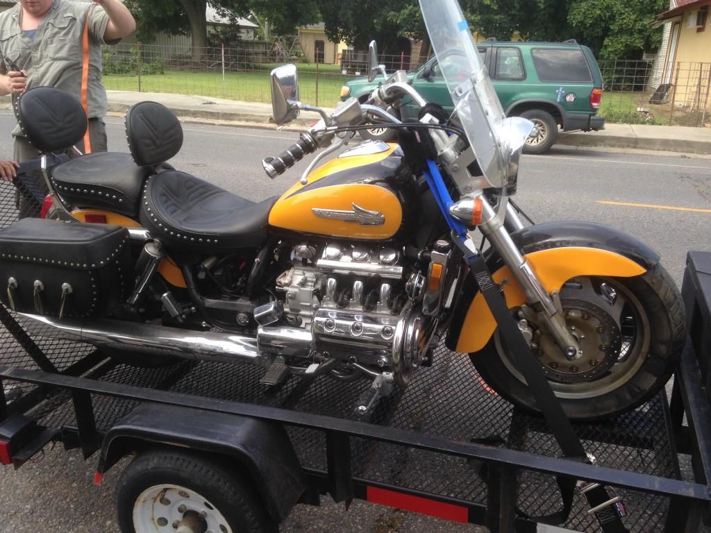

So here she is. Granted I was able to figure out this picture posting thing. laugh wife picked her up, took some pictures verifying hydro lock.  Broken starter gears and rear case.  Needs the fork seals replaced and new tires.  Got the parts ordered for the forks, rear case, and gears Grin  Cheesy gonna be starting the rebuild process when I get back in from offshore.  More pics to come through the repair process, and I'm sure lots of questions too.  Can't wait to get her running!

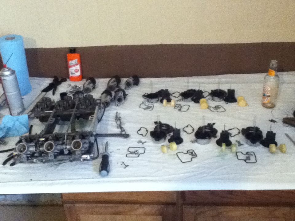

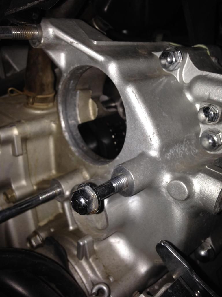

started the work a couple days ago.  Got the motor pulled and the rear case removed. found another broken gear so now im just waiting on the part to come in so i can re assemble her.  heres some pics so far.
carbs pulled and torn apart for their rebuild and repair

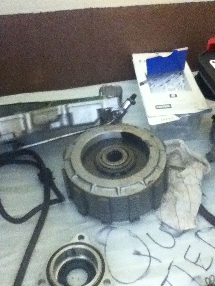

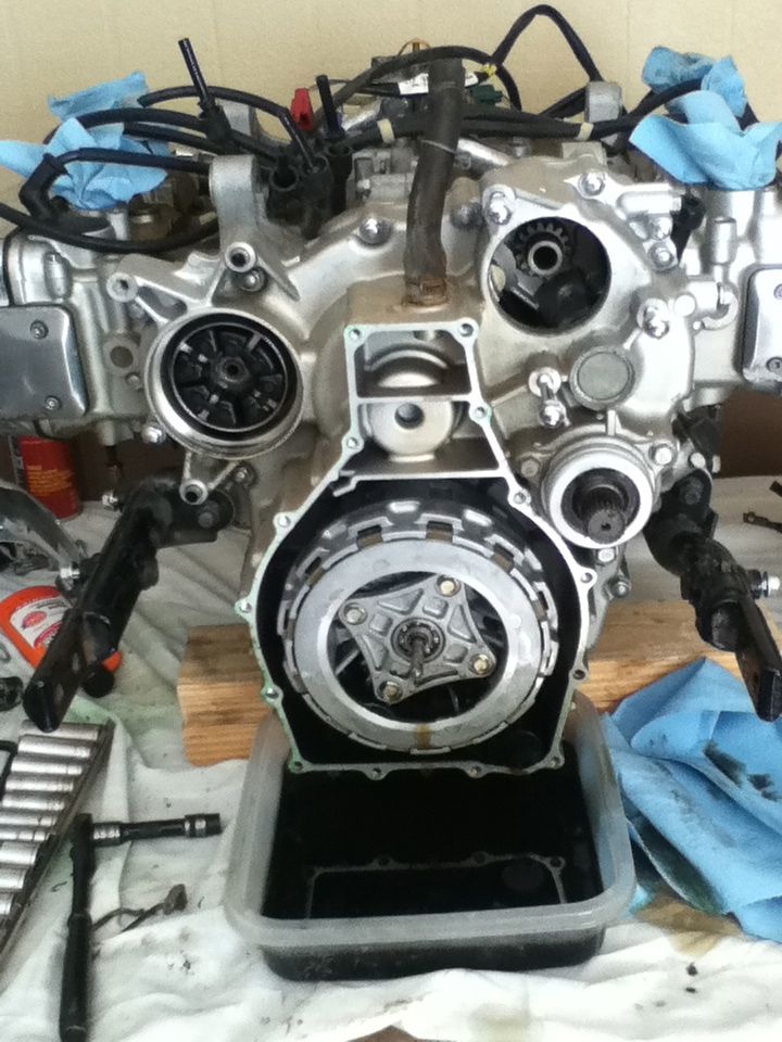

motor pulled on the work bench starting the break down

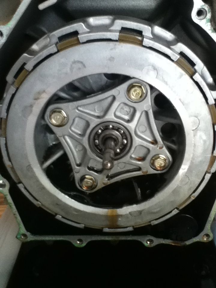

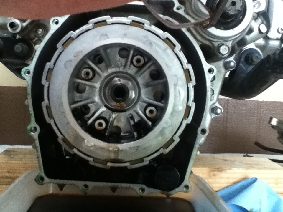

the clutch pack and plate that needs to be removed
plate off remove nut to pull clutch plates out
clutch plates removed

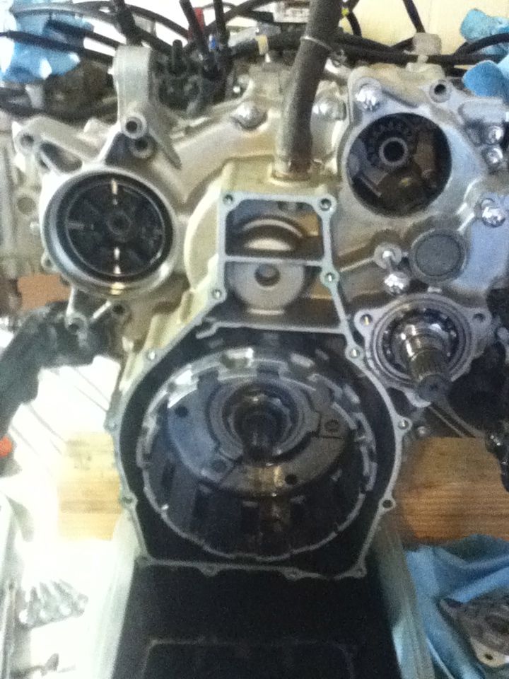

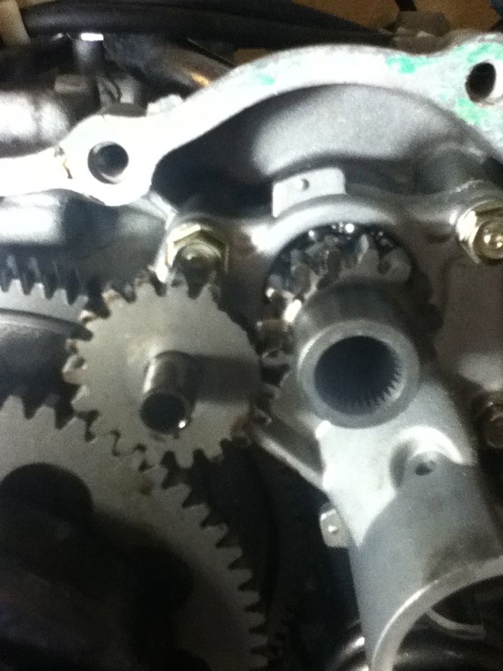

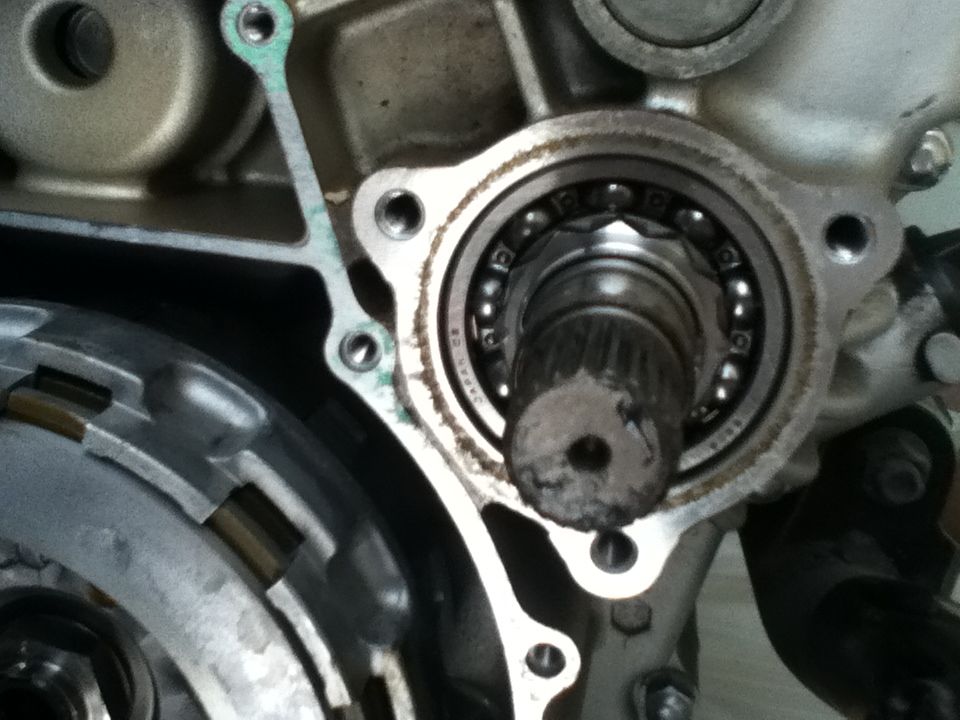

clutch basket left first specialty tool nut in the center.  used a 1 13/16 homemade long socket with impact
second specialty tool nut on output shaft used 1 7/16 homemade long socket with impact
rear case removed inspecting gears

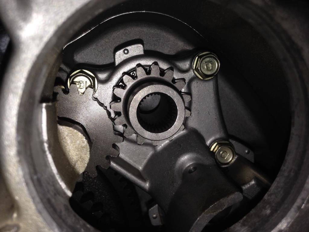

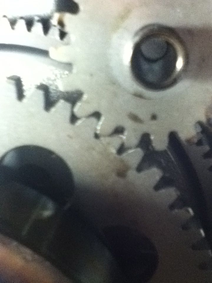

found another broken gear just one tooth cracked and bent over.  waiting on this part to come in
3 teeth missing on the transition gear found 2 still searching for the third
sorry about the crappy quality pictures using a phone dont have a camera any more.  so far so good on the tear down.  any suggestions would be greatly appreciated.  hope this helps with others repairing a hydrolock.
