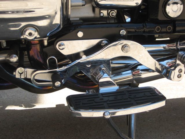

Here is a photo of lowering kit on my bike from Mark T.
WDAN
Irving, TX
Tundra

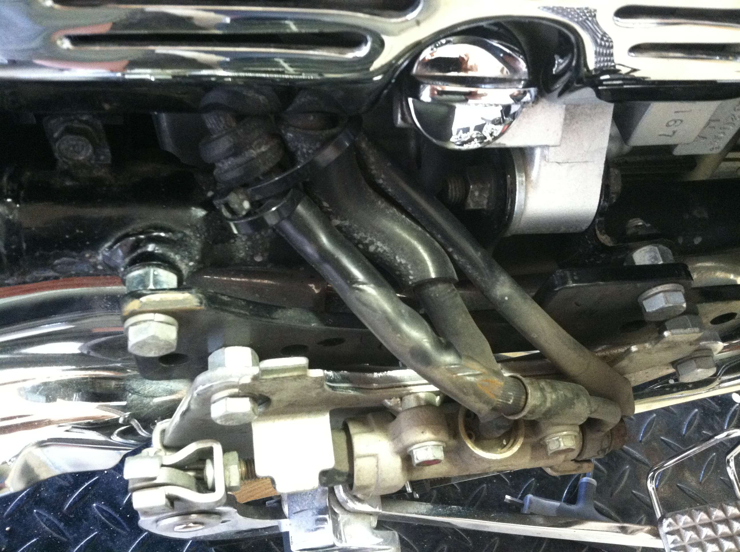

I assume that the "plasti-chrome" cover goes back on on the brake side to cover up the master-cylinder?

What a great idea!! I also could use a little extension.
None of my Valkyries has a "plast-chrome" cover on the brake side except on the reservoir.
Are you sure the master cylinder has a plastic cover?
ALWAYS QUESTION AUTHORITY!

« Reply #17 on: May 16, 2016, 12:57:05 PM »
#1 is plastic, #24 is metal
