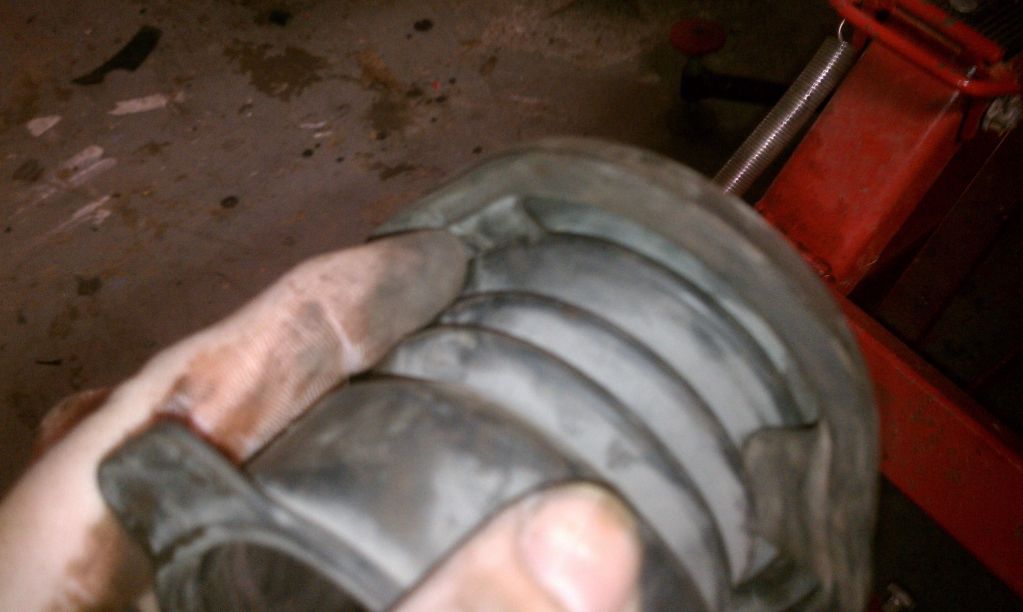

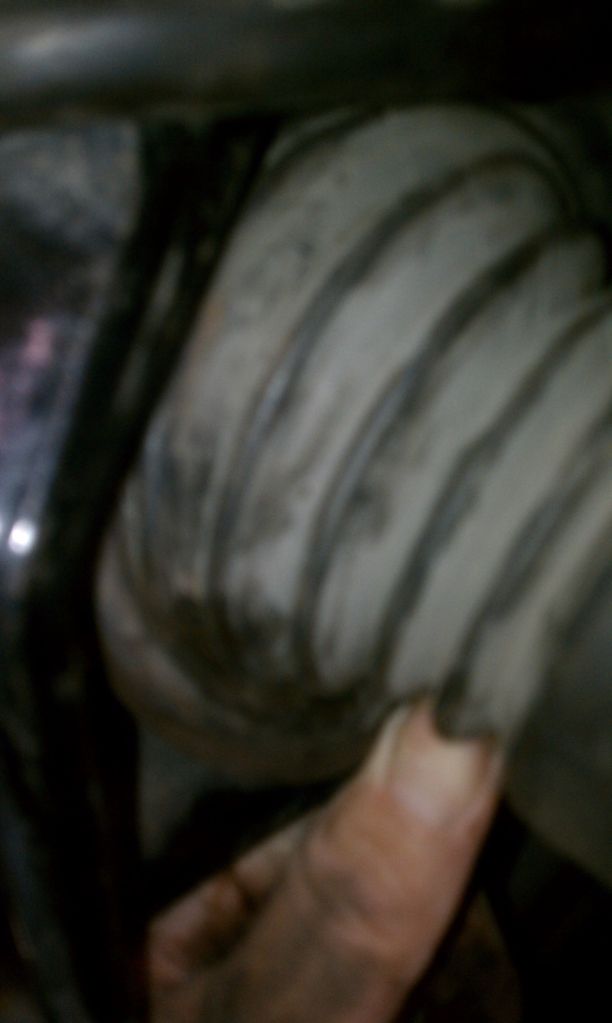

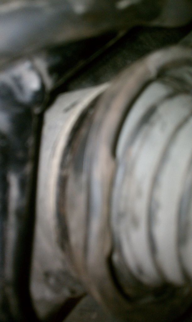

i put photos of the prefered two minute boot replacement technique on a valk facebook page, i will see if i can put photos here, but in the meanwhile what you do is fold the swingarm side of the boot back, put it around the ujoint, then use the tabs to plop it in place. its pretty simple. i guess we need a shop talk section for this...
uturn
Posts: 111
bayou vista, texas
« Reply #23 on: January 12, 2015, 08:19:28 AM »
ok i think i got them. fold it back, push the tabs up to the last ridge, wiggle the boot around the shaft, and then pull each tab over the swingarm cover. this will put the ridge that fits around the cut outside the swingarm tube aft of the cut so you will probably need to wiggle it out a little to make sure its seated and waterproof...
« Last Edit: January 12, 2015, 08:24:15 AM by uturn » Logged

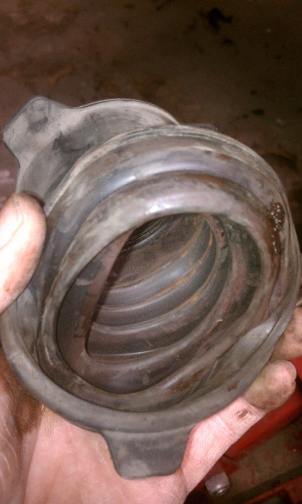

uturn
Posts: 111
bayou vista, texas
« Reply #24 on: January 12, 2015, 08:25:38 AM »
obviously its an old dirty boot, but im still waiting for my replacement to show up...ill try to get better photos when its time to actually put it back together...
