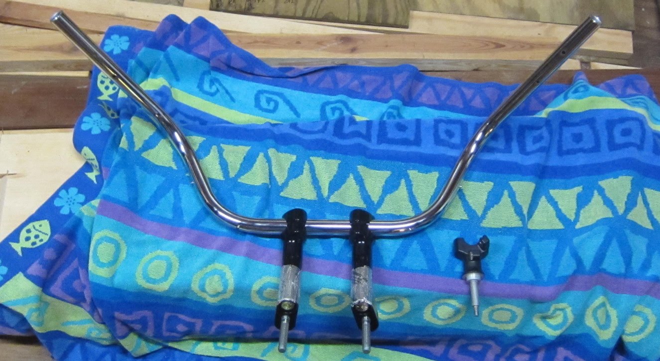

The root of the problem is those lame handlebars and the dinky one inch
risers.

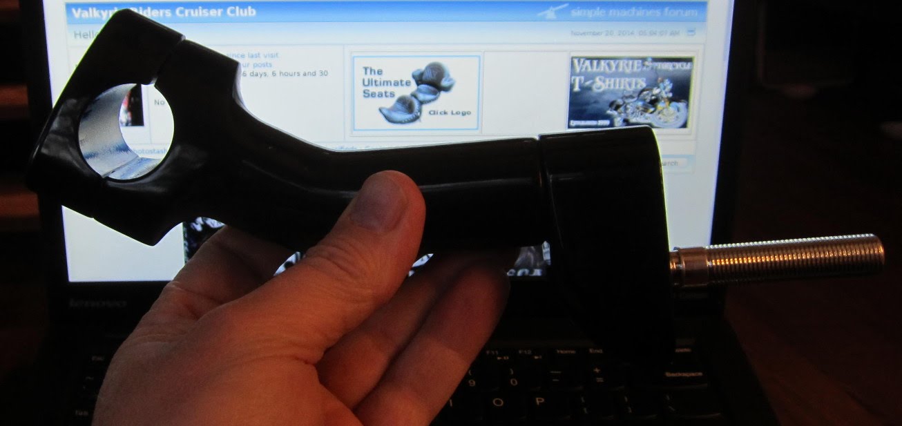

I fixed that with some Baron 4 inch pullback risers and Baron riser extensions. The extensions
moved the risers back an inch and raised them an inch and allowed me to vary the distance
between the risers to fit whatever handlebars I chose... I chose 1500 Valkyrie bars, of course  Wink ...
The tape was just to register the extenders while I was tightening the bolts.

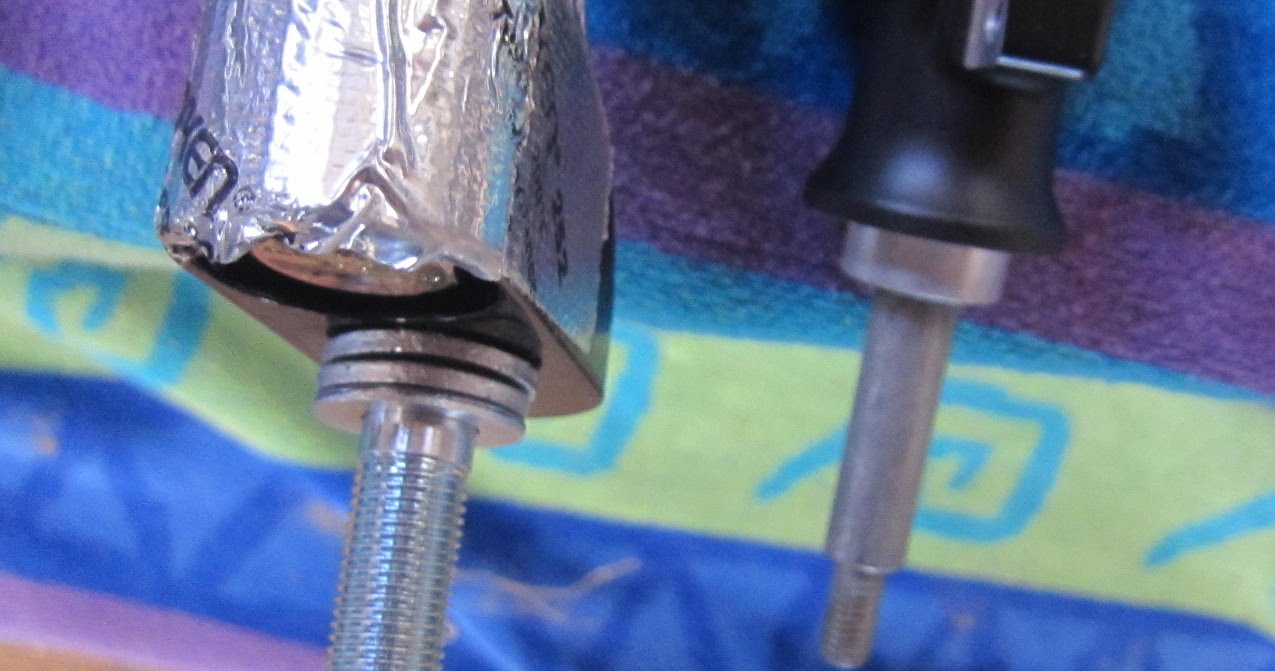

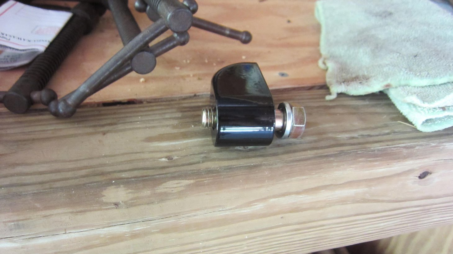

The new Valkyrie's risers are rubber mounted, and there's a collar around
the stud as it exits the riser. Without this collar, there would be a void under
my new risers. There's a certain size of washer that is perfect, but the hole in
the washer needs drilled out...

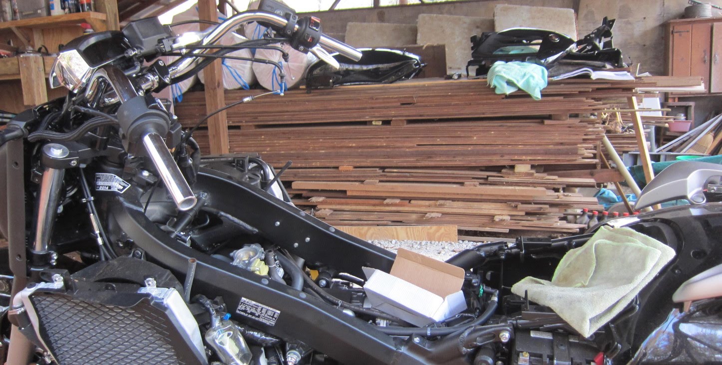

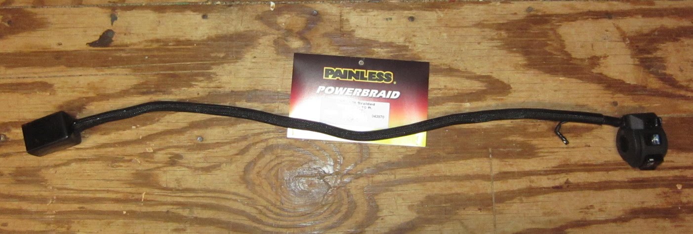

So, now I've got some bars/risers with some promise, but none of the control
wires and hydraulic lines and throttle cables will reach.

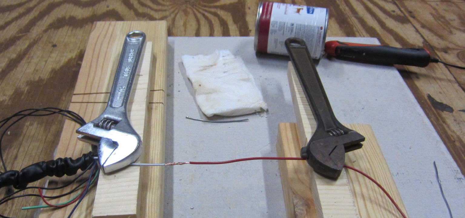

I cut the control wires and soldered in nine inches more wire and used
this nice wire loom to cover it up...

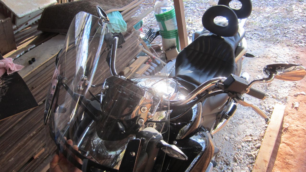

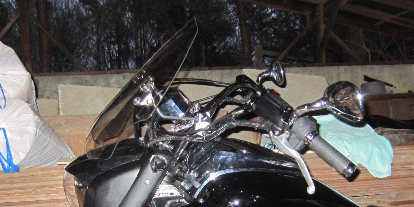

And I ordered a Memphis Shades Hellcat handlebar mounted windshield, the
OEM one no longer came anywhere near fitting.
You basically have to remove everything but the motor to get to the throttle bodies to
change the throttle cables...

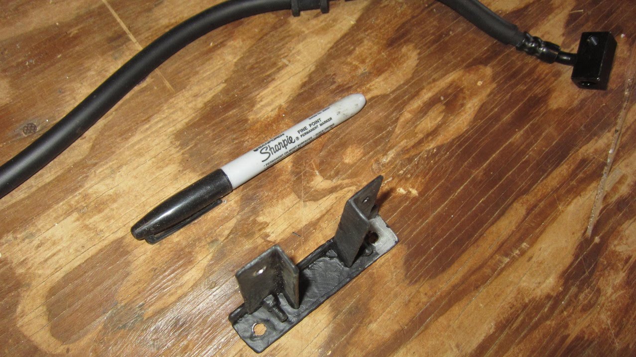

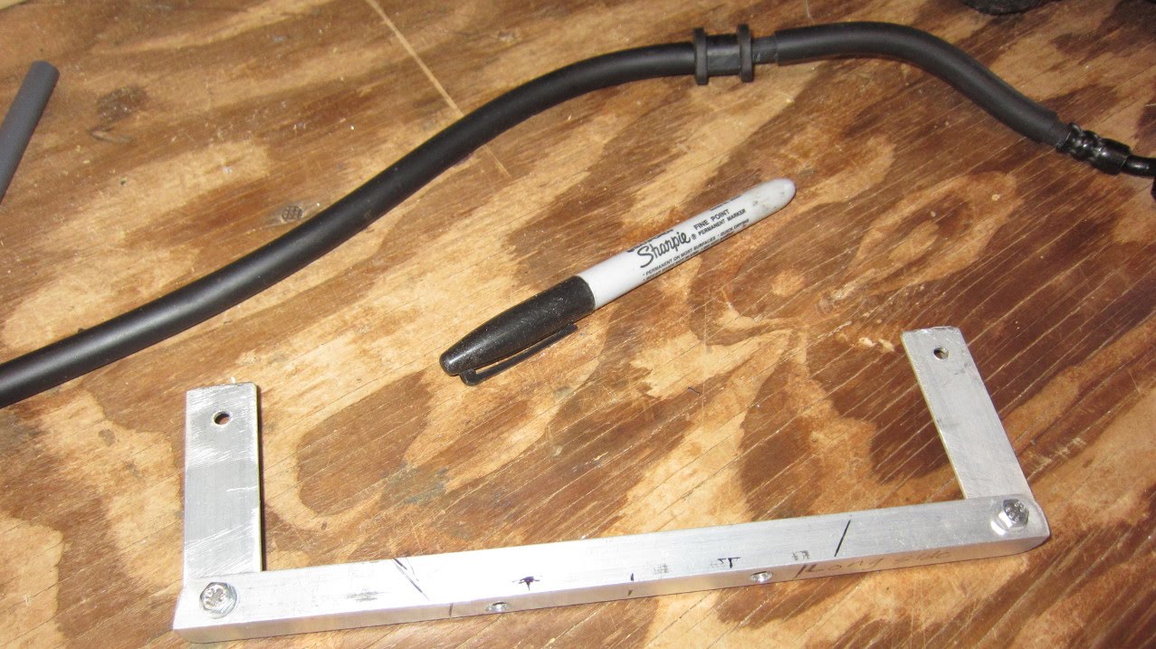

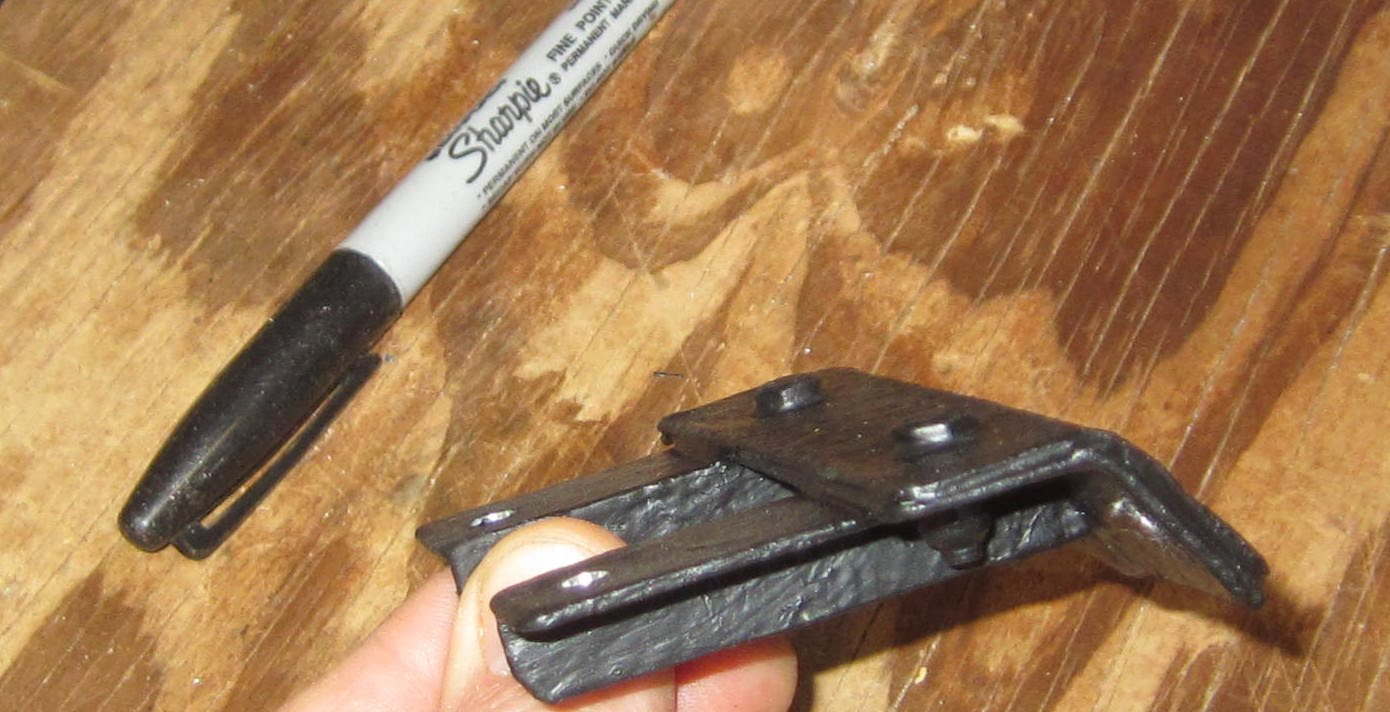

The LED pod mounts to little tabs on the OEM risers, so I had to make a bracket
for that.
Too ugly to even finish...
This one was small enough to finish, but it held the LED pod at the wrong angle...
There's no such thing (well, I don't know where to get it) as 45 degree angle
iron (aluminum  Wink ), and I don't have any kind of brake to bend aluminum
flat stock, so I made what I needed from several layers of roofing tin... I
have hand brakes that can bend that. The black stuff is several layers of
PlastiCoat...

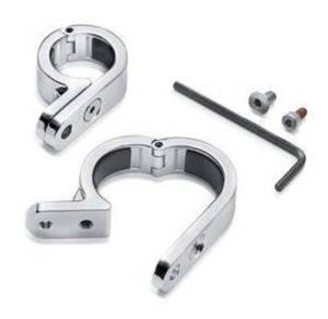

The bracket is held to the handlebars with a couple of Formotion clock mounts...

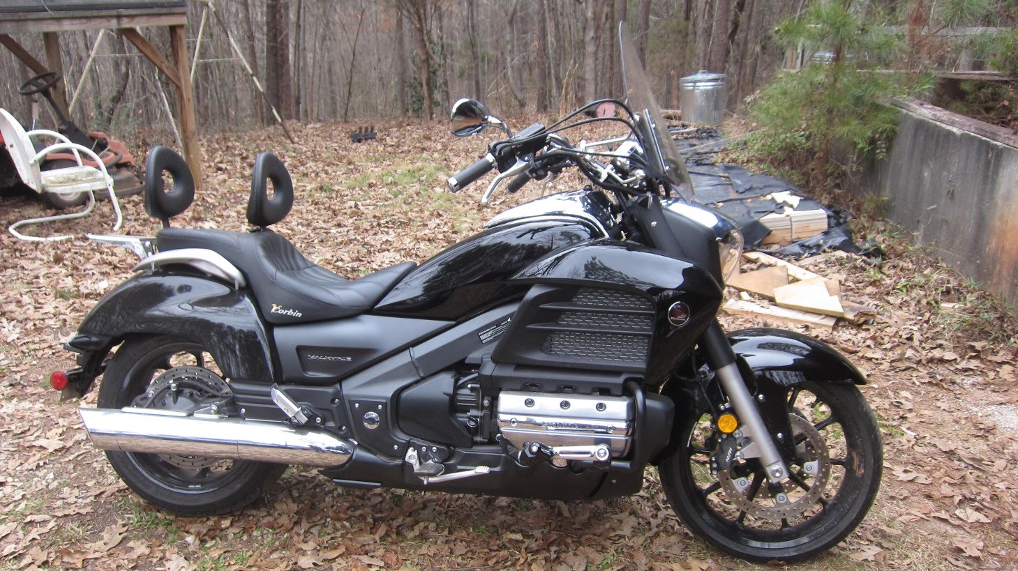

Here's the bike pretty much as it is now (finger prints and all, I haven't washed it since
tearing it all apart)...

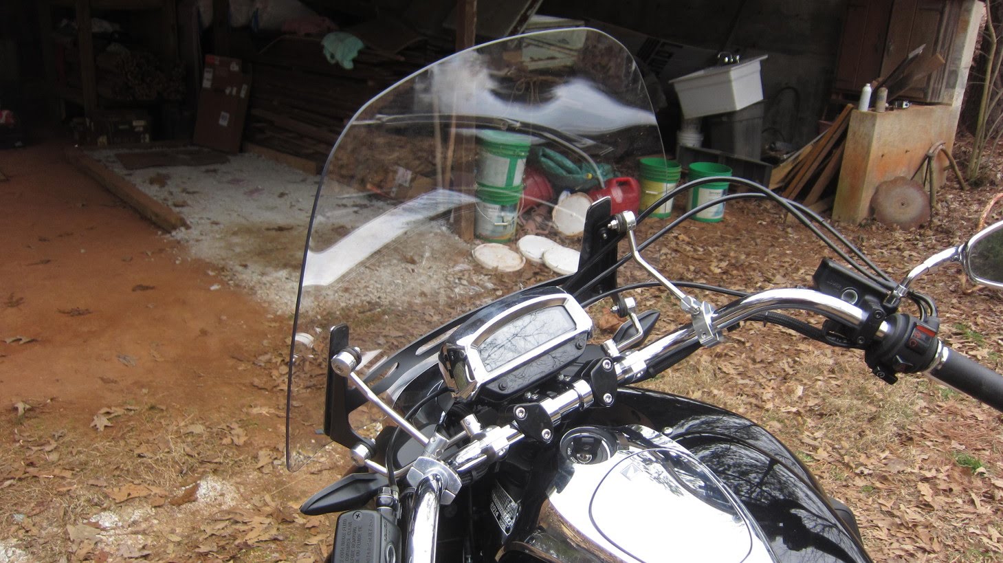

As small as it is, the windshield is nice, and can be adjusted a bunch of different ways. I
don't like to look through windshields, this one is plenty tall enough... it could be wider.
I'll probably keep fine tuning its adjustment, and maybe rotate the bars a little, but
my ride today, especially after I rotated the backrest forward a little, was great.

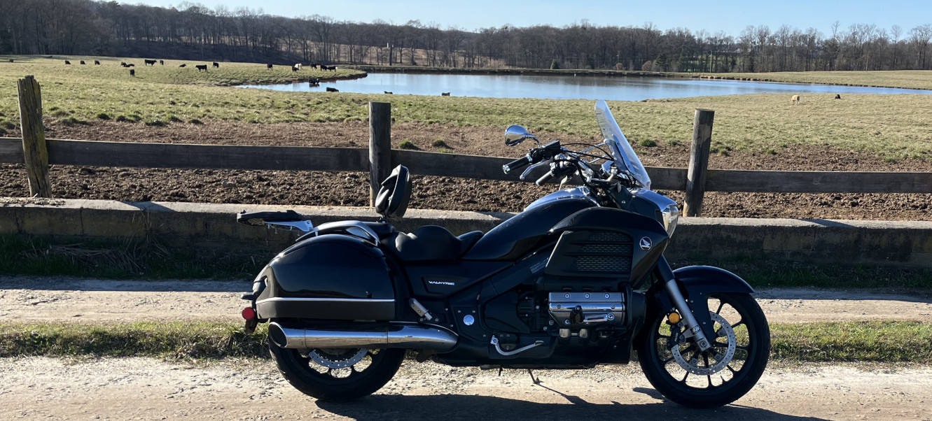

I would like to request, please, that you might post a beauty pic showing the whole bike, when you can, including the new mods of course.  Thanks for posting.
Posts: 16834
« Reply #6 on: January 21, 2015, 07:06:04 PM »
I lost the picture for this post. Here's one from 2024...

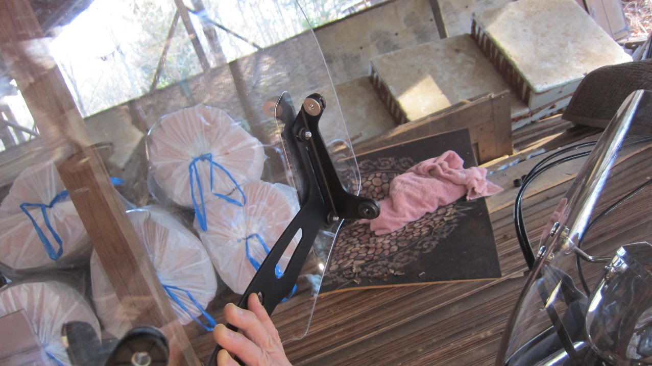

Also, as you mount it low over the front parts (like a partial fairing), it seems that a gradient tint black on the low part (like Memphis shades) would partially hide some of the parts you would like to hide (per your earlier posts).
Just got back from a comfortable windy ride... studied the shield some more, trying to
think of what would make it just right....
The hateful OEM windshield is just the right size and is only hateful because of the
straight up-and-down way Honda mounted it. It has a nice chrome bracket on it.
I held it up in front of the Hellcat, if it could somehow be mounted at fork-angle,
it would be just the right amount wider and taller. But there's no way the Hellcat's
mounts would work with it. Two sets of Hellcat mounts probably would, though. If
the rods were a little longer.
I measured the rods... .38 inches... that's 3/8 inch...
I just ordered a replacement set of Hellcat hardware and 72 inches of
3/8 inch stainless steel rod... if it works, it will still be handlebar mounted,
but the hardware and shield bracket will all be "factory made"... Hellcat
hardware is pretty nice I think, and almost infinitely adjustable...

Hey, Hub ...
I modified the rake of the windscreen several months ago, too.  If you do a search you'll see how I did it and some photos of how it looks.
It's in the same/same plane as the front forks.  I look over the windscreen, there is air coming from under the front of the screen to my chest area, less buffeting than oem, more hand/arm air, too.  Cost was Zero !
Check it out.
Nice work on your New Valk, Hub.
I saw that... with my handlebars, I had to ditch all the OEM mounting hardware... I got mine
mounted today... I'm looking through it, so I'll probably not be happy till I cut it down a little,
but a bit at a time... I got started on mounting the Givi trunk today, and I have to hook up
my heated gear plug in...

Posts: 16834
« Reply #18 on: February 17, 2015, 11:25:57 PM »
now if you could do something with those ugly looking rat pods
It will always be a stripped down Goldwing. Changing the radiators is
beyond me. I ordered the Corbin bags the other day. Now that the
bike is comfortable I find myself daydreaming about riding it...
-Mike "instead of daydreaming about burning it  Smiley "

A couple of people have looked at this thread recently, interested
in seeing the details of how I tried to make my Valkyrie comfortable...
A couple of details I might not have emphasized enough... multiple
windshield readjustments and fiddlings... the windshield is in pretty
good shape now, I'm real happy with it.
I made all the control cables and wires and lines nine inches longer.
I probably could have gotten away with seven inches, but if you make
them too short, you're up the creek. I perceive no problems with
nine inches...

Some folks here seem to like their new Valkyries fine, I hated mine. I knew it
was an awesome bike the minute I test rode it, but I found it almost impossible
to make it comfortable.
Here's what I did... I'm leaving out the many less radical things I tried that
didn't work.
risers.

Posts: 16834
« Reply #32 on: September 13, 2015, 06:08:31 AM »
Wow, a lot of work but I get it.  I probably not as tall as you. I want my bars to come back at least one inch.  Height is OK.  Do you see a solution for this?
You'll probably have to change the risers to something like I have.
If you don't, whatever different bars you choose will probably not clear
the key at some point as you turn the bars from lock to lock. Another 1800
rider (bscrive) made his own radical handlebars that cleared the key without
changing risers.
I'm just 5-11... If I ever find a set of bars that are pretty much like 1500 Valkyrie bars
but that have an extra inch of pullback, I might give them a try... I extended all the
cables and lines and wires 9 inches, and I have a little left to work with. The way it is
now, though, is extremely acceptable... OEM bars, both 1500 and 1800, have the little
knobs on them that hold the OEM style tie wraps, and they have little holes in them
in the right places to register the tabs on the control boxes, I like that pretty much and
wouldn't want to have to work around their absence... the little holes on the 1500
bars were almost in the wrong place, but I have my control boxes and their associated
lever perches placed pretty comfortably.

« Reply #33 on: September 14, 2018, 08:17:49 AM »
September 2018...
Mods: Russell seat, big handlebars, Traxxion forks and shocks and steering head bearings, Corbin bags, Utopia backrest...
I got a two-inch-shorter (seven inches longer than OEM) set of throttle cables made and installed them, nine inches
was too long for the throttle cables...
I have two sizes of GIVI top cases, they're only on the bike for trips...
I still imagine the handlebars being a little different... I never measured my Valkyrie
handlebars while they were off, I found these measurements on the web:
diameter:1"  height:6"  width:33" pullback:14"  center:9"  clamp-area:3" x 5"  part-number:53100-MZ0-000
While riding I paid attention to the slightly different place and angle I wished
my hands were at, and using the above measurements I think I might try these
32″ width, 5″ rise, 15-1/2″ pullback Yamaha handlebars: Baron Custom Accessories  BA-7308-00
I'm not sure what makes them "Yamaha", but they're one inch bars...
« Last Edit: February 16, 2025, 09:36:07 AM by hubcapsc » Logged

I am in the market for highway pegs and wondered which ones you bought? You are very discerning and I would appreciate knowing what you decided on.
Posts: 16834
« Reply #35 on: September 14, 2018, 06:04:08 PM »
Heaven help us... I started with these:
https://www.amazon.com/dp/B00CQ7W0Q2/ref=psdc_404667011_t3_B000XY6XMM
Then I tried the medium length arms, then (now) the long arms...
http://wingstuff.com/products/3443-short-4-5-or-6-inch-arms-for-ergo-pegs

Posts: 16834
« Reply #37 on: September 15, 2018, 05:11:46 AM »
Thanks for the offer Brian... I need to try lowering the
handlebars I have a little and maybe also adjust my
backrest to scoot me a tiny bit forward, that might do
what I want... I'm just thinking out loud about different handlebars
for now... I was even looking at the helibar web $ite, they have
a 1 inch cruiser/bagger bar. The way you can turn the handgrip
part of helibars out at arbitrary angles seems pretty useful...
People still look at this thread occasionally, so I wanted to add
the updated picture to show that the handlebar change has worked
for me in the long run...

« Reply #39 on: February 16, 2025, 09:55:23 AM »
2025
I guess people might still look at this thread, it's been looked at 11,000 times.
I just noticed all the pictures were dead due to yet another out-of-my-control
innernet reorganization. I pointed all the image links in the thread I could back
to hubcapsc.com, the images will stay there until the lights go out there.
I still have both Valkyries. Never any trouble with the modifications to the 1800.
Been all over  cooldude ...
