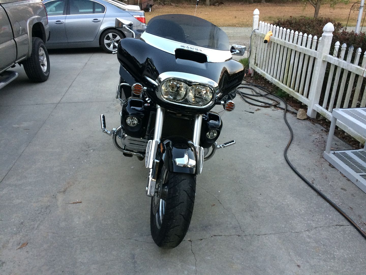

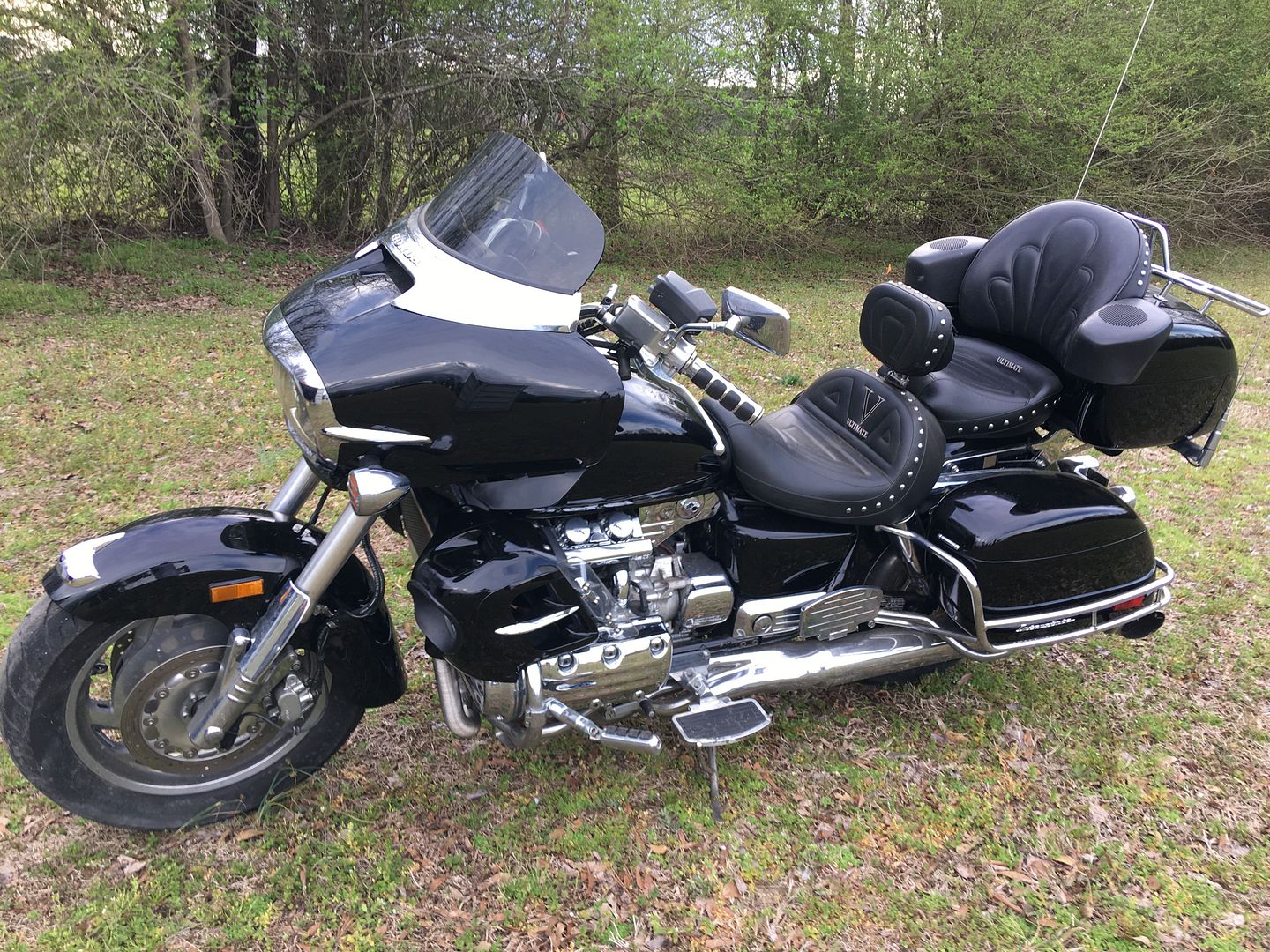

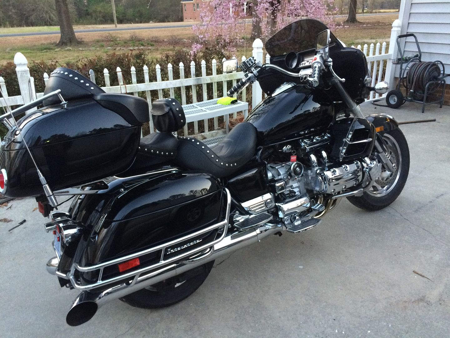

Well, after lots and lots of tinkering and multiple orders of miscellaneous parts and screws and missing this and rusted that, we are getting closer and closer to having it exactly like I want it. (haha  NEVER)
Replaced windshield yesterday. Painted the little vent wing thingy's. Pulled the studded ultimate seat off my standard and put on it for more comfy riding.  Still have to replace the speakers because they suck, replaced battery yesterday, forgot to order one dang fairing screw last order I placed, so have to order that, and then it is on to CHROME!
So now, grand total in on project is right at $1600 on bike and parts.  Another 400 spent on new tools (motorcycle jack/lift, odd size sockets for engine disassembly, parts to build the digital engine synchronizer).
AND, already put over 1,000 miles on her!!  Looking for more good weather today and tomorrow too!
« Reply #89 on: April 02, 2015, 04:19:38 AM »
You did good ! It's a beautiful bike  cooldude
Posts: 6794
« Reply #90 on: April 02, 2015, 04:37:17 AM »
What a great outcome cooldude
She's a good looking ride. Cool

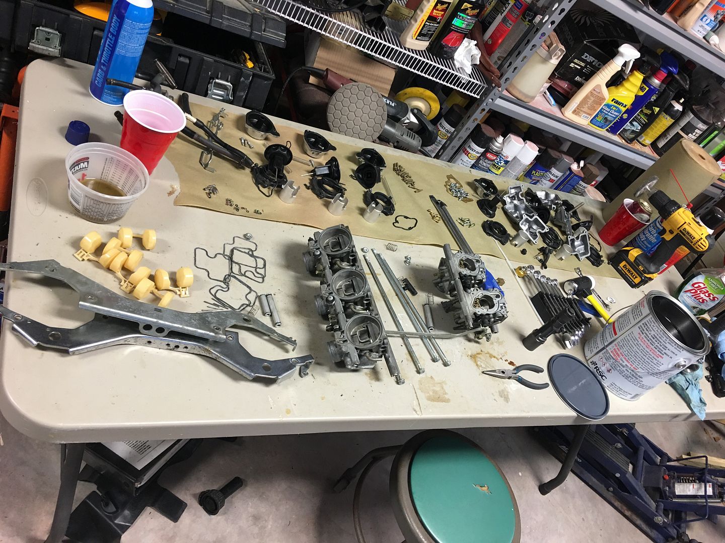

Carbs are coming apart fine.  They were much cleaner than I thought and nothing was stuck anywhere.  Never using ethanol has its advantages.  Only having 2k miles since it was done last helps to.  I probably could have gotten by with just a good chemical cleaning and then workmen on the fuel tank and getting new gas in, but, while they are out might as well get it done right.
Bent AtticRat's ear for about a half hour today and ordered a bunch of parts from Redeye Rich, so for now, just cleaning in the next few days.  Man there are a bunch of little parts here.  I usually wind up with no more than two or three parts left over on a project.  Guess I am going to have to figure out how to wind up with zero left overs on this one.

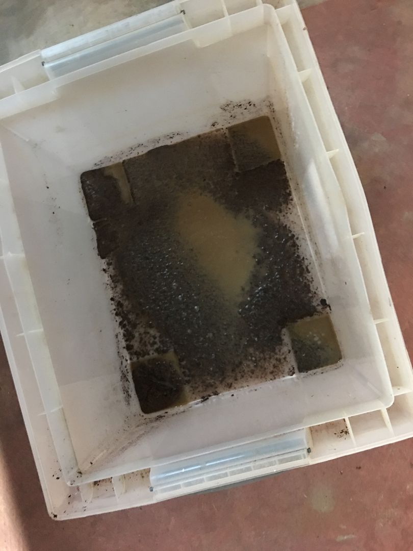

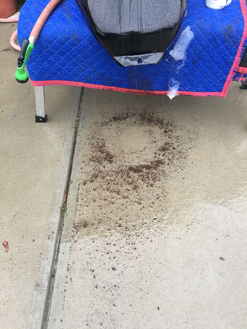

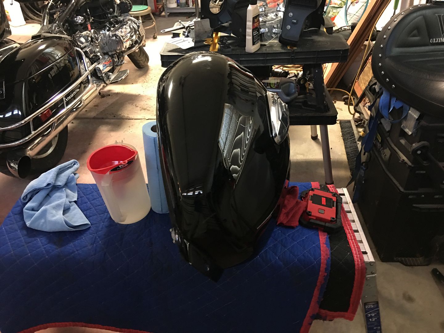

So, this tank was nasty.  Here is what came out win the first dawn and hot water wash down of the interior.  The corners of this container are about a 1/4" deep and are completely full.  Hopefully the paint stays on her.
After the first cleaning I did it three more times emptying it out on the ground.  My soils should have some high iron content in them now!!
Right now keeping her rotating with 2 gallons of Evaporust in her.  Will dump that out tomorrow and hopefully see nothing new come out.
Now to sit and wait on the mail to get all this new carb parts in.  I think I might be time to go fishing for a day or two.
