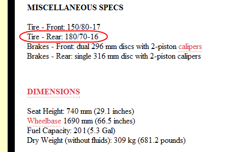

180/70r15
Is that the correct size?

180/70-16 or some (including myself) run the 200/60-16...Jim

The size of the rear tire is easier to remember if you use the 8-7-6 mnemonic (180/70-16).
