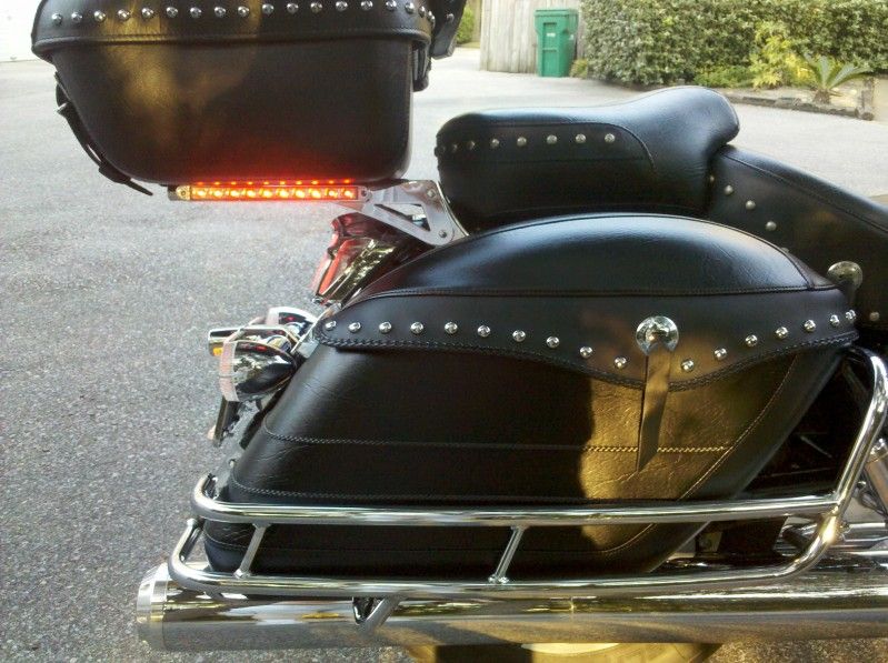

Tsukayu Jumbo strongs on Valk,, outrageous amount of storage and good quality. I put additional bracing front and rear and side rails for tip overs,, really happy with them.

I would certainly be one of those guys,,, it was a process to get mine mounted where I wanted them and they would have been beaten and scratched up if they had been painted first. Because of the way they mount, you may want to consider some extra bracing and protection for tip overs. I took the time to cut some pieces from aluminum to clad the back inside and out to keep it from breaking out as easily when the bike is dumped. The bags are mounted through the back with four bolts only, and while the fiberglass is pretty heavy, it will crack and break.  I purchased mine from eBay off a wrecked Boulevard and got to see first hand what can happen to them when only the supplied mounting hardware is used, luckily they were made good enough that they were repairable with a minimum of effort.
After I had the bags where I wanted them, I started with just two holes (one previously drilled from the original mounting) then used a cardboard template to get everything in line. After I had the height correct, I fastened one each, front and read rear mount, then worked the bags back and forth to get the final position I wanted and marked the two other holes. I am happy with the final product and the bags are super for form and function. If I had a complaint, it would be the cutout that is molded into the bags for shock clearance,, it does not fit our bikes, but is acceptable to me.

Looks good Pancho!  cooldude
