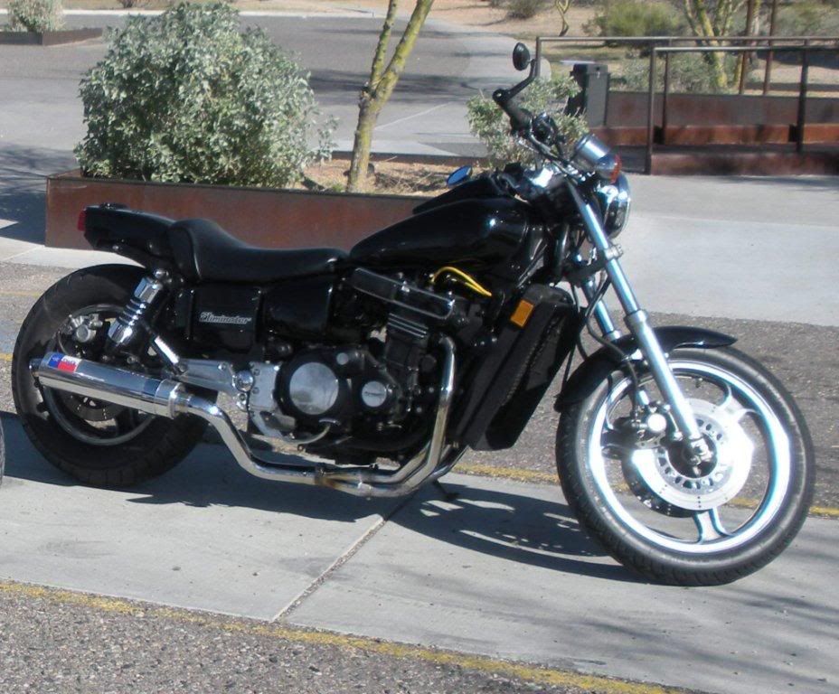

Here's my recently-departed ZL900.  (Please don't ask me what happened to it...<sniff>)
« Last Edit: June 11, 2015, 06:56:25 PM by desertrefugee » Logged
Nice Eliminator Desert Ref. Looks like a similar look to mine.

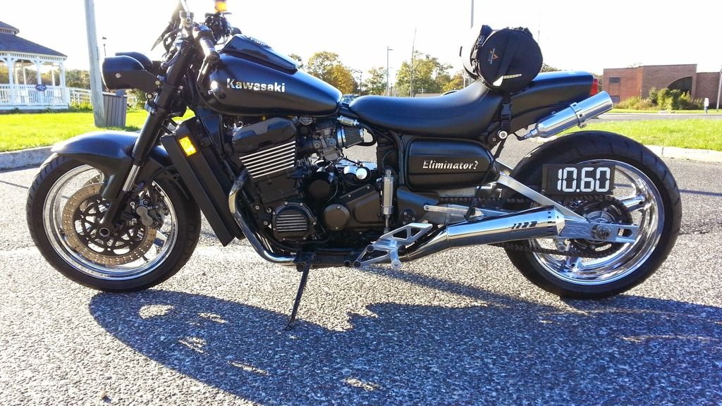

« Reply #29 on: June 11, 2015, 07:35:25 PM »
Yeah.  Minus the stretch, the 1200 and the 10.60.   I never broke into the 10s on either of mine.  The first which I bought new in Florida stayed pretty much stock.  The one above just had a 4 degree advance, Dyna ignition, jets and the D&D.  11.30's was the best it ever did.
 Angry
You have a really wicked ZL there.
« Last Edit: June 11, 2015, 07:40:31 PM by desertrefugee » Logged
