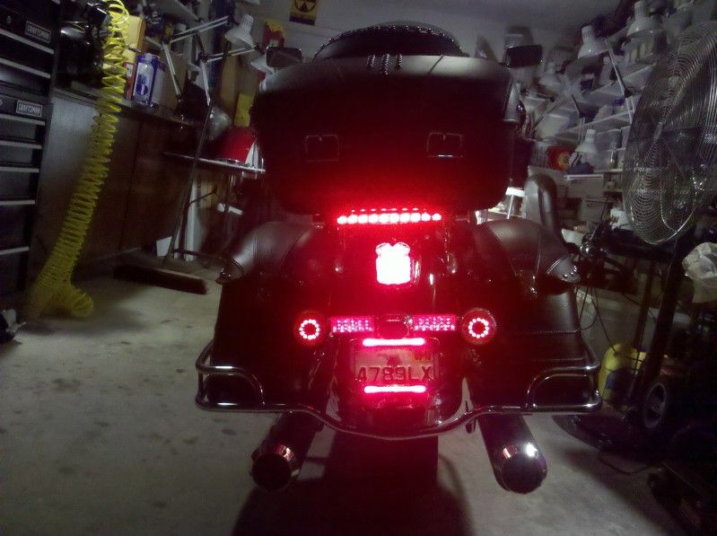

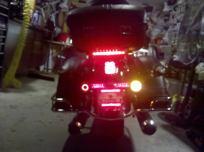

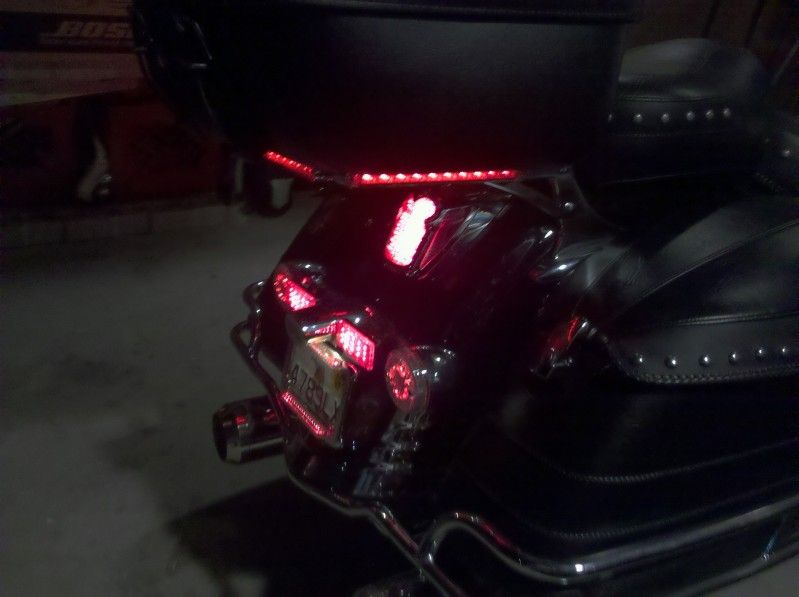

I have the Radiantz led tail light with clear lens for the tail light.
I replaced the stock red reflectors with red leds/reflectors from Big Bike Parts (see my sig pic).  They look like the oem red reflectors, but are really leds.
I did the Electrical Connection run/brake/turn kit in my turns with clear lenses.  They're red run/brake and amber turn.  Since I have clear lenses, I installed amber bulbs for the turns.  The led part shines red through the clear lens.
http://www.valkyrieriders.com/shoptalk/ledturnsignalmod.htm
I added a license tag holder with red run/brake led with clear lenses at the top and bottom from Custom Dynamics.
On my trunk, I added some led light bars with clear lenses on the trunk rack that the trunk is mounted on.  The sides are just wired for run....and the rear is wired for run/brake.  Got them here.
http://www.bigrigchromeshop.com/10-led-inch-light-bar-bezel-p-7100.html#.VYXdw_3bKcM
« Last Edit: June 20, 2015, 03:36:40 PM by BF » Logged
