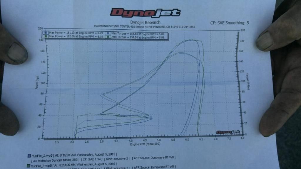

Ryan is at Sturgis this week and he decided to throw the Valk up on the dyno for our entertainment purposes.  And what a monster it is!!!! If you happen to be in Sturgis make sure you ask around and find the Turbo Valkyrie and take a peek....
at Sturgis elevation, 182 hp and 158.5 ft. lbs of torque

How much boost ?

How much boost ?
12 psi, completely stock engine except for heavy duty clutch spring (stock spring slipped clutch above 8 psi), completely stock ignition system, and runs on 91 octane pump gas.
this dyno pull was with 91 octane pump gas...

How much boost ?
Can You tell me what brand of heavy duty clutch spring (part number)... ?

How much boost ?
www.barnettclutches.com
Part# 502-00-00028
