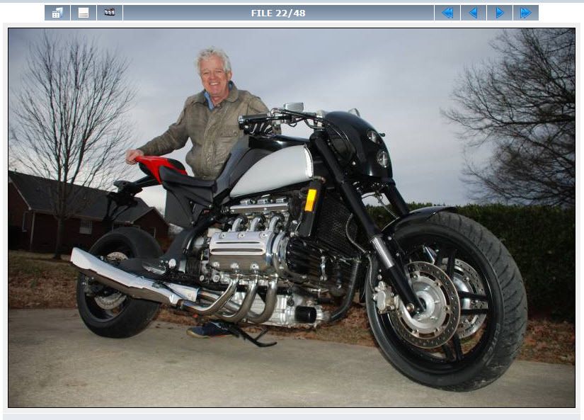

Found this pic on the Featured Pic of the Day today.
Anybody know who he is?  I'd love to chat with him about that 1800 (I think) swingarm, and the obvious, but elegant looking frame mod (on the right side) to allow the swingarm to clear.
TIA

Cruise over to the Ohio regional board and see if Bones/Wicked Wanda or Murdoch can put you in contact with Skull (Alan). He did what you're attempting to do. That pic may be of his father and his bike, but it's been so long since I've seen any of them I can't remember.
« Reply #2 on: October 20, 2015, 11:58:43 AM »
I think that bike got sold on Ebay about a year ago.

This bike was in Monroe NC...The guy in the picture built it....It started life as a 98 tourer. The build was done when the bike was nearly new.
He worked at the local dealership and with help from others did it after hours in the shop.

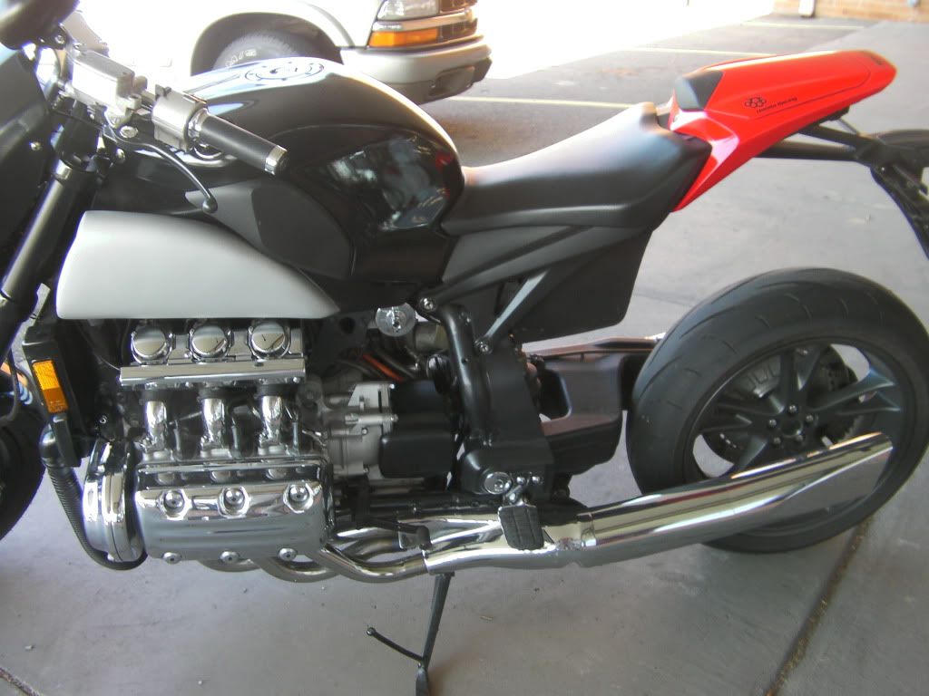

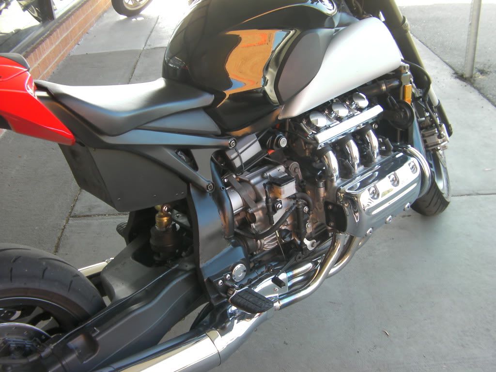

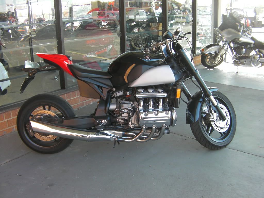

« Reply #6 on: October 22, 2015, 08:46:05 PM »
Detn8er - Thanks MUCH for the pics. Very handy to see how others solved the conversion issues.
Some comments, as I think out loud.
The vertical member where he reinforced the tube above the swingarm pivot was to provide a place to weld in a crossmember for the top shock mount.
His top shock mount is pretty low - mine is about 8" higher, using the frame rails as a mount.  I'm not sure that is a stock shock, as I cannot see any linkage underneath, nor the Honda hydraulic pre-loader.  Any other pics?
He did not move the swingarm pivot, but it sure looks longer - must be an illusion due to all that air above the tire.  Certainly enough room for wheel travel!
He also appears to have the stock ride height, based upon the stock looking sidestand.
I'd bet he whacked off at least 50 lbs, prolly more.
All in all, a well thought out project with some good engineering.
