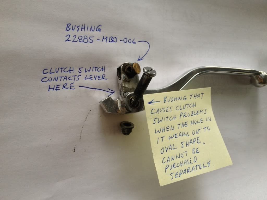

Nope, that's not what that particular bushing does.  See the photo below.
Up and down play is caused by wear in the pivot hole in the lever.  On the OEM levers, that hole is in a bushing that is pressed into the lever, and cannot be bought as a separate part.  Maybe it can be for Britman's aftermarket levers, but I'd be surprised.

« Reply #6 on: December 11, 2015, 07:03:27 AM »
http://www.bronzebushings.com/sae-841.html?cat=838 AM-812-16 SAE 841 Sleeve 8 mm ID x 12 mm OD x 16 mm OAL
These would work but they are .080/2mm shorter. Stock length is .707/18mm. Could order 2 10mm length and trim to fit. Easily done in a drill press.
