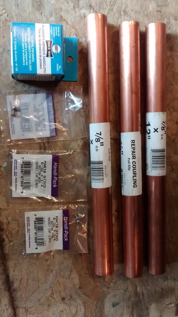

davit
#7
The simplest way to extend the piggies is with repair couplings.  And the longer they are the quieter.  Not sure this is what you're after, but maybe you could cut the piggies drill the rear baffles for increased sound then install these couplings.  Just be sure they extend slightly past the end of the stacks so they don't drone.
