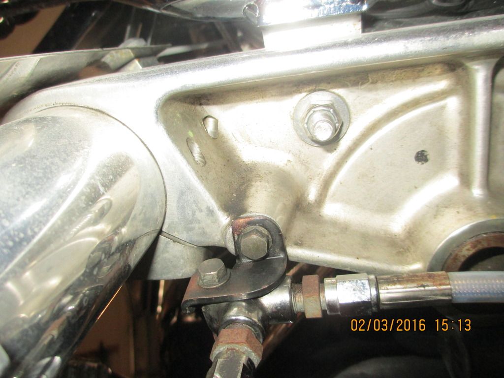

John , did that block on them mount to original bracket ?
Posts: 15323
« Reply #8 on: February 03, 2016, 08:29:00 AM »
Bagger good to hear.
Yes, there's a little mounting "stay" used on the OEM system at the right front distribution block, I reused that. Mounted it in the same spot and bolted the Russell block to it. I'd take a picture but then I'd have to clean it first.  Grin

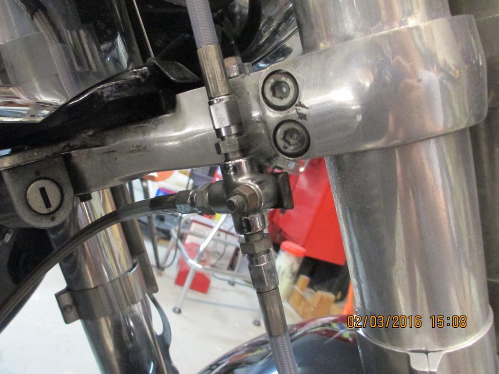

Please post the "dirty" pic as I'd like to see the setup.

OK, here 'tis, you forced my hand so I got out a rag and toothbrush. Hope the taste goes away by morning.  Lips Sealed

Ha ha. Funny John. So is the hose going to the right a short crossover like original oem or does it travel down to the caliper ?
Posts: 15323
« Reply #12 on: February 03, 2016, 05:06:41 PM »
It goes directly to the caliper, no crossover like the OEM.

Russel is only a 3 line setup but only 2 parts. The upper and right caliper lines are permantely affixed to the block and then you attach left caliper to the block. I got mine installed and looks good. I don't have any flopping around. Comes with a line support that replaces the larger ones from oem.
