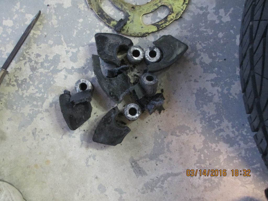

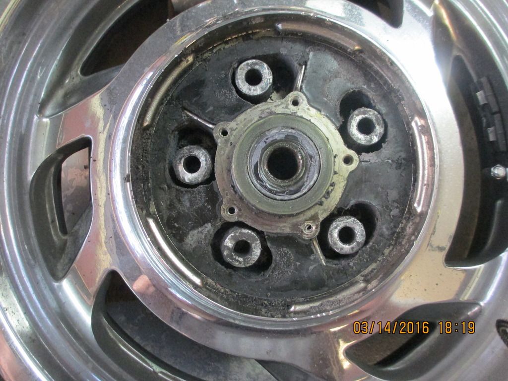

These are used but a little Gorilla glue should put you back on the road, you pay the shipping.  Grin When I laid them out next to the new one I noticed a slight difference so decided to go ahead and replace them. Wink I'm really blown away by this, they're Honda items and don't have more than 12k on them. I've noticed recently a lot of slop in the driveline and a noticeable loud click if I shifted under power/acceleration. Now I know why. Thankfully I had two spare sets in my stash. I had pulled the rear wheel to replace the tire, good thing I did. The splines look OK, will know more after a good cleaning.
Can you tell the difference between the old and new?   2funny

Wow, John, I've never seen any that were that dried out and crumbled. You must have really gotten some from a bad batch!

Now that I saw this, I'm a little concerned. LOL. Had my valk std for about 5 months. Haven't removed the wheel yet. But when I do, I want to replace every thing I need to in there. What is it I need to replace and where to buy. Just planning ahead. Thanks all.

Those sure are toast, any chance they were from "shock bushing Gary", he had a bad batch sometime ago.
3 o-rings for sure.  I always have a set or 2 of brake pads, dampners, bearings, etc just in case I need them for reassemble w/o waiting for the mail.
Do you have a Honda shop manual?  Go thru it a nd list what they suggest you replace and there are many OEM parts supplier's on the web.  Some items they suggest replacing I concider optional, like rotor bolts, but some feel the need to follow the book. I've reused rotor bolts several times w/o issue, just careful not to over tourqe.

What it looks like is that they were attacked by a solvent that destroyed them. I wonder if you cleaned the wheel up with something before installing them new, or used something for lubrication to ease installation into the pockets?
Sometimes it only takes a small bit to affect a large thing if it is specific.
That actually was my first thought....what did I use for cleaning?!? But when I installed them a while back the pockets were clean so all I did was wipe them down, no solvent needed. However, I did try some different lube this last time; Loctite moly paste(see link). It's metal free, contains 65% moly. Could that particular compound give off some damaging fumes or residue under the heat of operation? I'll never know because I'll not use it again even though the splines appear fine. These actually were a factory replacement for a set of Gary's dampers which I had no trouble with but were starting to fit a little sloppy in the pocket where they sit. I'll go back to using the lube concoction I've used in the past and "schmooie" (a borrowed technical term  Cheesy) it on as usual.

Are you sure the bad dampers aren't Gary's dampers?  In the first picture they look like the wheel was used as a mould to make them, just like Gary's dampers.

Yeah, that locktite moly paste is good for the splines and flange, but because it has petroleum products in it, not the best choice for a rubber like compound. That is probably the culprit. Sometimes a small bit of contaminant can affect a large item if the chemistry is correct,, or I should say, incorrect.
Not quite the same but, 1/2 gram of potassium cyanide will destroy a 160 pound person.
Absolutely sure, these replaced Gary's which as mentioned.....had started to fit a little loose. Goes without saying....it took a while to get the wheel cleaned up but the new ones are in and the plate torqued down. Tomorrow I clean the final and wait for the new tire to get here.

Those sure don't look like OEM...and do appear to have the same make up as those of Gary's.  Those just don't look right at all....

John my Gary's dampers were that bad too.  I posted pictures last year.  There was a lot of slack in them too. Smiley
I assure you, they're OEM right from mother Honda. Whatever it was that penetrated them caused them to eventually crumble like a dry cookie. I only had one set of Gary's and had nary a problem with them, but they eventually felt like they were fitting a bit loose so as stated earlier....I replaced them with factory parts. I was blown away by the consistency of them when I started to clean it all out. They literally crumbled when you squeezed them with your fingers. Oh well, it's all clean now, the new ones are installed and the plate torqued down. My new Kuhmo 195/69r16 arrived today so will get it installed by Friday. Still need to clean the final of all the debris from the dampers plus the grease left over. I'm tempted to pull the top cover off the final to expose the innards just in case any go through. Not a big job and would give me some piece of mind. I'm really liking the looks of the new Kuhmo, nice and rounded on the shoulders but still has a broad footprint. I plan to take a couple pictures of the old 205 and the new 195, just for comparison and viewing.

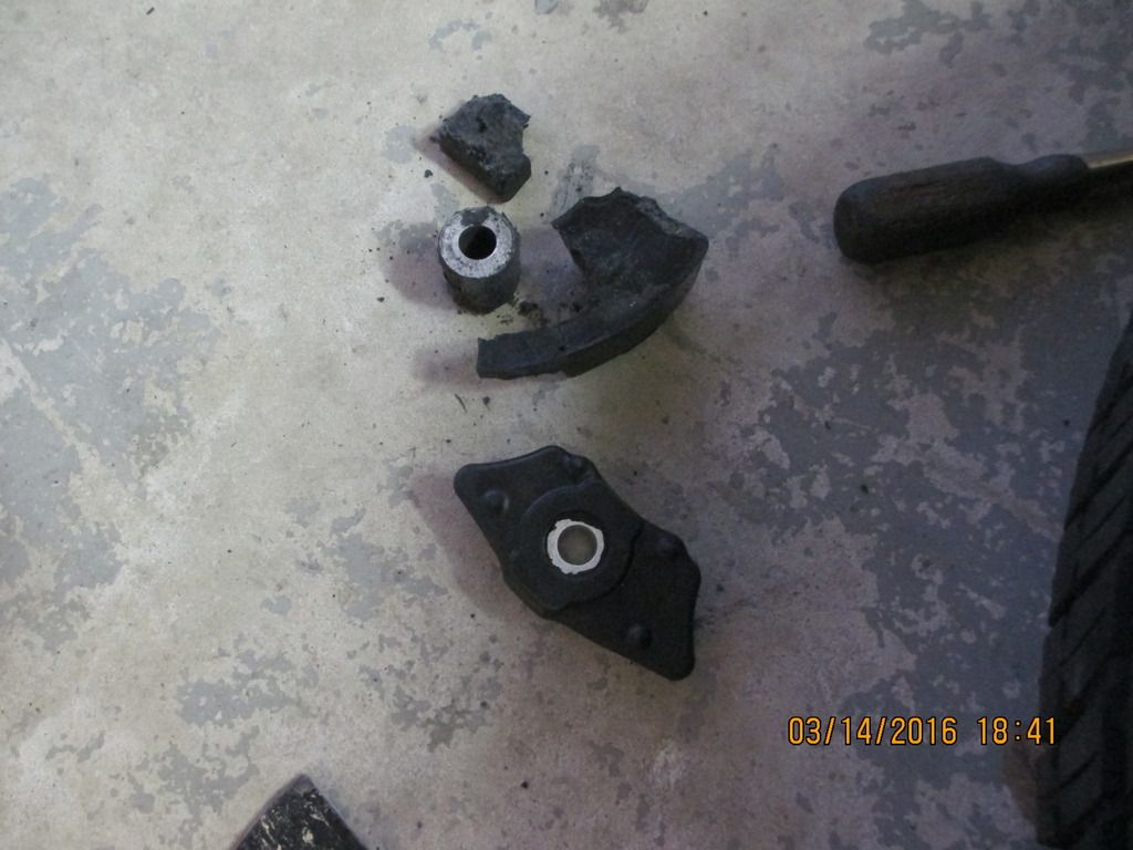

« Reply #21 on: September 29, 2016, 08:43:09 AM »
Hmmm... the Honda ones don't have "tubes" for the aluminum
inserts, they have these little winged frobs - you can see the wings
at 7:00 in the lower picture... Gary's had "tubes"...

Yep they look just like the ones I found falling apart on my bike.
OEM look completely different.
