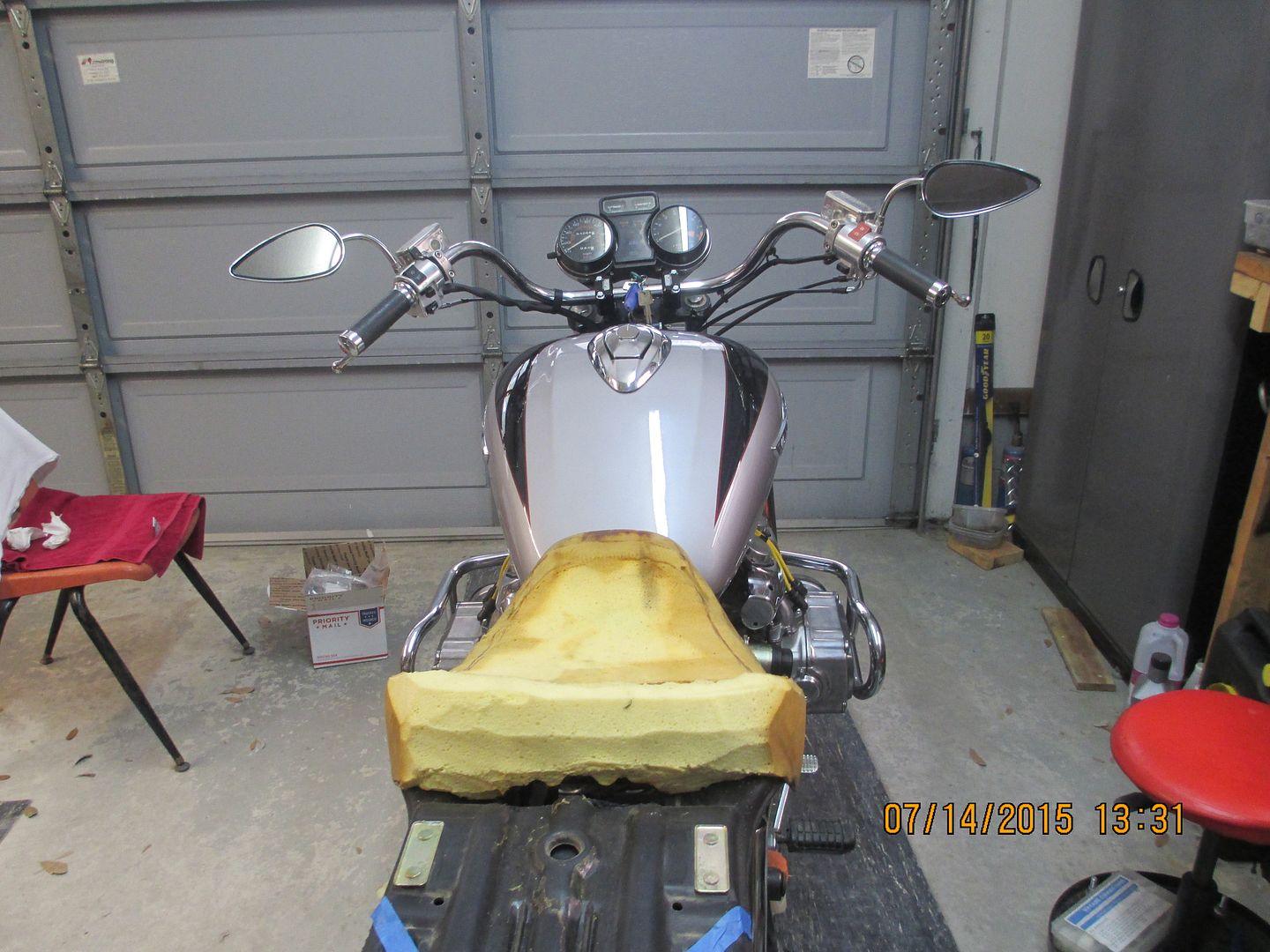

Baldo, re. the Valk tank on an old Wing, it's an '84 Std. I picked up as a basket case a couple years ago. The OEM tank was rusted through so it got tossed, never liked that set-up anyway. I found the '99 Valk tank on ebay for a decent price and it's almost perfect. I added an elevated bracket to the frame in front near the steering neck for the front tank bolt. At the rear, I added a flat crossmember with a hinge welded to it and a nut welded underneath. That's for the rear tank bolt. Now, if I need to check fuses or access the air filter, I simply unbolt the front and tip the tank up. I had to split the case and replace a piston/rod...swallowed a valve. Did some repairs to the frame and rebuilt everything so far; forks, final drive, all calipers, new tires, fuel pump, has Valkyrie bars and controls, SS overflow to replace the OEM plastic junk, new wheel bearings all around, new SS brake/clutch lines, Valk shocks(OEM were 1.5" longer)....and now the front tire is flat for some fool reason.  Angry  When I'm ready, the friend that made my Valk leather apparel is going to build a seat for me. Should make it easier to sell.
Here's where I am on it at the moment, I'll be replacing the ugly OEM gauges with something smaller and more functional. Still needs all the lights except headlight.

Wow, that's a mouthful! That's going to look fantastic. Are you changing color or matching the tank?

Well....you asked. Grin It's difficult to tell a story by writing just one paragraph, so I expanded on it. Re. the color, yes....I was able to find a very close color match for the front fender so I figured I'd just paint the side covers and rear fender to match. At this point the engine is questionable. The #4 piston had swallowed a valve, reason for that was the belts were new but installed so loose I removed them without loosening the tensioners, that let it jump about 3 teeth on the left side. It scored the #4 cylinder wall pretty bad and I couldn't hone it all out so once I get it out on the street and see how it runs, then I'll make a decision on whether to replace the engine. I commented once that it's a love and attention project.....I'd love to be done with it. The only reason I got it was to have something to do when I'm stuck at home. My wife has health problems and spends the majority of her time confined to the house, no longer able to travel, drive, hardly walk most days, now weighs 92 lbs. fully dressed. That means I am also and this gives me something to do.

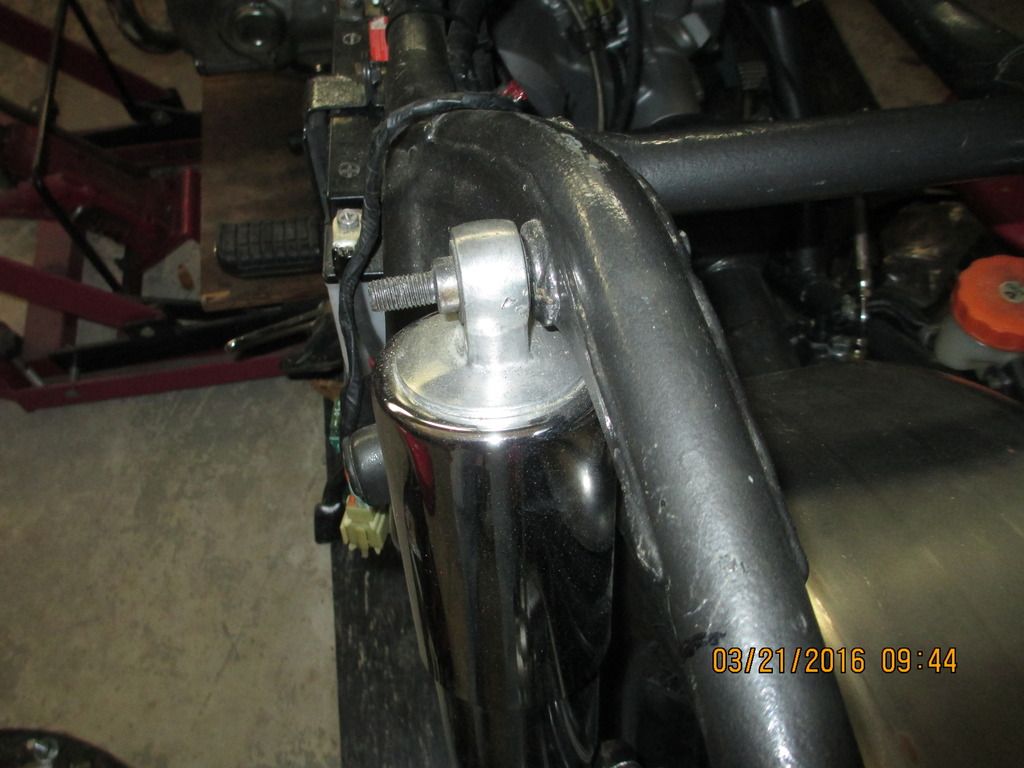

John, did you do any mods to get the Valk shocks to fit?
Nope, slips right in. There is one difference....the upper stud the top of the shock mounts to is longer so a spacer is needed to let you attach anything to it. I'll take a closeup pic, you can see the spacer needed isn't very big.
