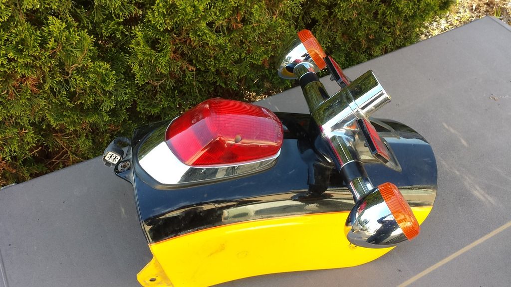

Gordon, The Standard/Tourer/IS have bullet connectors under the right side cover for the turn signals, but the brake on the IS is a plug connector. It is the 3P mini connector shown on this
schematic (click Link)
(almost dead center on the drawing).

7, 8 & 9 on the IS.
http://www.bikebandit.com/oem-parts/1999-honda-valkyrie-interstate-gl1500cf-wire-harness/o/m151389sch307109
Looks like 4 bullets on 7. Can't figure where 9 plugs into, for the brake lights (your 3 pin connector).
6 & 7 on the T
http://www.bikebandit.com/oem-parts/1999-honda-valkyrie-tourer-gl1500ct-wire-harness/o/m151388sch613765
Looks like 5 bullets on 6.
I know I have one, maybe 2, main wire harnesses for the IS. So I can cut one up.
I'm adding more, the rear fender brake light. Also have Hyper Lites to add. I might make the trunk removable, so also interested in the How-To. I just picked up my replacement rear fender last night.
