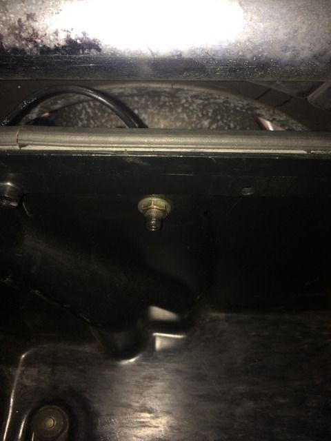

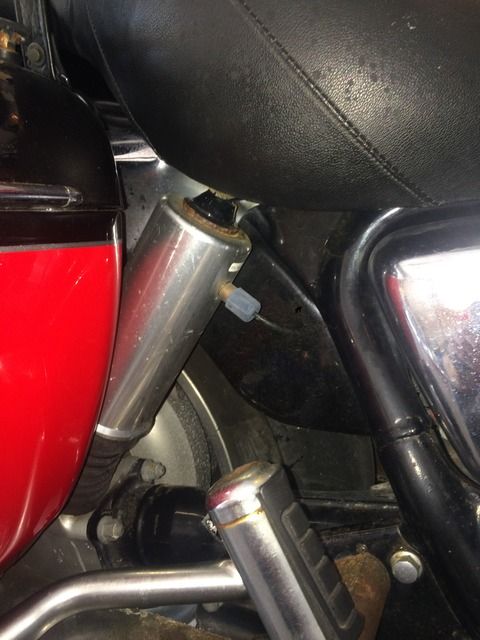

Just found out that I have air shocks on my Interstate.
Did they come from the factory like that or is this a aftermarket shock?
They put the valve stem in my left bag.

Progressive 416's, aftermarket. Had them on my Tourer when I got it and hated them. They can be rebuilt, and some swear by 'em.
http://www.summitracing.com/parts/pgr-30-5041
I think some have beefed them up by adding a bit more oil. MarkT comes to mind.

after market. the factory shocks on a I/S is non air.

Yup, Progressive 416s. I have them on my '98 Tourer and like them. Be careful of the plastic hose nut on the shocks. Do not tighten with a wrench. There is also two o-rings on the end of the tiny hose. Just be careful. There has been a lot of discussion of these shocks on this board. Search is your friend...

The Goldwing GL1500 has one air and one coil rear shock.
If you have 2 air, you might think about replacing one with a coil, and just use the air one to adjust for the load on the bike.

I seem to recall them having their best utility for guys who go through big swings of carry weight with gear, back seaters and/or towing trailers. But otherwise, there are better shocks available.
