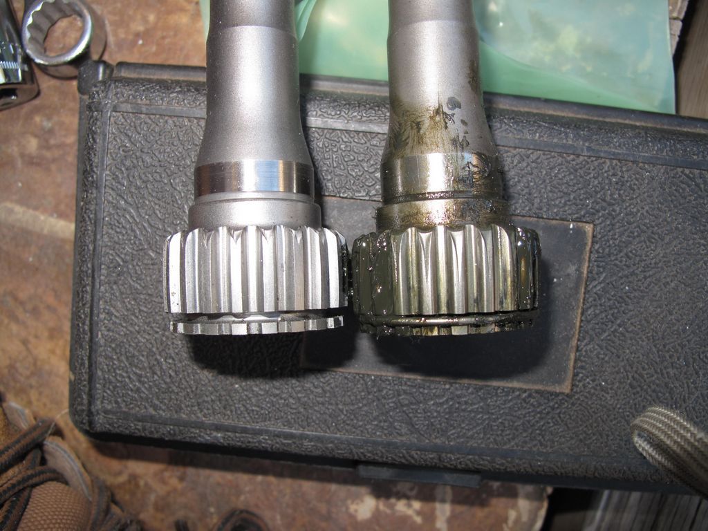

The bike has about 65k.  Replaced the u-joint maybe 2000 miles ago.  It helped...  a bit.  But it was not a solution.  Now it's getting worse.
Pulled the rear end and driveshaft.  Wheel flange is good.  Ring gear is good.  Engine splines are good.  Pinion gear is... almost good? .

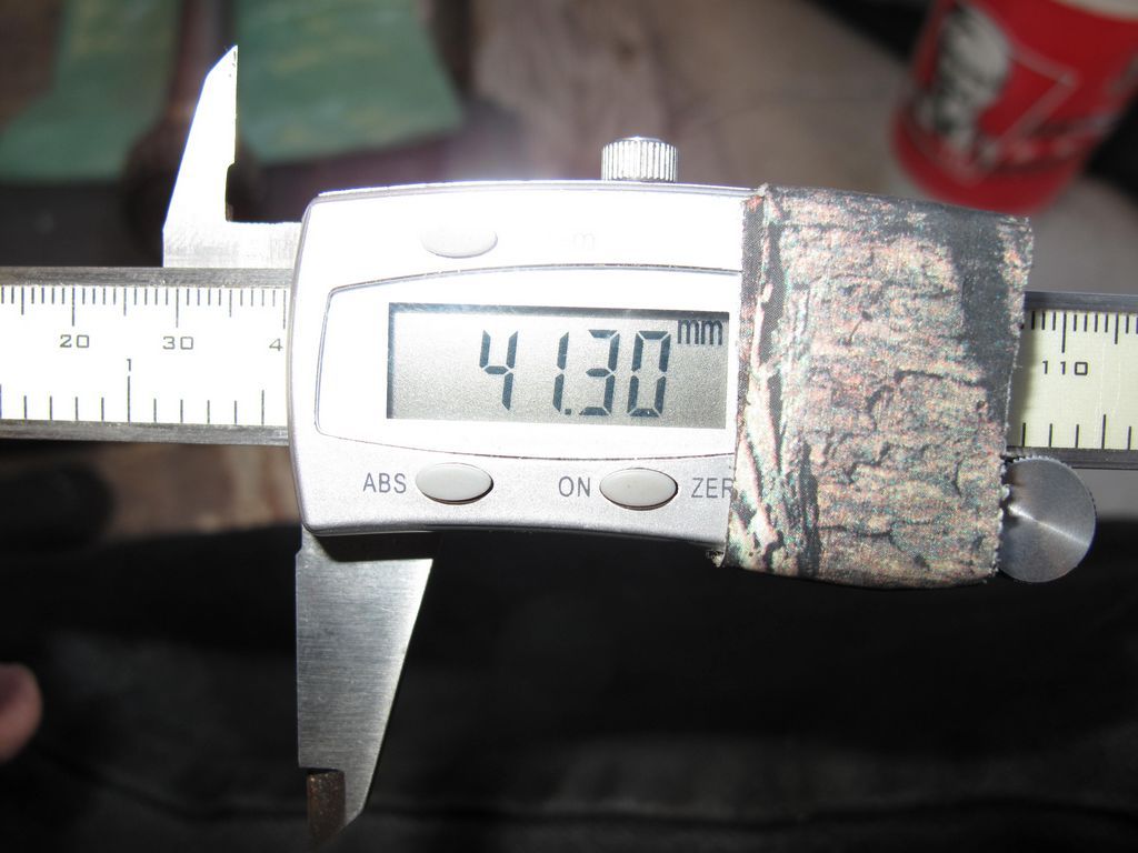

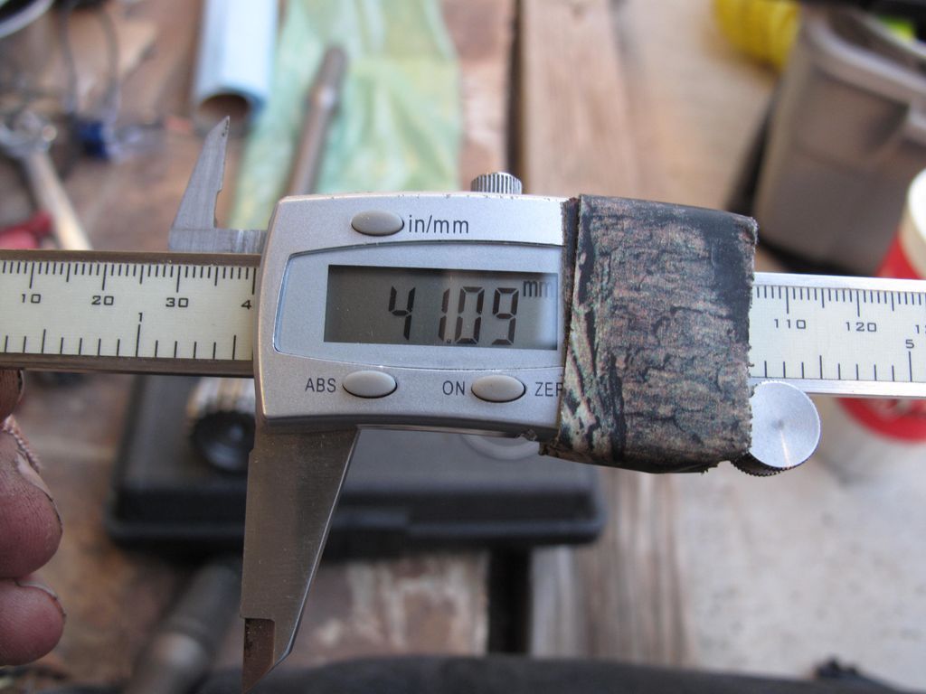

Lots of lube inside, but definite wear.  41.3 mm on the OD of the new splines, call it 41.1 on the OD of the used splines.
Can 0.2mm cause this vibration?  If not, I'm out of ideas... ???

It could be the lash between the ring gear & pinion since it occurs when the load on the drive shaft is reversed when decelaeration occurs and the gear teeth become loaded on the alternate side.
Judging from your picture it seems to me that the used pinion gear teeth are narrower / sharper that the new teeth. However, I'm not really sure of this from looking at the picture. If this is the case there is too much clearance.
Disengaging the clutch stopping the shudder further indicates this is a possibility.
See section 12-4 of the shop manual.
The foregoing is pure amateur speculation.
