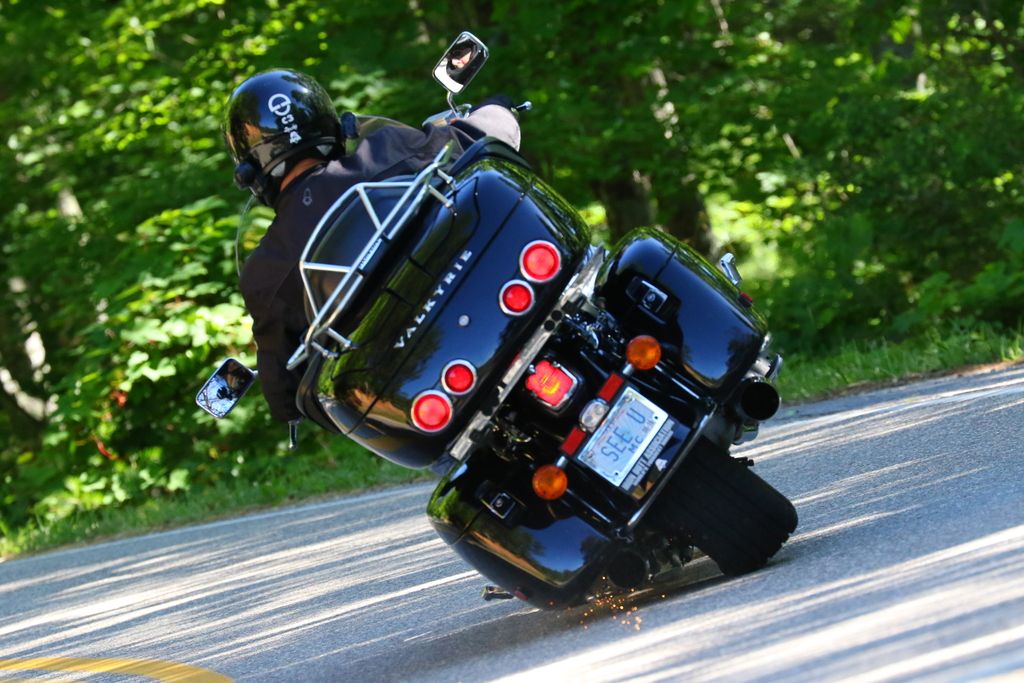

« Reply #13 on: June 30, 2016, 12:48:39 PM »
The Yokohama works well for me...
side view of the tire...
The Yoko in action....
https://www.youtube.com/watch?v=ibUAtyggAYs
« Last Edit: June 30, 2016, 01:03:38 PM by Mallett » Logged

Spectacular pics, Mallett!   Carry on, bad azz!   cooldude

« Reply #16 on: July 01, 2016, 04:27:22 AM »
Thanks, Valkorado...I was just sniffing the roses but I do try to give the guys something to take a pic of...they probably get tired of the hardleys riding by grinning & waving....Smiley

« Reply #36 on: July 21, 2016, 07:11:24 AM »
I have the Yokahoma, and I love it. I have about 6-7k on it so far, and just got back from riding the Cabot Trail with it. 3rd time on the trail, first time with a car tire and it handled at least as good as the bike tire did on the pavement and much much better in the loose gravel of construction.
For everyone that doesn't know what the Cabot Trail is, it is like the Canadian East coast version of the Dragon.
Not the crazy amount of corners, but most of the corners are marked for 30km/h and there is frequently a 500+ft cliff on the other side of the guardrail.
