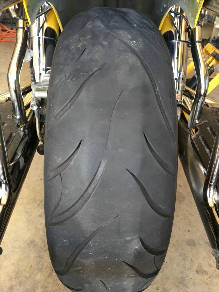

« on: July 10, 2016, 06:29:16 PM »
CORRECTION!!! I FORGOT THAT I DID MY BIG BEND TRIP AS WELL AS A COUPLE OF OTHER SMALLER TRIPS DOWN TO SOUTH TX AS WELL AS ROUND ROCK ON THIS TIRE. TOTAL MILEAGE ON THIS TIRE SHOULD READ CLOSER TO 7,000 MILES.
Put this tire on a month before Inzane and rode for about 1,000 miles before I left for Morgantown. Put on about 4k miles on my trip and bike has been parked since then. Started cleaning the bike when I got back home from my work travels this Saturday and discovered this. If I am going to get only 5k miles from the rear tire, I am going back to a CT. BTW, I've been running 44 PSI on the rear tires on both my bikes. Additionally, you can see the center of the tire has almost squared off.

Man, that is horrible miles for any cycle tire regardless of road conditions and how you drive.
There must be a reason on why jakewilson, etc. is selling the avon cobra rear tires for under 125 bucks since only a year or so ago were around that 160 mark on sale?  I got near 10K on my last one but am sure not as hard of a rider as most, but still, 10K is not great.
If you are putting that kind of miles on in less than one year,  a CT is the way to go no doubt, otherwise just throwing money out the door otherwise.

I ride quite aggressively, but even then I should get at least 8k miles from a rear tire. I switched from a CT to a MCT in the hopes that I would get between 8k-10k from a rear MCT. But if I am going to get only 5k-6k, then it's absolutely pointless in installing another MCT. I am going back to the Darkside, I just placed an order for the Yokohama Avid Envigor from Amazon.
What pressure were you running?

I did mention that in my original post. 44-45 PSI religiously. I check and top-up every time before I ride.

Check the date code on the tire. I get 4 times the mileage you get on a rear Cobra. 46 PSI faithfully

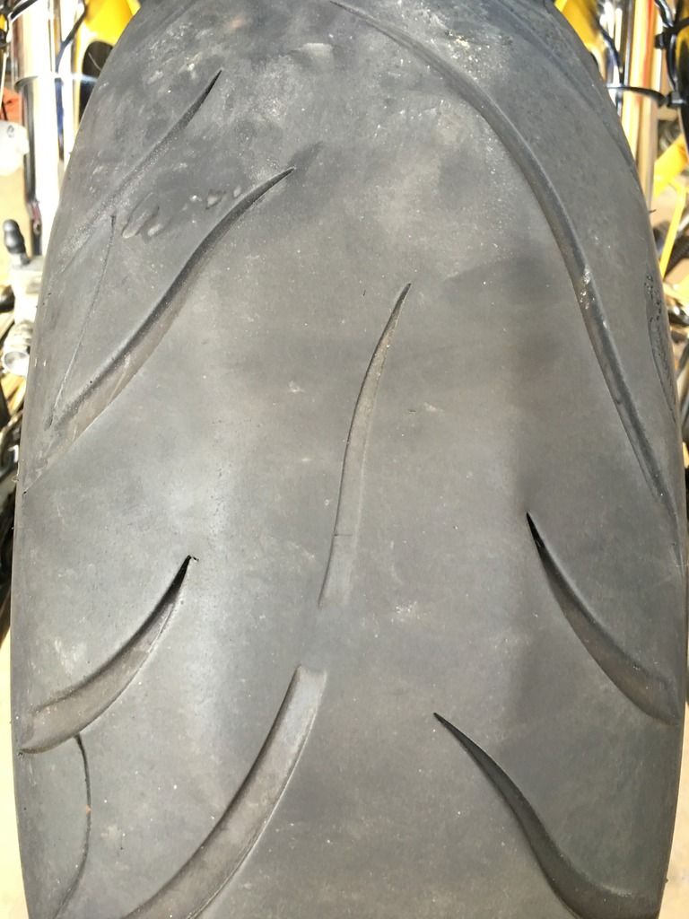

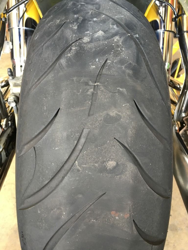

The reason I never ran Venoms was seeing too many pictures like that.  (and delaminations or build irregularities)
It is said the Cobras are better.
I could only get 8-9K (good miles) from rear ME880 radials, and always ran higher pressure, but of a dozen or so, I never had one look like that.  I'm on CTs now, forever.
FWIW, that tire looks like it still has miles left in it, despite the cupping.
