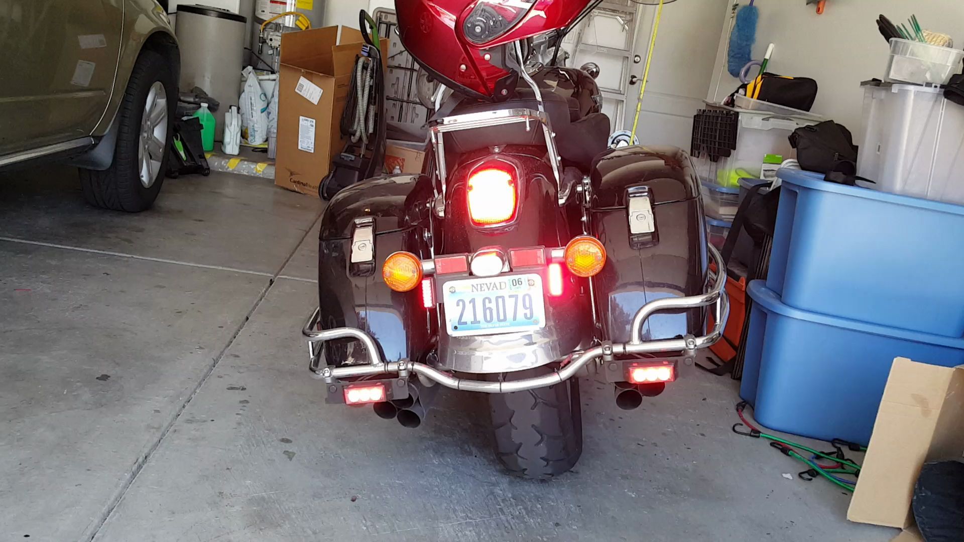

I was thinking of installing a strobe like LED brake light on my IS. Planning on using the infamous blank spot where the light were the tourer/standard brake light sits.
Just wondering if anyone has a suggestion where to get the brake assembly piece to fit in the hole?

sdv003
I took this approach.  (Hopefully the video works...)
Just buy the necessary Honda std/tourer tail light parts.  You can rig any module you want to it.  An 1157 bulb is brighter than any of the single trunk lights,  or you can get a plug and play LED array to replace the 1157.  When I want flashing, I just tap-tap-tap-tap-tap my hand lever.
Here's the parts list.  http://forums.delphiforums.com/valkyrie/messages/?msg=11596.1
