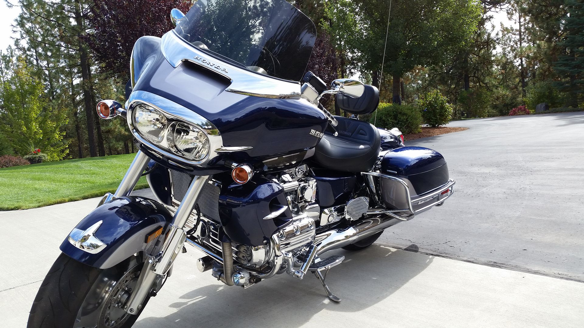

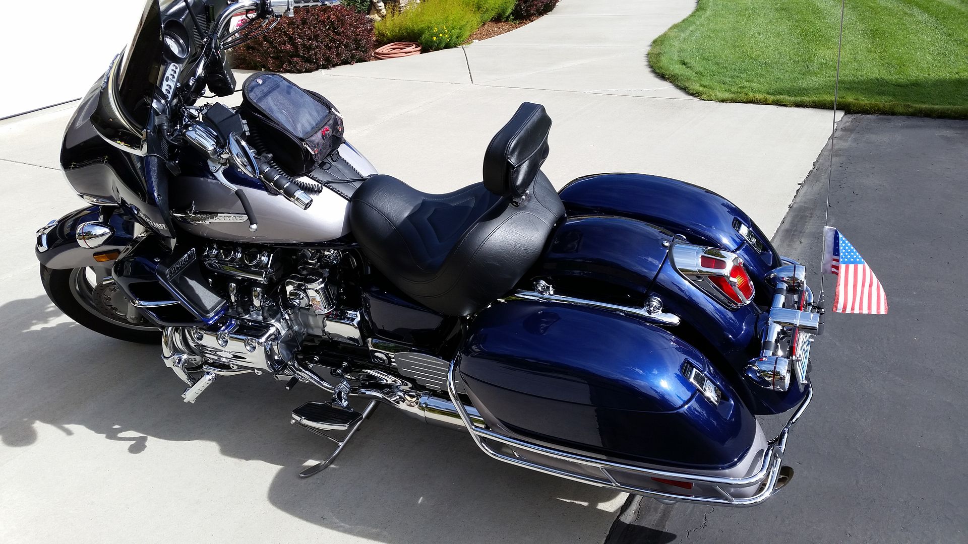

Finally got a chance to get some pics.
For now I'm using the OEM radio antenna and my Midland portable CB. Eventually I'll probably bury the OEM CB in the tool compartment area under the seat. I'm also considering using only one antenna for both radios. Sierra Electronics has a system that I'm considering.

Where did you get your saddlebag rails? Are those the Hondaline Unobtainiums or a recent purchase?
salty1
Posts: 2359
"Flyka"
Spokane, WA or Tucson, AZ
« Reply #12 on: September 22, 2016, 08:03:55 AM »
Salty1,
Sorry for being late on my response, I bought a set of knock offs on Ebay for about $200.  IMO they are identical to OEM.
