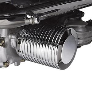

I wonder if one of those chrome oil filter covers would have made a difference with a chunk of asphalt....maybe.
Posts: 31102
« Reply #4 on: October 13, 2016, 08:54:12 PM »
It's not the chrome, it's the steel and aluminum (I have one of each).  I could easily stand on either, and think both would stand up to a chunk of asphalt.  They might get dinged up, but I doubt any damage to the filter underneath.  OK, they probably wouldn't stand up to a pistol or rifle shot.
Steel
Aluminum
Paper thin aluminum

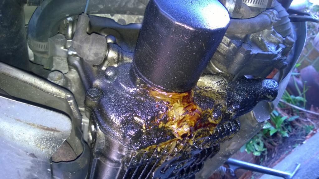

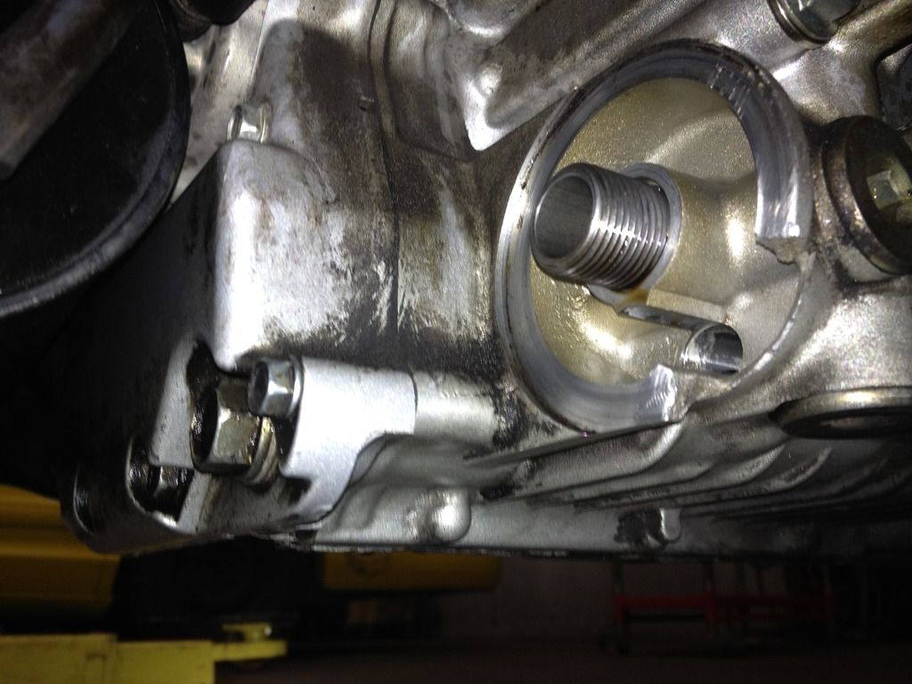

« Reply #21 on: October 23, 2016, 12:17:41 PM »
The GL1800 engine block, with the broken piece JB welded back in, as an on-the-road repair. Which didn't work, oil still leaked out.
Before
After

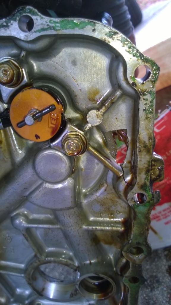

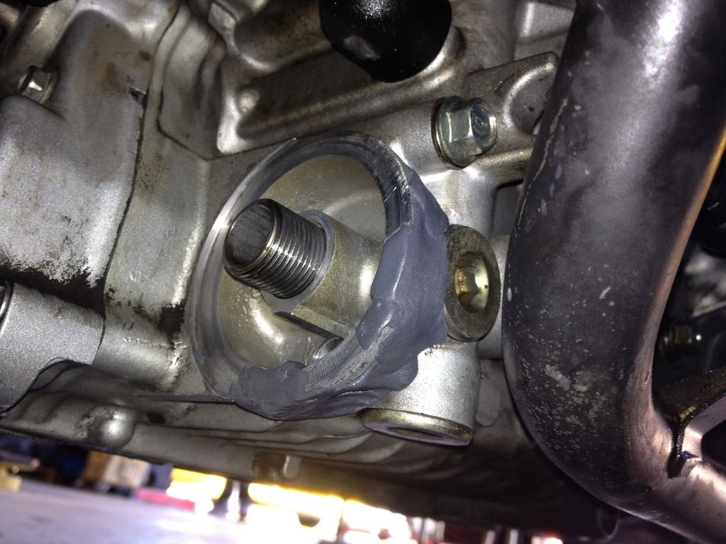

I bought a 93 really cheap almost two years ago that had road debris puncture the transmission cover next to the oil filter. It had some kind of epoxy gooped over the hole to slow the oil leak and looked like this:
GordonV sold me another cover that he harvested the gear indication switch from.
Here's what the hole looked like after I pulled the cover:
I never got to speak with the previous owner to get the story.
I'll bet that would have worked a little better if that surface had been smoothed out, maybe with a file??  I might have RTV-ed the filter seal to get me home.
