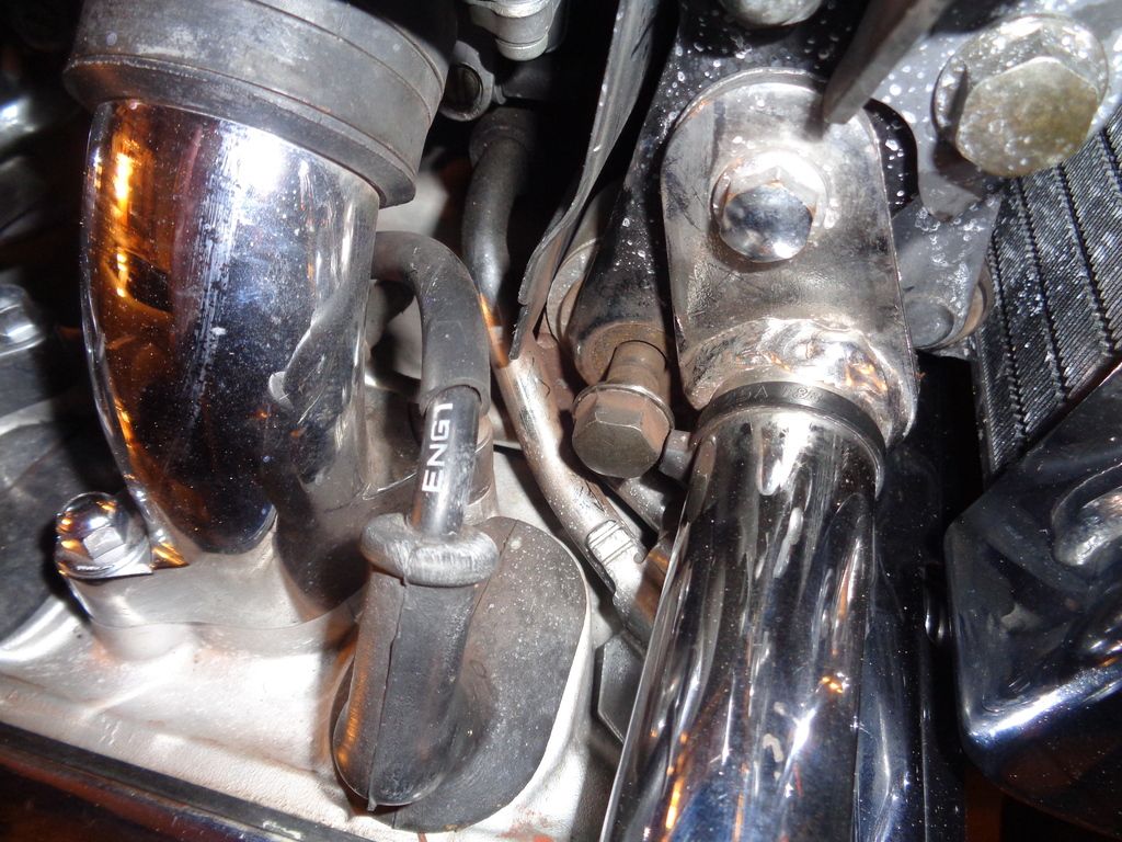

« Reply #2 on: November 26, 2016, 06:16:19 AM »
You can see the bolt in this picture pretty clearly, and the one
on the other side, too...

« Reply #4 on: November 26, 2016, 02:17:22 PM »
Thanks for posting that picture.  It lets me know what I'm dealing with.
The bolt slid out without jacking up the engine.  Now I just have to figure out the best way to access the back side of the mount,
The closeup view sure shows any dirt doesn't it?   My neighbors always comment on how clean and well kept the bike looks but then they just see a streak going by.
