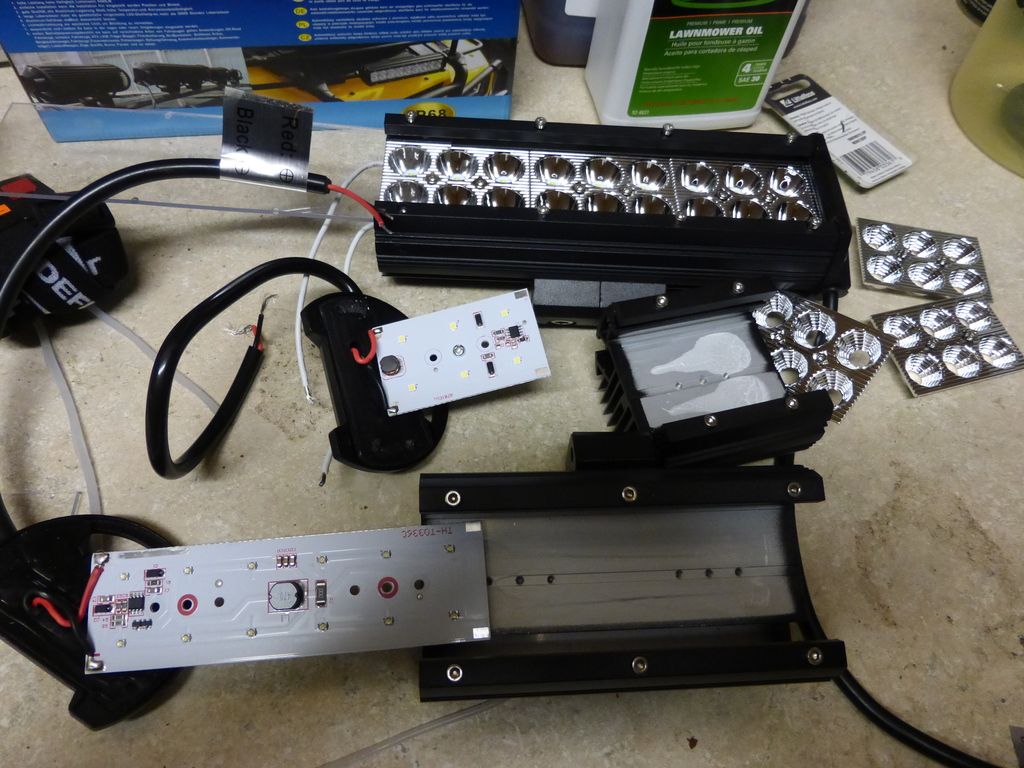

Here's what I am adding to the engine guards , one on each side .
Part turn signal and part head light .
https://www.amazon.com/gp/product/B00UK46YEM/ref=oh_aui_detailpage_o02_s00?ie=UTF8&psc=1
I am using Skene light   controller  to control  the head light and turn signal
They have some amazing safety effects built into the controller
Luckily , the turn signals work in unison with the OME  turn signals
http://www.skenedesign.com/lights/PB_Features.shtml
Does anyone know the  outside diameter of the engine guards ??
Thank you
« Last Edit: January 10, 2017, 08:47:09 PM by Kidd » Logged

I put a set of the smaller lights on my wife's last Can Am Spyder and they were pretty bright.  She got flashed by oncoming traffic all the time when she had them on and I had them pointed slightly towards the ground about 200 yards ahead of her.  The small ones are about 3"x3".
I am not sure how you would be able to use part of the lights as a signal without opening them up and rewiring.  There is only 2 wires that come out the back of them.
Kidd
Posts: 1159
Sedona
« Reply #9 on: January 11, 2017, 08:05:13 AM »
You are right , that's precisely what I did , I had to buy the smaller lights and harvest the led circuit board
to place into the larger one
http://i1067.photobucket.com/albums/u422/dromme2/P1010835_zpsldptwubp.jpg
