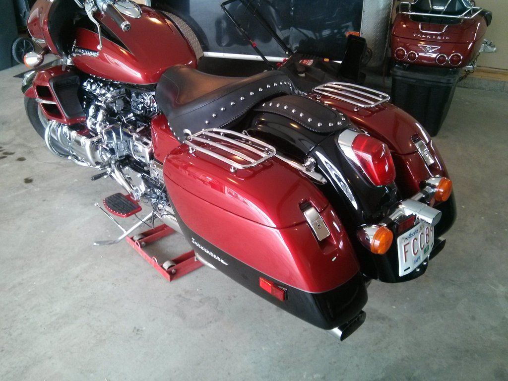

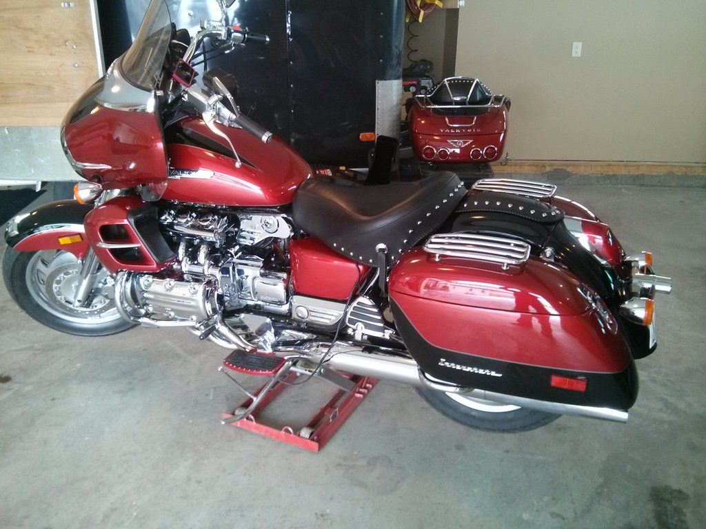

A while back I posted about doing the Super-Valk without cutting slots, but instead drilling out the studs and threading the holes instead.

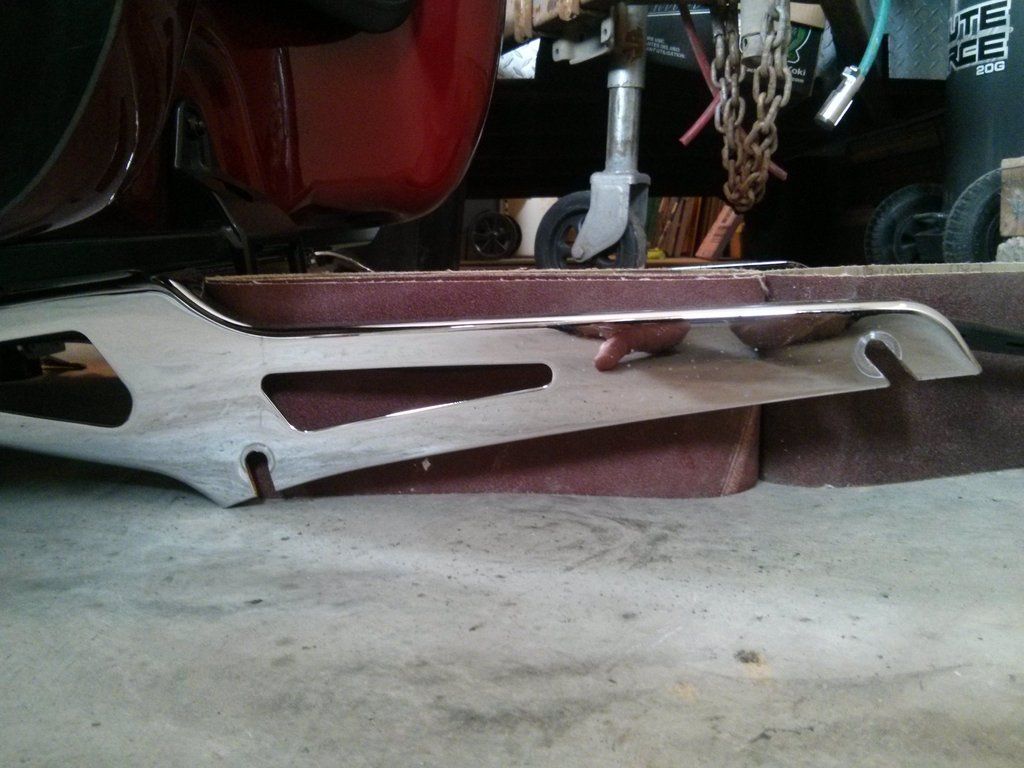

I must have looked at it fifty different ways...got out the cut-off saw installed a masonary blade and CUT THE SLOTS!
The front ones I cut at the same angle as the slope of the support brackets.
The rear ones were cut at 90 degrees to the bottom of the bracket.
My reasoning...if the fasteners ever came lose(which is highly unlikely) my top case was not going anywhere. I also relocated the radio antenna just under the seat next to where the tail light wire connector is located(for which I used a waterproof connector)
The guy I bought the bike from had already installed the tail light because he never rode with the top case mounted...his wiring was pretty sketchy so I rewired it and added a "Backoff" brake light flasher.
BTW...the Mustang Fender Bib...I tried to order on for the Valk and had much trouble finding one so I ordered one that was for the Vulcan 1600 Classic...It fit just fine after using velcro to fasten it at the front under the seat

Nice work partner.   cooldude
I had the luxury of buying mine, already done.
I cannot really explain it, the trunk (and all IS bodywork) is lightweight, and more of a sail than a weight problem, even loaded.  But I like riding my supervalk much more than my trunked interstate.  They are both '99 black interstates, both with identical length shocks, PS fork springs, same tires, and pretty much the same doodadery.
The supervalk at 98K, the trunk baby back at 57K.
And with the solo rack (supplemented with a 5/8 dowel ziptied across to keep a big duffel from rubbing my rack-less saddlebag paint, and give me easy access to bags while traveling), I can carry about the same amount of stuff as with the trunk bike.  (And if I load a big bag on my back seat of my trunk bike, I cannot open my trunk at all while traveling)
