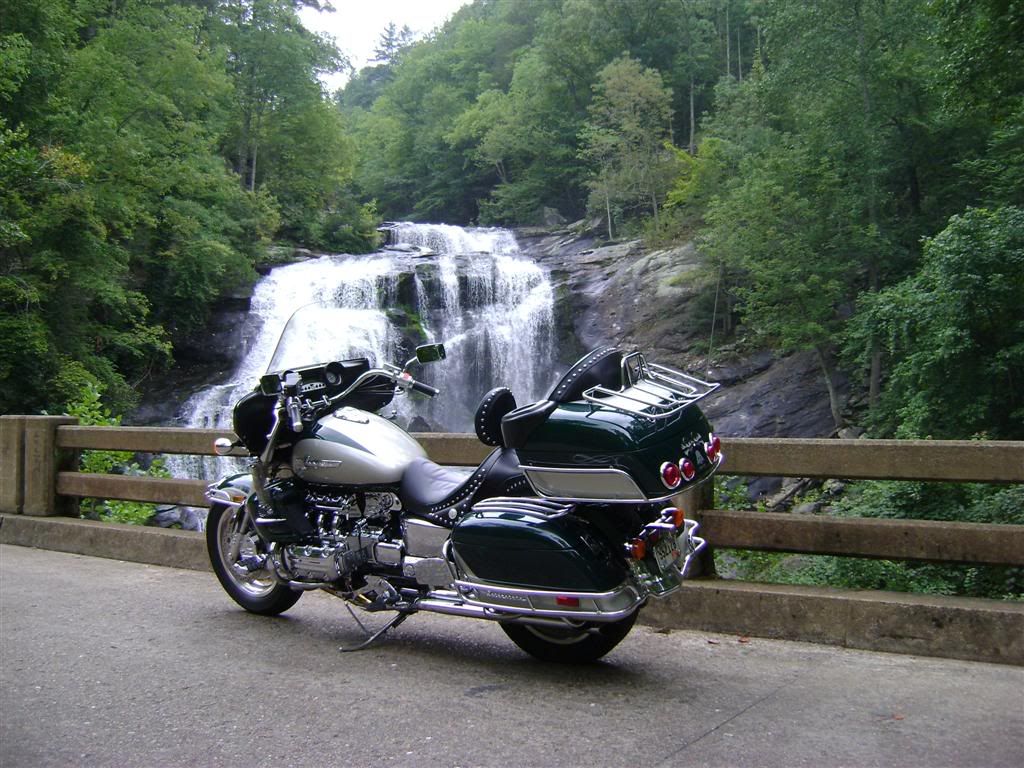

Willow....how tall is your windshield in the middle in this picture?  I've got an old OEM shield that I'm going to do that to and then tint.  Thanks!
Dave
Posts: 16826
« Reply #11 on: October 19, 2009, 04:15:43 PM »
I believe at that time it was eight inches above the garnish.  What works will depend not only on how tall you are, but how you sit in the saddle.
I used a very flexible antenna to define the arc and I actually cut it several times.  (Truthfully, I cut it once.  Mama cut it several times.  She has a very steady hand.)  It's easy to cut more off, but most difficult to put it back on.
Use plenty of blue masking tape and a good sharp metal cutting jigsaw blade.  Cut and ride; cut and ride.  After you're done you can use a fine file and/or sandpaper to bevel the edge.
