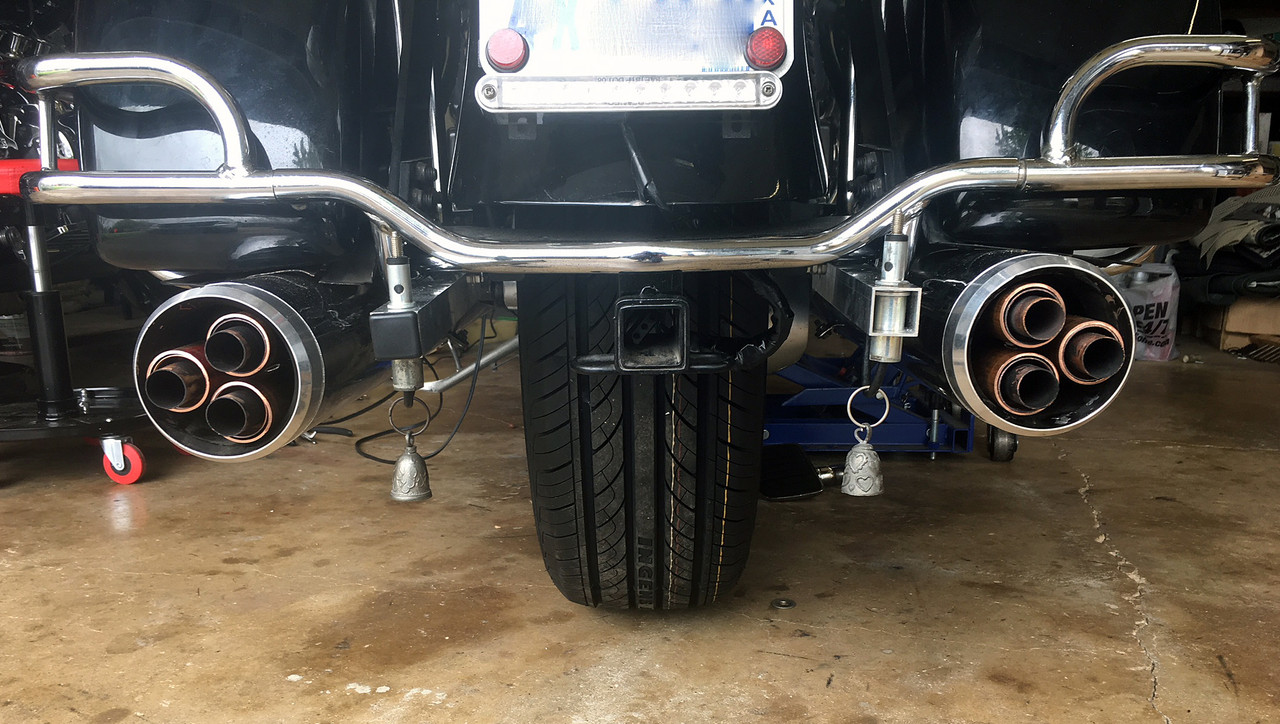

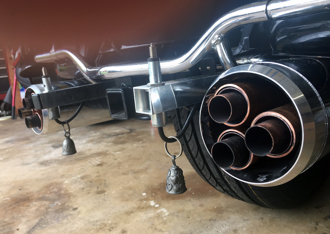

I just finished my stack/tip upgrade.  I used an idea I saw on here where a rider wanted to make his piggies smaller to get rid of drone, I did mine because I used 3/4'" copper and they just looked too small and didn't end up very symmetrical sticking out of the stacks.  This is 3/4" wrapped in 1 1/4" copper, very snug fit in the grumpy's and sticking outside of the stacks resulting in no drone.
This setup is quieter than stock, I plan on painting them black next time I'm working on her.

That is very nice work, and pretty awesome looking too.  cooldude
The bells are interesting, one hanging lower than the other.  Which reminds me..... (never mind)  Grin

They look like the business end of a A-10 Warthog. cooldude cooldude
« Reply #29 on: March 28, 2018, 07:05:27 PM »
2funny they do !
Thanks Jess
♪ ♫ Do your bells hang low, can you tie them in a bow.... ♫ ♪
There's a kit for that -
http://tailgunnerexhaust.com/?product=stealth-fighter
I'd bet it could be adapted to fit in a 4" truck stack.

« Reply #37 on: March 29, 2018, 12:13:56 PM »
Here is the finished product with the 18" Stacks and Grumpy's Drilled Tips.
https://www.facebook.com/photo.php?fbid=499035530494027&set=p.499035530494027&type=3&theater&ifg=1

Posts: 5196
« Reply #39 on: March 31, 2018, 11:34:08 AM »
Thanks Jess
