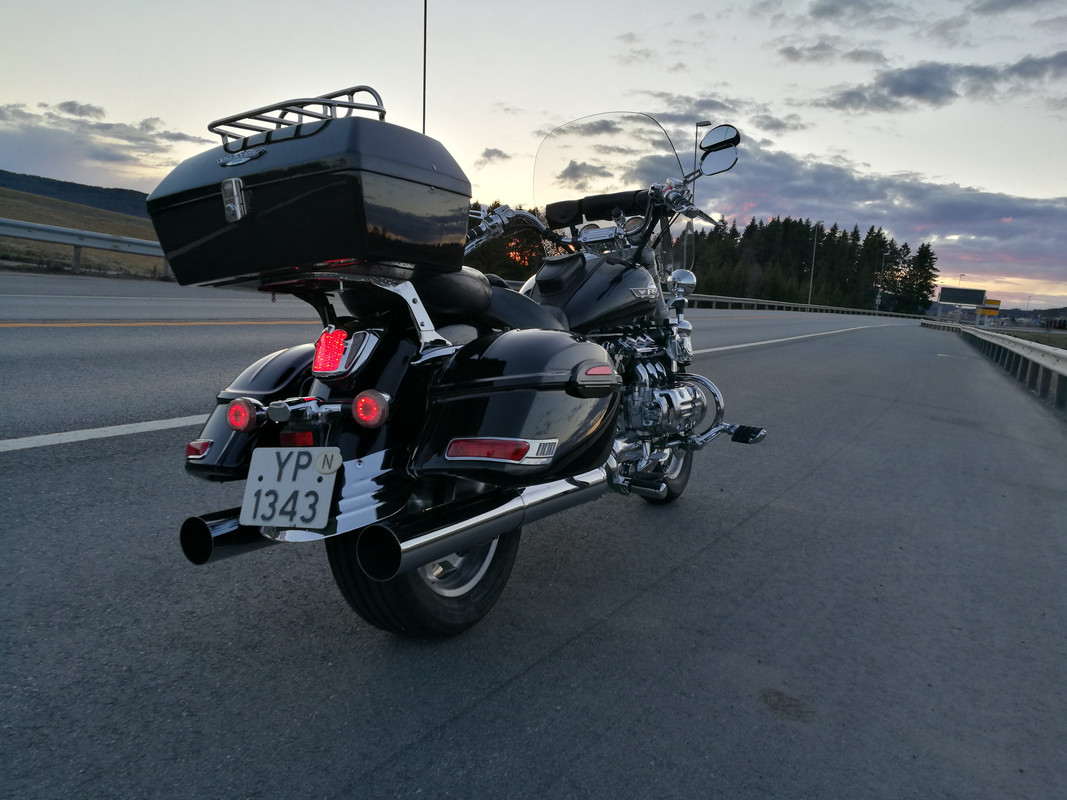

« Reply #43 on: April 17, 2018, 04:48:02 AM »
My stacks hs arrived!
Question:
They are very good looking, but one end is smoother than the other.
Not sure you can see it on the pic.  Is it risk for chrome problems or uneven joint to the exhaust?
Should the most smooth end turn backwards or forwards against the exhaust .
Is it anything smart to seal the end that meet the exhaust to avoid  rust or whatever?

« Reply #44 on: April 17, 2018, 05:35:00 AM »
Question:
Hmm, that does look faulty. Might want to consider returning that one. However if the uneven flaw is on the end that meets the middle part of the exhaust then it might not matter whereas that seam isn't too visible.
If the uneven flaw is at the outlet end of the exhaust and you are not going to install tips it might not matter either. However, if you are going to install tips, test fit the tips before you do anything to the exhaust to see if it's acceptable.
I'm long winded. In short. Test fit, test fit, test fit before you drill. If not happy return.

« Reply #45 on: April 17, 2018, 06:17:50 AM »
Not a perfect finish, but I suppose chroming the skinny flat-cut edges is not easy.
I have been running mine (on two bikes for 10+ years, with no tips), and the outside edges are a bit the worse for wear, with hot exhaust and carbon, and the bottom underneath edges have rubbed concrete departing aprons (business driveways to the roads).  I suppose it's possible if the less than perfect edge was mated to the pipes, that joint could rust a little over time (maybe a lot of time, or maybe never), with no good way to clean inside that joint short of yanking them off (they are a very snug fit, I put a soft board over mine and rapped them on with a rubber mallet, with a little bar soap lube).  Unless you are seeking perfection (and do a return), I think I would put the rough edge out, with the worst part to the bottom (which can/will get rubbed over time).  At least on the outside, you can keep after the edges and clean them up from time to time.
On the other hand, maybe I'm wrong on the rust thing, and the imperfect edge could be nicely hidden mated to the pipes.  Maybe the imperfect edge doesn't look great, but the protection is still enough to keep out any corrosion over time. My pipes have never shown any corrosion at all at the exhaust joint.
By the way, whenever parking, and backing down on curbs, you always need to watch that the curb isn't so tall, you will smack or drag your exhaust tip on one.  And I've cleared the curb with mine backing in, only to put the bike over on the kickstand, and then the left tip was laying on top the curb.  Of course, it is not necessary to have the rear tire ON the curb, but the bike is always more stable that way.

« Reply #49 on: April 21, 2018, 10:24:58 AM »
I am installing my new 4x18 stacks tonight, or more correctly, trying to install;)
They really are a tight fit !!!! I have grinded for hours now, by hand.
I just made some measurement, and it seems like outer diameter on thse stacks are like my original tips, but the wall thickness on the stacks is 2 mm, while the thickness on the original tips are 1,5 mm.
Sooo,,, looks like I have to grind down 0,5 mm all around Undecided
I could use a kinda grider machine, but I hate it if I touch the chrome with it.
Guess I am about to answere my question myself before I raise it. The solution will probably be to take the whole exhaust plant off and do it more controlled grindind with a grinding machine while the chrome is covered with rubber or someting...
Grindind down 0,5 mm  by hand sound like a challenge...or isn't it?
Posts: 31104
« Reply #50 on: April 21, 2018, 11:18:49 AM »
All I had to do was really scrub up the existing exhaust, wire brush going at old cooked on carbon.  Then rub bar soap on them for lube, then put a soft 2X4 of pine over the new stacks, and whack them on.  This did make it a bit difficult to line up my pre-drilled screw holes correctly, but I managed (twisting them with a soft strap wrench).
There was no dry fitting with this method.  They only got pounded on once.

« Reply #58 on: April 29, 2018, 10:56:50 AM »
Finally, stacks are on.
Took a while cause I choose to take the wheel off during installation.
And..then, why not a new tire, new bearings, new dampeners in the wheel  and the nut cage modification Wink
I had cut off piggies and drilles exhaust from before, and the new  4 x 18 stack hardly changed the sound, just a bit deeper sound, maybe. I am okay with  that.
I had to grind a bit to get the new stacks to fit. I asked supplier ( Air Flow) for exact measurements for "old" "valkyrie stacks" and this new Dyna Flex stacks I got from same supplier , but they had no exact measurements for me (??)
Anyway, new, cool look on my bike!!  cooldude
