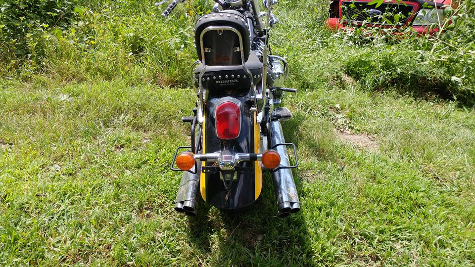

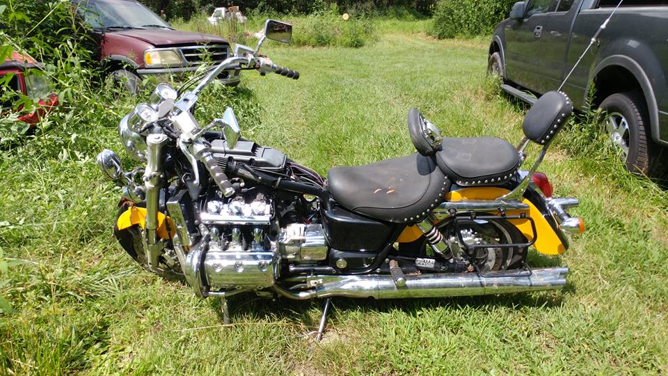

Posts: 13846
« Reply #18 on: April 18, 2018, 07:01:18 AM »
I wish I could find a decent set of stock pipes.  I bought mine with the 4 in inch pipes and Lord have mercy they are loud.
It's already been said but, those little exhaust studs are too small IMO.  Go easy on them.  Just enough torque is enough.  I think that nut is like a 10mm.
I've got several sets not sure of condition on this set and can't get down to inspect right now ( took a chainsaw to my knee ) but if they are good I'd trade for ( 3 ) brand new Avon front tires . If interested I can check them out when I can. The Hondaline triple tips on these was toast I've already removed them but I have perfect Tourer or Interstate tips .
These pictures was taken the day I bought this bike its been in the dry since this day.
