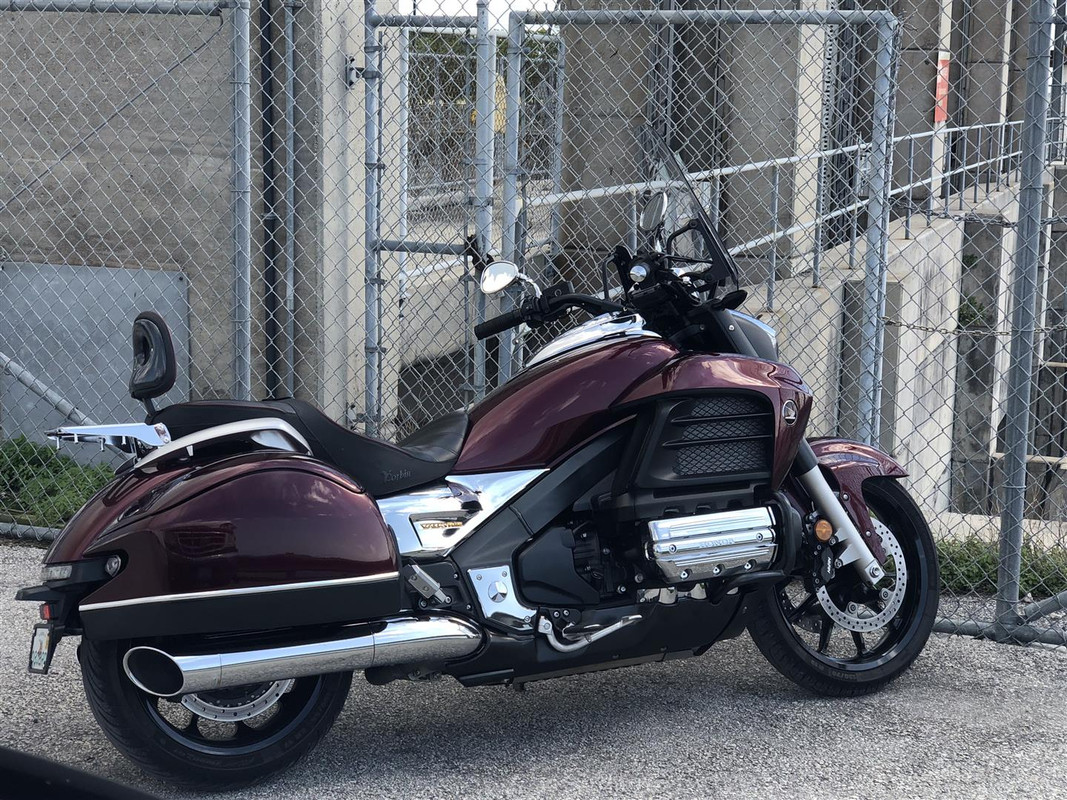

Ok.  After way too much research, I decided to go with this Avon set up.
A few reasons set me in this direction.  First, I ran Avons on my VTX 1800 with great success.  The handling was much improved.  They seem a bit more rounded than most other tires which allows them to fall/lean into the corners with ease. Also hold a line very well.  When researching the Michelin Road 4's which seems to be the replacement tire of choice, I was turned off by all the great wet water sipeing tech these tires have.
I would say that these are probably the best tires for riding in the rain which I try very hard to avoid and if I am caught in the rain I will usually find a hot cup of coffee and wait it out or proceed along very slowly. So this is not a big selling point for me. Also I have seen this front tire begin to cup after some miles and 38 psi.
believed due to the siping tech.  That and the fact I do not like the idea of putting on a "trial tire" on a performance oriented machine.
I called Michelin to find out what the difference between the pilot 4 and the Pilot 4 Trail was and they basically said one is for street and one is for trail/ street.  Well that was not what I was looking for.  The description tells you that much!
So when researching Avon I came upon the newer rear storm 3D XM (Xtra Milage)
Sport touring tire, with a 15K mileage warren-tee! and a limited road hazard warren-tee for less money than the Michies, I pulled the tiger on the Avons. Also in part due to the fact that I want this Bike to handle as well as possible as  per its intended deigned.
I installed the front tire after removing the oem Duncrap truck tire and installed the Avon Cobra 120/70ZR/19. (Denis Kirk, $130.00 delivered) Am holding back on the rear cause I have some trend to wear out on the oem first. Did somebody say burnout?
Anyway this combo meets and exceeds load and speeds ratings of the others.
And just installed the front.  I feel like I just bought a new Bike! I can't believe the difference in the handling, control and line holding this tire has over oem.
Had I known, I would have swapped it out day one of ownership.
By the way I also called Dunlop and told them how poor this tire preformed and they did not seemed surprised at all to here that...
My oem front is thrashed at 4K miles I ran 38 psi for 2K miles and 40psi for the 2nd 2K miles...One up riding 190 lbs. ck it out.
AVON Front profile mounted on Bike.

« Reply #1 on: April 22, 2018, 08:59:39 PM »
Good looking bike, and the tire looks great!
I too have just about 4000 miles on the stock front tire; might be able to eek another few hundred out of it, but I'm about 1/32" above the wear bars.  WTH?    tickedoff  I used to whine about only 10,000 from a front.   2funny
But... seriously?  At $2.75/gallon and 40 mpg that's about $0.07/mile for gasoline.
At about $200 for a duplicate 4000 mile replacement tire, that's about $0.05/mile.  We are paying almost as much for this tire as gasoline  uglystupid2.
Just put new tires on our Jeep Liberty.  $600 with a 50,000 mile service life.  I got right at 55,000 with at least 5000-10,000 more tread left on the stock Goodyears, but after a couple sidewall nails in the span of a few months I just replaced them all.  To save you the math, that is slightly over $0.01 per mile.  For a vehicle that weighs 3000 lbs.
I guess the 120/70-19 is about the only alternative, in the various manufacturer's lines.  But it sure seems ...odd... to be replacing the stock tire with one 3/8" (about 7.5%) less width.

Great looking I love the color  Wink and the reflective tape on the rims. Was thinking about doing that also and you just gave me a glimpse of how they look, thanks  cooldude Hope the tires work out well for you keep posting so we know. There have been others that have used the Avons and have written up a post here if you search you should be able to find them.

« Reply #4 on: April 23, 2018, 08:37:04 PM »
Robert, the Avon 130/60/19 being offered is a Bias Ply tire.
The 120/70/19 is a Radial tire.
The load range difference between the two is 16 lbs.
The Radial tire has a higher speed rating of 168mph vs 130mph of the bias ply .
it has been my experience that a radial tires handles better.
The Valkyrie oem are speced radials.
The 3d xm is not the exact match but is a radial of the same basic design and same manufacture.  So I guess I am betting that it will be a sweet match up.
I did put 100 miles of the front today and lets just say, you would have me kicking and screaming if anyone wanted to take that Avon away.  Can't speak to the handling of the Mich trail adventure tire. I suspect a heavier trail carcass may or may not affect handing.  The Michin man was no help.
Today while riding I could not get over how nicely the Bike effortlessly, almost intuitively, flowed into the turns. I can only imagine that with the 3d xm with the emphasis on sport, on the rear, things will only get better. (Load  805 pounds, Speed also 168mph) The front Dunlop always felt heavy and awkward even when new and much worse as seen in the pic.
As for the tire separation. i believe that was a bad run a while back in the Cobra Venom line which they have now dropped.
As for the pricing....I don't care. Not part of my discussion.  I just want the best handling tire I can get for the Valkyrie. As for the warren tee.  Tire warrentees are always hard to collect on, although I have. I just consider Avons warrentees to be a possible bonus.
2014 F6C Bordeaux Red Metallic
 2funny 2funny 2funny cooldude
Thanks for the answer and report. I hope they work well, I liked them on my 1500 and it would be nice it to have another tire to go to.

I don't see any tires in that pic!

« Reply #23 on: June 09, 2018, 08:53:18 AM »
Received the Rear Avon Storm 3D XM.  This is what it looks like in the 180.
Beefy looking and non inflated, slightly wider than the Dunflop hummer.
Got 5K on the oem and real close to the wear bars.
Won't be long till I mount the 3D XM..... Smiley

« Reply #25 on: June 20, 2018, 05:50:53 PM »
Ok, mounted the Avon rear 3D XM today and took it for a ride.
All I can say is that the it is heavenly.
It leans into the corners soooo nice, gradual and smooth through the lean.
Never did I feel the need to correct or lean more or less to get though the turns.
Almost completely intuitive as if it was going into the turns by itself an I was the observer, no exaggeration! Running 40 psi front and 42 psi rear.
Also noticed that it rode in a straight line (like on a rail) way better than my squared off mini car like tire that the Dunlop became.
With the 3 inch risers, the custom Corbin seat, windshield and now these Avon's, this bike is like riding on a cloud. Maybe too comfy.....
