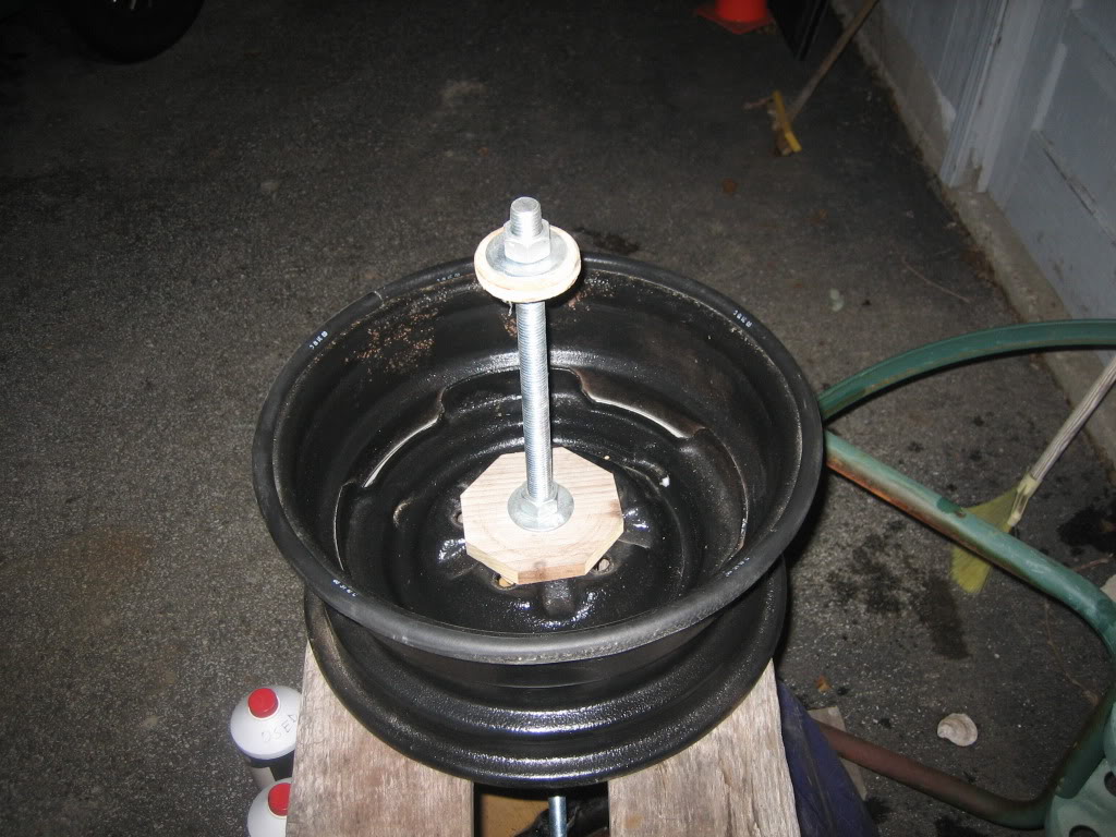

My homemade motorcycle tire changer. Used it two days ago to patch my rear tire.

I've noticed that Princess Auto now sells tire bead lube for $18 a 16 oz. bottle.
I made a bar that does the same job as the Mojolever, but in hindsight, I should have just bought one or something similar.
